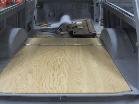

    We needed to do some woodwork today to get the rear seat/cargo area ready so we can bring in Howie, our upholsterer. Thanks again to HRP we figured out what the back of the cargo area should look like. When we got our car all this was gone. There's a plywood cover that covers the spare tire well, and extends forward to the back of the rear seat. We used 3/4 inch marine grade plywood. The area over the spare tire well is hinged for access. Here's a photo of that area in place
    The rear seat folds down to allow the floor to continue forward to the front. The seat bottom folds up against the front seats, and the back folds down to extend the floor.
    The stock seat back was designed to fit around the original wheel wells. As you may recall, those no longer exist. so we have to modify the seat back to fit the new bigass fenderwells. The gentle gurve is now a right angle at the fenderwell so a new seatback was fabricated. Here you can see the right angle notch above the routed hinge recess
    Here's a photo of the old and new in one shot.
    Finally a picture of the seat back in the up position.
    and one in the down position. There's enough room in the back with the seat down for two people to actually sleep comfortably back here!
