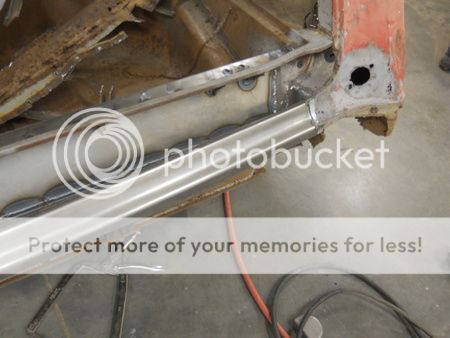

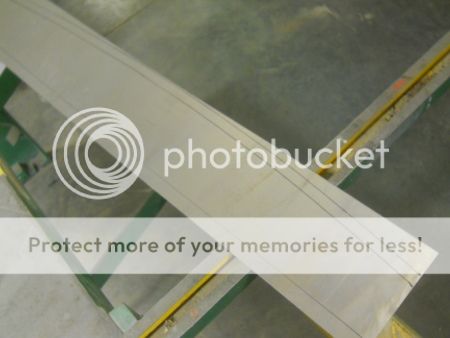

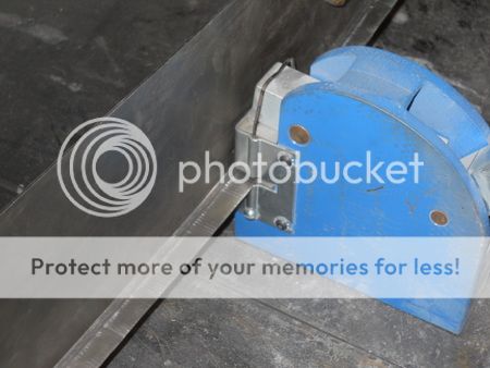

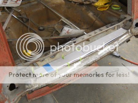

    OK, Here's today's effort. We started to build the interior bottom pan.
    Drew it out on a sheet of 18 gage.

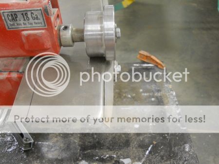

    It needs a 90 degree bend along the CURVED side. First we rolled it in the bead roller to form a bend line.
    Then we had to run it through the shrinker till the sheet top was once again flat. This really worked well.
    Then we used a brake on the back straight side and bent a welding tab. Here's a picture of a ***** welding it in place.
    This all came out well and was easier than we expected.
    Now for the hard part.... The exterior sheet metal that is bent on a reverse curve!
    We thought that we could bend it out as a straight piece and then maybe curve it by shrinking the welding tabs. Here's a look at how far we got today. We are gonna have to re-make this piece and bend it a bit further, but the approach seems as though it will work....
    We learned a lot by screwing up this piece, but that's what its all about, right?
    If it was easy the girl scouts would do this ****....

    I'm impressed,I especially like the idea of using the bead roller before shrinking,,I wouldn't have thought of that although I'm sure I would have worked harder instead of smarter!;)
    I never took any photos of our mistakes but I can ***ure you guys there were plenty of half done s****s of sheet metal ****tered around.
    You guys are doing a beautiful job! HRP

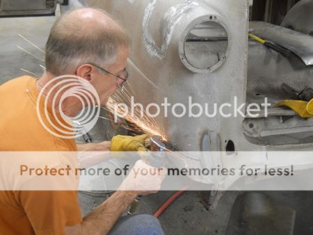

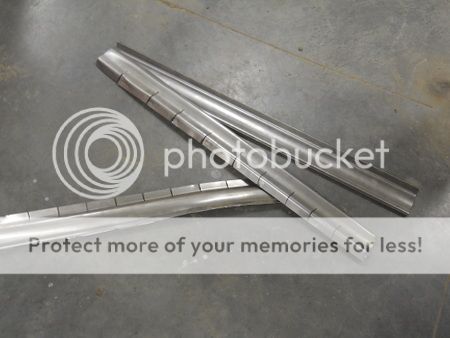

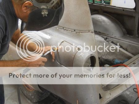

    We knew today that we would face the hardest panel to re-create. It has a hollow, and 2 long curves one horizontal, and one vertical. Last week we screwed up our first attempt. Today we screwed up the second, third and fourth.
    We could bend it with the shrinker in one plane, but we had to make relief cuts in it so it could bend in the other two. We did finally on the fifth attempt get an acceptable fit.
    Here's Steve grinding down the last of the welds that I laid in the relief cuts. It really doesn't look too shabby. It'll need some primer and glaze but its real close.
    Here's a photo of the old rotted one next to the new. It took the two of us about 4 hours to do this, but we were satisfied that it happened at ALL!! Next week we should be done back here and can move on to another needy area.

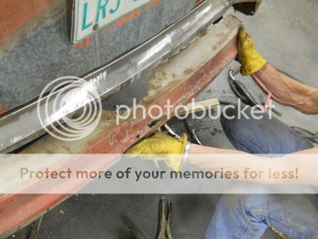

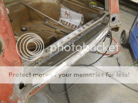

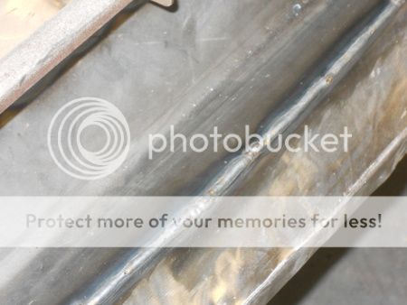

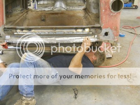

    Today was our last day on the rear tailgate area of this ******. The top piece was all that was left. Steve made a pattern and we bent and taped it to the rear to make sure the tailgate would clear. It did.
    We transferred the pattern to metal and welded it into place
    It welded nicely, so not a lot of finessing was necessary.
    At this point all the major structural rust is repaired. Its time to strip this baby of everything and take it to the sandblaster. I'm not the glutton for punishment that HRP is so we're hiring this done. When it comes to sandblasting I cant get the checkbook out fast enough. We pulled the dash, windshield and all the door innards out so that the blaster can get to everything.
    We still have a bit to strip out so we'll do that next week. It'll be cool to have a clean carc*** to work on.

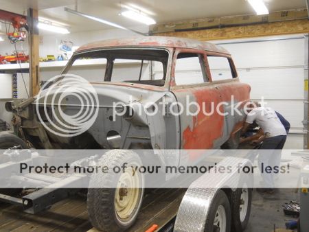

    Today was spent getting the car ready to take to the sandblaster. We stripped out EVERYTHING! Dana cut out the areas where we knew we would have to add patch panels on the body .. Here he is making the cut along the bottom right rear.
    When it comes back we'll have to repair both the inner and outer panels, but considering all the major work we've already done this will be a relative piece of cake.
    We stripped out the door and window mechanisms for re-build and cleaning, and swept out and vacuumed everything. I pulled the gas tank and set it aside.Still about 2 gallons of 15 year old putrid gas in it.
    Then we loaded it onto the trailer... First thing in the morning this baby is off to the blaster. It'll be nice to have a clean car to work on!

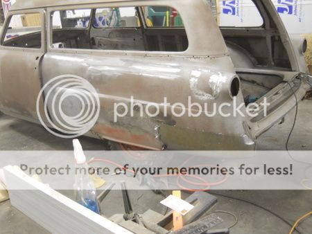

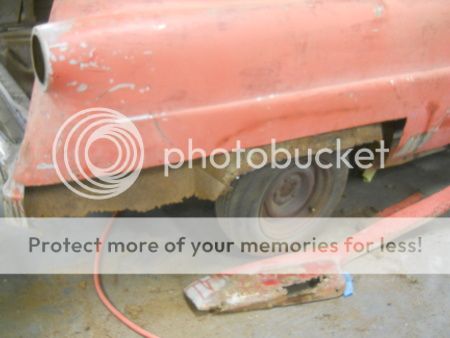

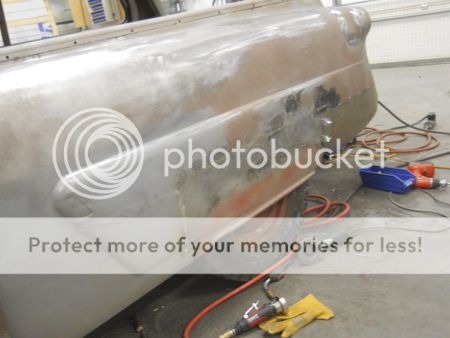

    Today was a lot of fun. The wagon was back from the sandblaster, and we began work on the left rear quarter. The gas filler door is right in the way of where one of the wood slats will be when we "woodieize" this thing , so the door had to be welded shut and filled. Here it is in the welding stage.
    I'm not a fan of the "laying frame" school of thought, but I like a car to look tastefully lowered. There are more ways to do this than hacking up the frame and C notching it.
    In our case I decided to actually blend a set of fender skirts INTO the rear quarters. This gives the car a lower appearance without chopping up the rear frame.
    Here's a look at that process. Not everyone's cup of tea, but mine for sure. I love the look.
    Finally we cut the rear for the new patch panel that goes from the wheel to the back
    tail
    [​IMG].
    We screwed this temporarily into place so we could match up a new inner fender panel to it. Heres a look at the basic modified rear quarter.... There's still lots of straightening and body work left to do here, but you can easily see what the panel will look like in final form.
    Kind of a Brooks Stephens or Buck Rogers appearance!
