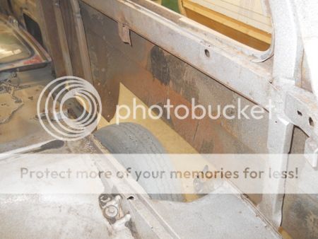

    We had the driver side inner and outer rear quarter on our agenda today. Here's Steve cutting out the rusted area of the inner panel. Seems like this **** never ends!
    We handmade a new inner panel and it fit perfectly.. Couldn't believe it ourselves...
    The outer panel was welded in, but as expected it caused a fair amount of warpage... We spent the rest of the day shrinking and stretching the panel into shape.
    Finally, while I was welding, Steve and Dana removed the inner fenderwells. We are going to re-do these to get more room for removing the rear tires now that the skirts are integral with the fenders. With a little luck and some bondo and primer, this rear quarter should be looking good next week.

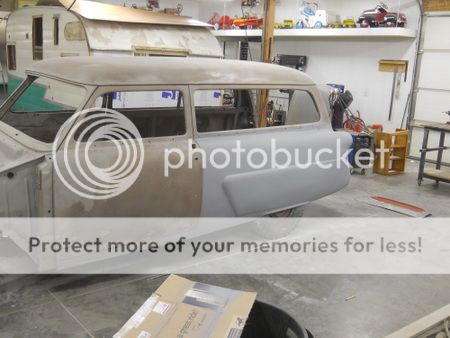

    Its been a really cold week up here in Montana. The temps haven't been above zero in many days. When It's like this I don't spend my time working outdoors on the properties like ususal. I had time during the week to work on the Ranchwagon, and that was a real treat. First I hammered on the rear quarter to get it in shape for filling, and then I filled and smoothed it out. Here's the result. I'm crazy happy with the look.
    Next I welded and smoothed the skirt onto the patch panel for the other side. I did the first side on the car. In retrospect, what a dumb*** move that was. It's sooooo much easier on the bench.
    Then we went to work fitting the panels onto the rider side.
    Here's the new inner panel being welded in place. I figure when we are done the entire lowest foot of this vehicle as well as the floors will be new metal.
    Here's as far as we got today before the cutting wheel ****ped out on us.... All in all ..a good week

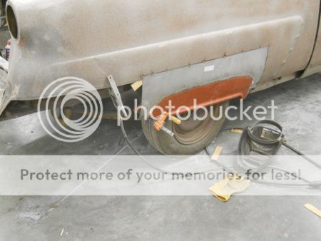

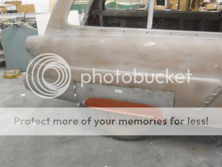

    We were down one worker today, but still got a fair amount completed.. [​IMG]
    All the patch panels are now installed on the right rear quarter. Surplus supply makes a panel for behind the left door, but not the right... Go figure. so when things like this occur, you just have to manufacture your own. We did OK at that.
    We also took the time to re-do the right rocker panel and move it inboard just a bit so it would align perfectly with the closed door. It was probably acceptable, but it wasn't quite right, and I'd hate myself everytime I looked at it. The time to fix it was now. So we did.
