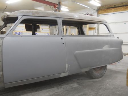

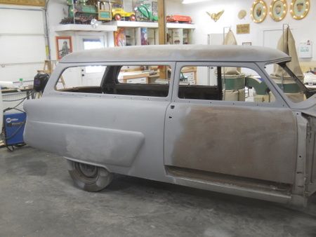

    Danny, here's about the best I can get right now.. The rust repair hasn't been made to the bottom of the door, and the door could use some primer. I hope you can get a pretty good idea from this picture

    We did work yesterday, and then I watched the Super Bowl.. Turns out that what they told me was exactly wrong. The best OFFENSE is a good DEFENSE... not the other way around that I was taught...Go figgure!

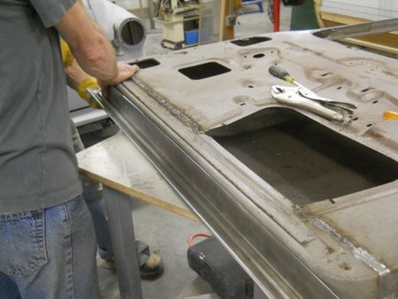

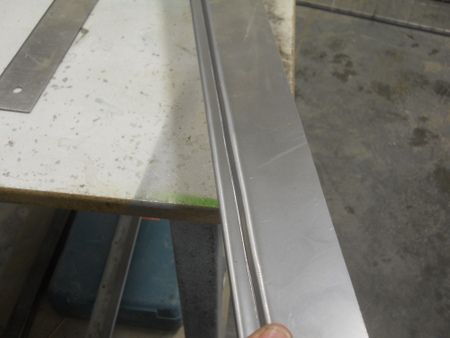

    Yesterday we worked on door bottoms. The first part was to cut out all the rusty ****. Our inner AND outer door bottoms were a rusty mess, so off they came.
    We then replicated the weatherstrip mount by p***ing some 20 gage through the bead roller.
    A 90 degree bend was then bent, and the inner panel replacement was complete. We decided to place the outer skin FIRST, and then slip the inner panel in place. This way we would have a perfect gap on the door fit in the opening. We re fitted the door onto the car for this to get it just right. Here it is spot welded into position.
    Then the inner door panel was slipped into position and spotted.
    That's as far as we got yesterday, but the weather is super cold outside right now (-11 degrees and falling) so I'm just going to stay in the shop and spend my MONDAY working on finishing out this door.

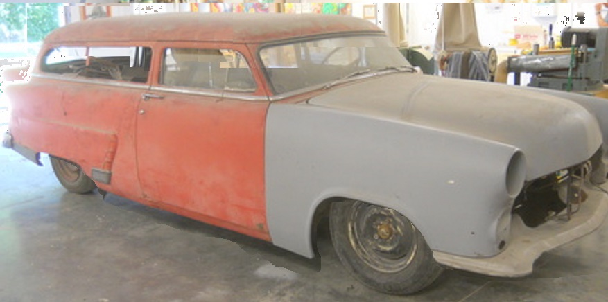

    I actually started this project over 10 years ago. the part that looks like lead is a small area I tried sandblasting with my own blaster. I took it to a pro blaster this year and he used a much co****r grit on the rest of the car.. That's what you see everywhere else. I did hit some lead on the rear fenders. Its kinda a surprise when you first hit it. In this day and age we always think "bondo" , not lead.

    Naw, the wagon wont be dropped...I've always hated the "laying Frame" look on cars....The chop is real minor. Almost everyone who walks into the shop has no idea the wagon has been chopped at all.
    Most the body mods even though pretty extensive go un-noticed. The tunneled antenna will probably give it away more than anything else. It'll probably be the only 53 ranchwagon true woodie in existence, but most folks wont know that either. Fine by me!

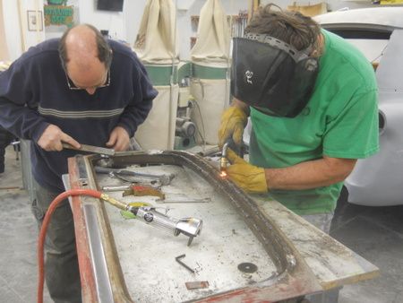

    The rear tailgate window was todays chore. It of course also has to be chopped, but there's no cutting rear gl***.. It was pretty easy to chop the frame,
    but the gl*** was another matter. There's not much room around the gl***, so we had to recess the gl*** into the top of the frame. No matter how hard we tried, we were 5/8 inch short. Time to start cutting things up.
    We cut out the window channel, and then removed the 5/8 from the top rail. Its a good thing we didn't need any more, cause that's all there was without drastically altering the interior metal.
    It took two full length welds and a LOT of grinding to move the window channel up .
    Here it is all smoothed out. It really worked well, and now the rear end is also chopped, and we're sure to have nice gl*** all around.

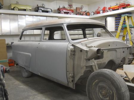

    OK, we did make some headway... The rear pan and the tailgate had slightly different arcs to them. We had two choices. Make the pan fit the tailgate, or make the tailgate fit the pan. Since the pan was such a ******, we decided to change the arc of the tailgate.
    We cut a slice out of the inner panel, shrunk the sheetmetal on the gate with a shrinking disc, and then welded back the seam. It sounds easy when you talk about it, but it took HOURS!
    Here's a photo of it after it was welded and ground.
    I finished the lower patch on the door, and we re-installed it on the car. While doing that we broke a tap off in the mounting plate. Removing that took another hour. BUT, the door fit nicely. Here's a pic of that side of the car. We also moved the wagon to another area of the shop where it now sits under the shop hoist. Next week we hope to figure out the mounts for the 289 that is going in and we can move it easily with the hoist.
    Here's a picture of the hoist and beam. I moved these over from my old shop. I'm in love with this thing, Its on a 20 foot beam and it has saved my old back a hundred times.
    Dana sanded down the whole roof . It took a considerable amount of time as this thing has a considerable amount of roof. Only found about 3 small dents. I'll try to get to those this week.

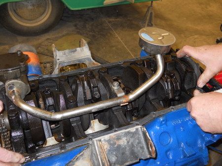

    We pulled a valve cover today and the top half of the engine didn't look nearly as nice as the bottom end
    It looks like some moisture found its way in there while the engine was in storage. Dana an I spent a long while cleaning it up, and it looked alright after we were done... We'll see.
    We attached the new rear sump pan on the engine, and tried to find a way to fit it on the existing clip. We dummied up a pair of mounts out of 3 1/2 square tube to get everything in place ( we can make some fancy ones next week.)
    The gap in the new pan JUST cleared the crossmember and Rack and pinion steering. What a relief. The ****** looks like it'll fit nicely (famous last words.)

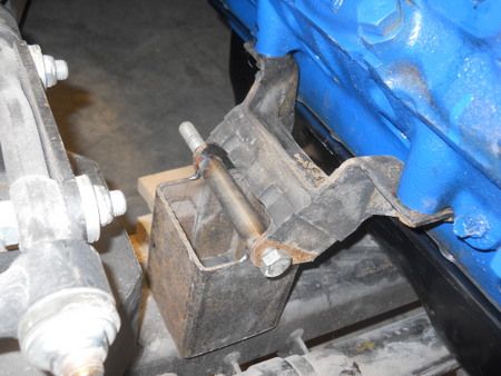

    We were back at work mounting the engine and ****** today. We figured out some engine mounts that would work for us. The doorway is to provide clearance for the steering.
    Here they are welded in place.

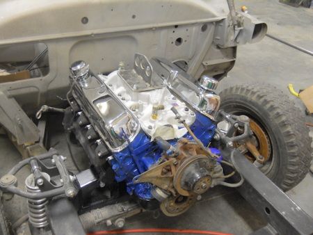

    We cleaned up the engine, added chrome valve covers, an edelbrock manifold, and put on the rear sump pan. Here we are moving the oil pickup.
    Finally, the 289 in place.
    This thing is really gonna happen!
