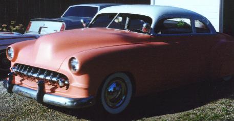

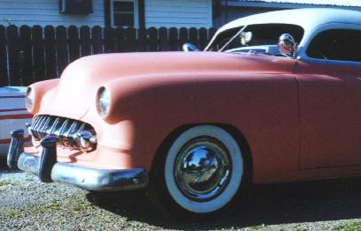

  6. Ron
    Posts: 1,225
    Ron
    Here is one I done a few years ago.
  7. jetcitysicko
    Joined: Feb 12, 2004
    Posts: 211
    jetcitysicko
    Ron, Thats the shit man. I was even thinking about a vette grill. Don't really have access to a tig. Did you have to cut the top and bottom piece down?

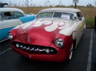

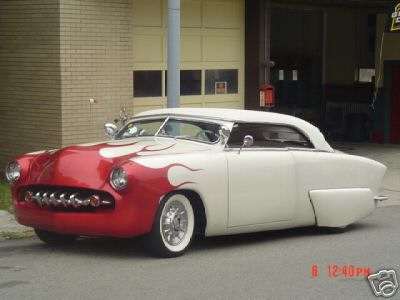

  8. CHOPMERC
    Joined: May 11, 2001
    Posts: 992
    CHOPMERC
    heres mine, a much modified 53 opening......
  9. Ron
    Posts: 1,225
    Ron
    I used a mig, I did not cut down the top or bottom. I cut away the ribbed areas, had to v cut the spears to bend them around the fenders, make panels the replace the ribbed areas, and reshape the front of the hood.
