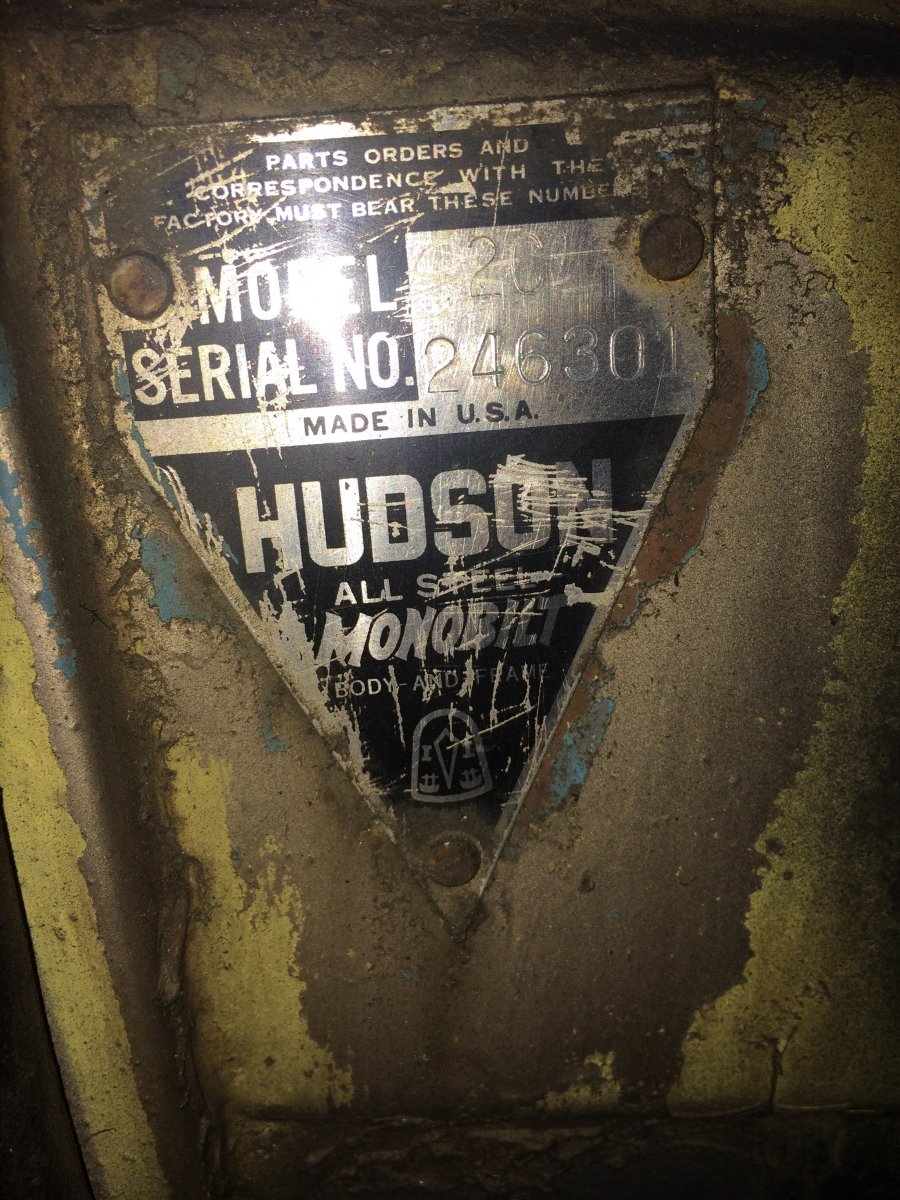

  14. So I've been looking around and I'm having a hard time distinguishing a jet vs super jet. Any info?

  26. d2_willys
    Joined: Sep 8, 2007
    Posts: 4,344
    d2_willys
    from Kansas
    I posted the info for Jet vs. Superjet.
  27. d2_willys
    Joined: Sep 8, 2007
    Posts: 4,344
    d2_willys
    from Kansas
    Some of the stainless is not there on Jets. I also think the front wings were not on the Jets.
