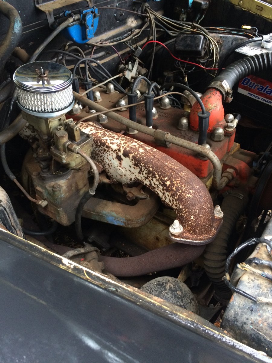

  2. So I pulled the gen last night and took a little saw blade like I was advised and cut into the notches on the copper plates that the brushes ride on the commutator?? Still working on terminology. Then took oooo steel wool to the copper and got it to a nice bright finish, threw it all back together and in the car.
    Now my question is where do I stick the voltmeter to test its ouput? I've been poking all over the place and all my readings are like 6v at 2k. Amp meter is showing just a little before 12 o'clock so maybe a hot lead has run to ground and shedding some power?
    Any thoughts would be amazing!
  3. loudbang
    Posts: 40,348
    Right at the battery posts is a good place then you are testing the whole system. MAKE SURE to get the polarity of your meter leads correct way around. Neg black to neg post, Red to pos post.
    I don't know specifically for your Hudson but on SOME old makes you have to "Flash the coils" (google it) to get a taken apart generator to generate.

    Also known as polarizing the generator, often necessary after having one apart but not always.

    Uh, if stock your car is 6 volt and Positive, not negative ground. Don't cross polarities or you will burn out the regulator

  7. So I got a better voltmeter and it's showing 7 volts coming out of the generator so I think I polarized it properly!

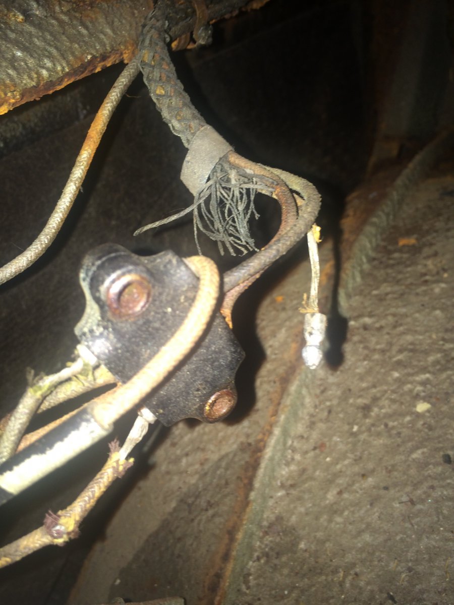

    So I've also been rebuilding sections of the harness as I go along. The cloth wire is really frayed in some areas and I worry about arcing and burning the car down as well as having shorts
    I got a lead on some bullet connectors from ynz for .30 and they have cloth wire so now I'm not sure if I should redo what I've done so far in cloth or just keep the modern jacketed wire. Would it affect the value of the car?

    My car is getting all new wire too. But I would rather wire it with modern wire than use that old style stuff. Most of the wire will be covered, be it electrical tape or convoluted tubing, so I really would rather have reliability, than oem appearance. If you restore it to concours condition, then use the old style stuff. YnZ is good for all the old components. Also, your car probably does not have turn signals, so you will need to add wires to the front parking lights. The back stop lights are already separated for turn signals.

    I just put signal lights on the 51 HenryJ and when I was working on the cloth wires they were falling apart inside the sockets etc. I used some old dual wire socket inserts and bought one to finish up. Quite a bit of the insulation is failing so I will start to replace it. The car came with the same ****on connectors.

  15. Yeah theyre super brittle! And then when I cut the plastic wrap around the looms the wires look like new.
