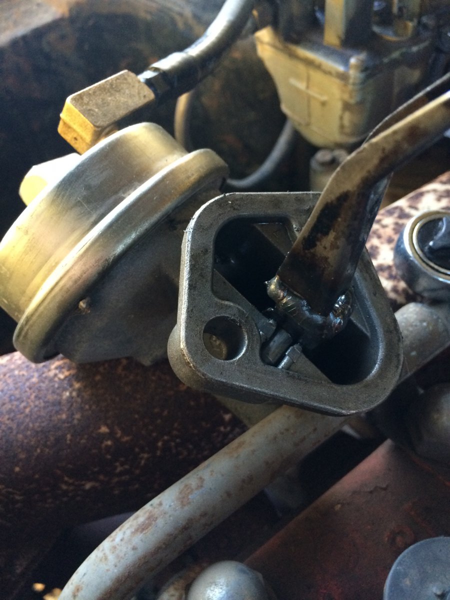

    Discovered this today. Super custom fuel pump arm...welds are actually pretty good with no heat wearpage on the arm. And if you're thinking it looks a lot like a sbc fuel pump you're right. The mounting flange on the block matches too so I'm a little puzzled but I got a new gasket for it and I'll just throw it back in tomorrow

  13. Good call. ;)

  15. It certainly is pretty quick, hopefully quicker without a clogged up filter!

    henry's57bbwagon
    My HenryJ uses a Chevy gasket as well.

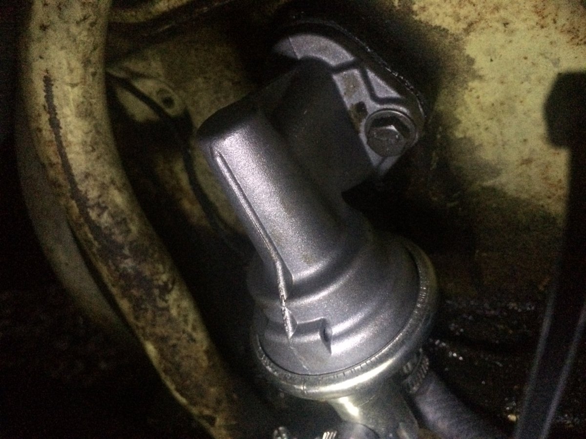

  19. Any of you guys ever have trouble with installing a mechanical fuel pump? I've tried putting mine back on and it's just not pumping. I've pressurized the tank, primed the lines and even played with the cam position before installing it
    Ended up having to get a new pump as the previous one was shot but oddly enough a ford pinto pump fits just right

    Hmmm, Going to have to add the Pinto fuel pump to the parts cross reference sheet. Was it from a 4 cylinder or 6 cylinder Pinto?

  24. I think it was from the 2.3 4 cylinder, not a hundred percent sure. And there's a 202 aluminum head on eBay right now I thought of getting but it might end up doing more harm than good
