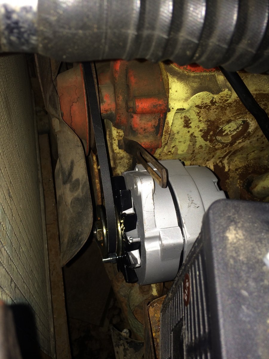

    So I got my 6v alternator the other day and finally got around to putting it in and getting a bigger belt. I'm gonna have to make a different upper bracket as the oem one doesn't fit

  6. jhexide
    Joined: Feb 23, 2012
    Posts: 334
    jhexide
    looks like you can move the bracket to the bolt above the one its on now
  7. d2_willys
    Joined: Sep 8, 2007
    Posts: 4,344
    d2_willys
    from Kansas
    Bolt size is larger, would have to drill out the hole in the existing bracket.
  8. Quick solution turned out to be flipping the bracket and adding a quarter inch spacer and running the bolt through the front

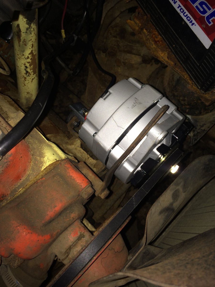

  9. So took the car out and drove through town and on the freeway for an hour or so and came to a light and it just died in the intersection. So while waiting for aaa I pulled the carb off. I noticed when I tried figuring it out in the intersection gas was leaking from the a couple gasket spots and was dripping gas even when it had no throttle. Took 5 shop towels to soak up the gas in my intake manifold. Needless to say it looks like time for a rebuild and maybe a fuel pressure regulator image.jpg
  10. Stuck float? Smacking it with a wrench, while feathering the gas j while it's running usually sorts it out temporarily.
