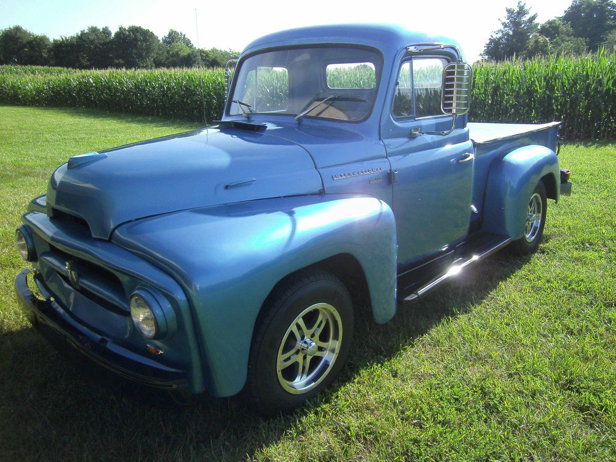

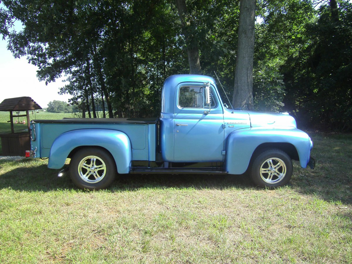

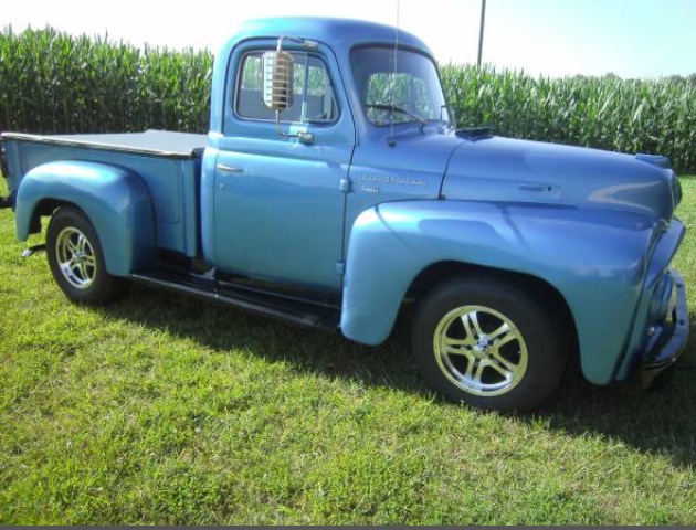

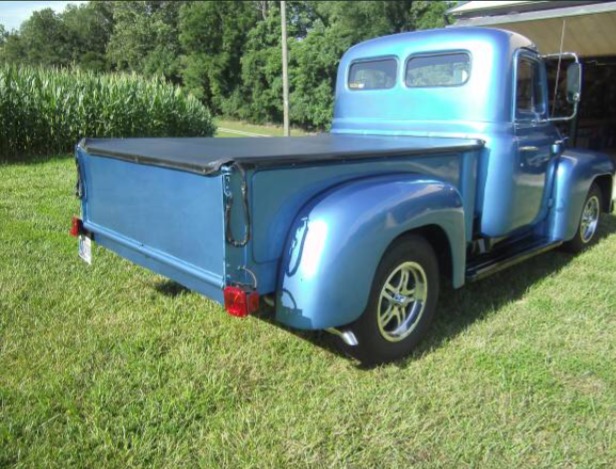

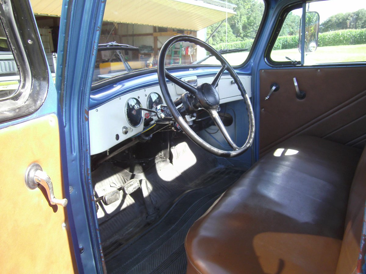

    Hey everyone,
    New to the forum. I've always wanted a 50's pickup and finally grabbed one. A '53 R110. It is mostly stock/original except for the wheels/tires, paint, tonneau cover, 12 volt conversion, and a tape deck. I'd like to be able to drive it anywhere...safely. Being that it's low geared, no power steering or brakes...I am debating whether or not to re-gear/swap the rear end and do a brake conversion...or dive all in and do a frame/engine/trans swap.
    Any advice or suggestions for a guy new to the old truck scene?
    Thanks much in advance!

    leave it alone ,put an overdrive trans in if rear axle ratio is a problem, brakes are ok if you learn to drive with drum brakes, lots of hot rod trucks out there, keep it basically original,be different

    That said with the stock rear gears it is a good candidate for an OD, especially with the smaller diameter modern tires.
    Unless you are road racing the original brakes in good working order will stop it just find.

    I would like to keep it as stock as possible...just want to be able to cruise on the highway at more than 40-45 mph.

  8. The trucks stock cruised @55-60. your tires are a little on the short side compared to stock tires which will effect your overall top end. But you should still be able to get on down the road.
    One thing to remember is that these old heaps often sound like they are really working because we are used to driving cars that run at low RPM most of the time and are a lot quieter that the older cars and trucks.

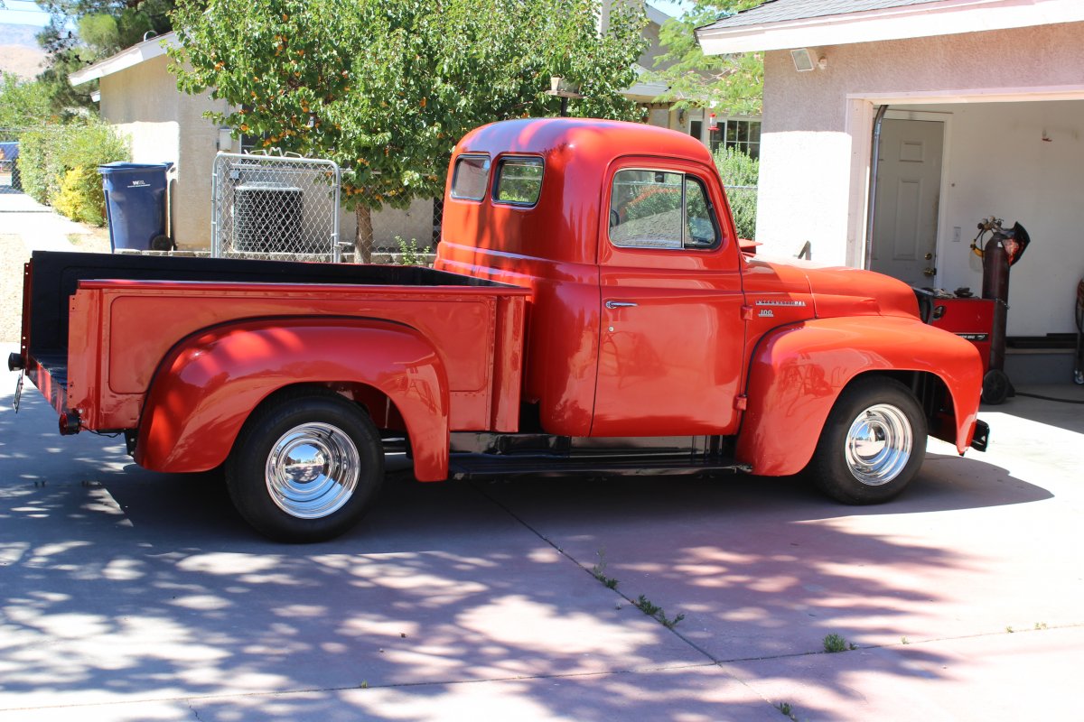

    Nice looking International. I have owned a few Internationals over the last few years and currently drive a '54' R100 as pretty much my daily driver. Mine has a mid-60's straight six (has about 20 more horsepower than the stock Silver Diamond), 3 speed and a Ford 9" with 3:50 type gears. It will cruise around town with no problems and on the freeway in the slow lane. Your options are pretty limited for a higher cruising speed (while keeping it pretty much stock), there are overdrive transmissions made for the these trucks but are rare and pricey. The easiest way would be to bolt in a better geared rear end. Ford explorer rear ends are most commonly used. Go to the oldihc.com site and do a search and you will find lots of information on swapping the rear end. I put a dual reservoir master cylinder on my truck, but it still has drums all the way around. They work fine with the power involved in these old trucks. Here's a picture of mine, front axle dropped by Sid's. Dirtcop IMG_0210.JPG
