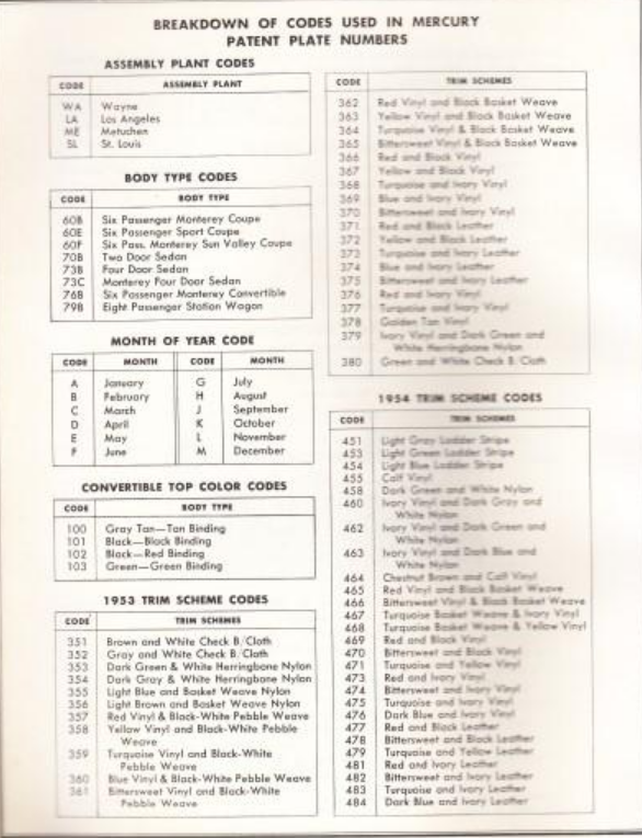

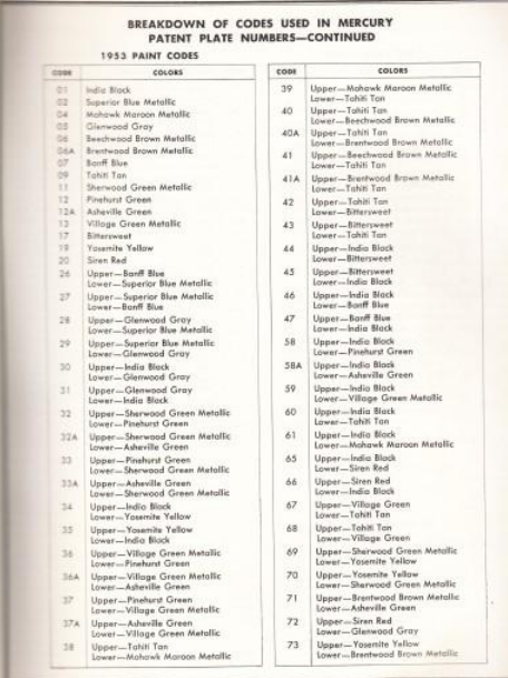

  6. VIN # translates into 1953, built at the Metuchen Plant, and the 75,014th 1953 Mercury built.
    BG60B= 6 p***enger Monterey Coupe
    32A= Sherwood Green Metallic over Asheville Green
    368= Turquoise and Ivory Vinyl
    11M= built on December 11th
    274= rotation number (274th car built with that color in that cycle)
