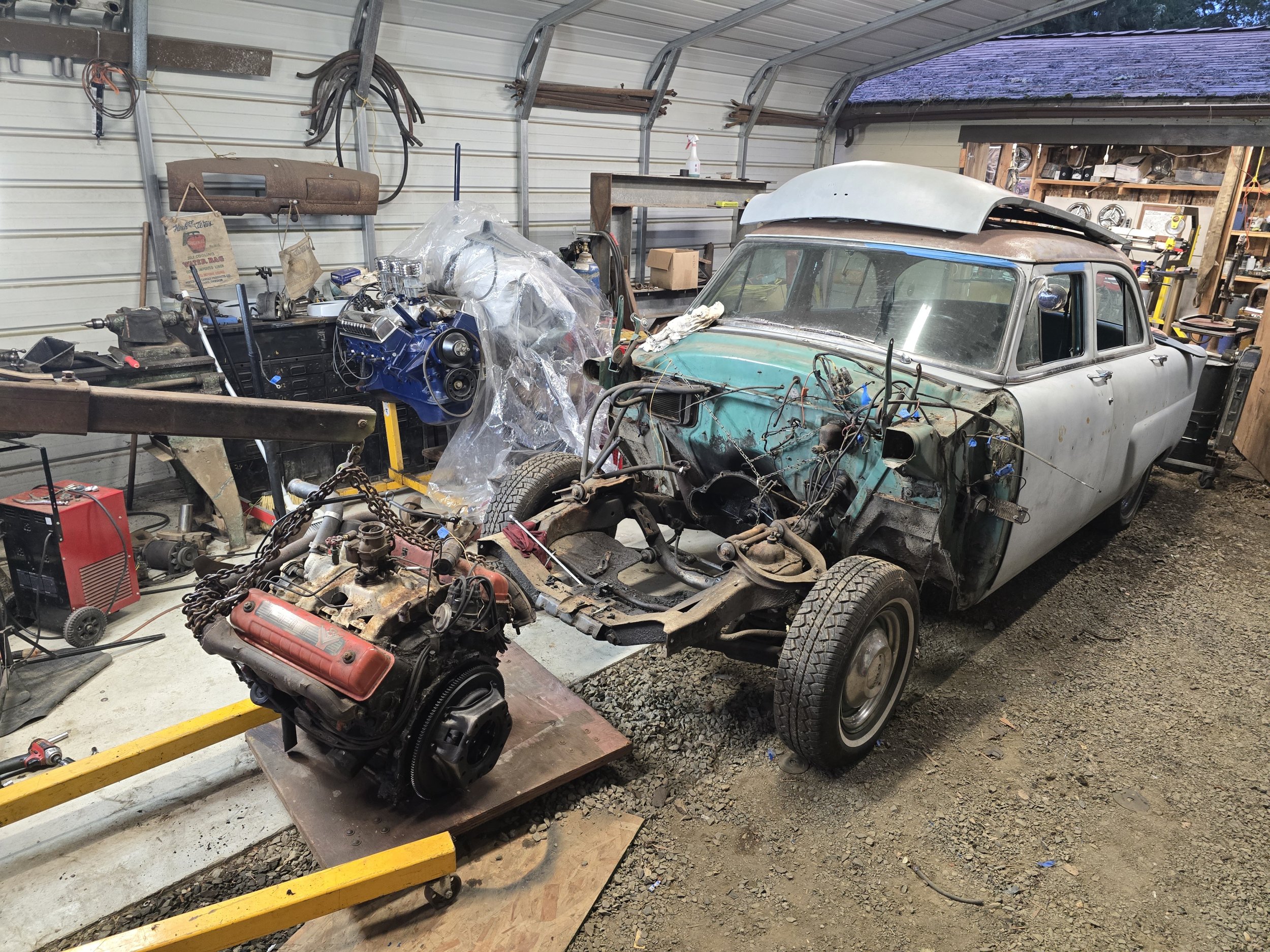

    Soaking the front end down in degreaser as I type this. I have a pair of 1990 aerostar front coil springs sitting on my desk. Hoping that before it gets TOO cold out I can get the body off and raptor line the ch***is. Then I can spend the bulk of the winter making the ch***is flawless and setting the coupe body back on. Then wrap up metal work, make it run, drive and stop and by the time the ice thaws in the spring all I will have to do is bodywork, paint and gl*** installation!

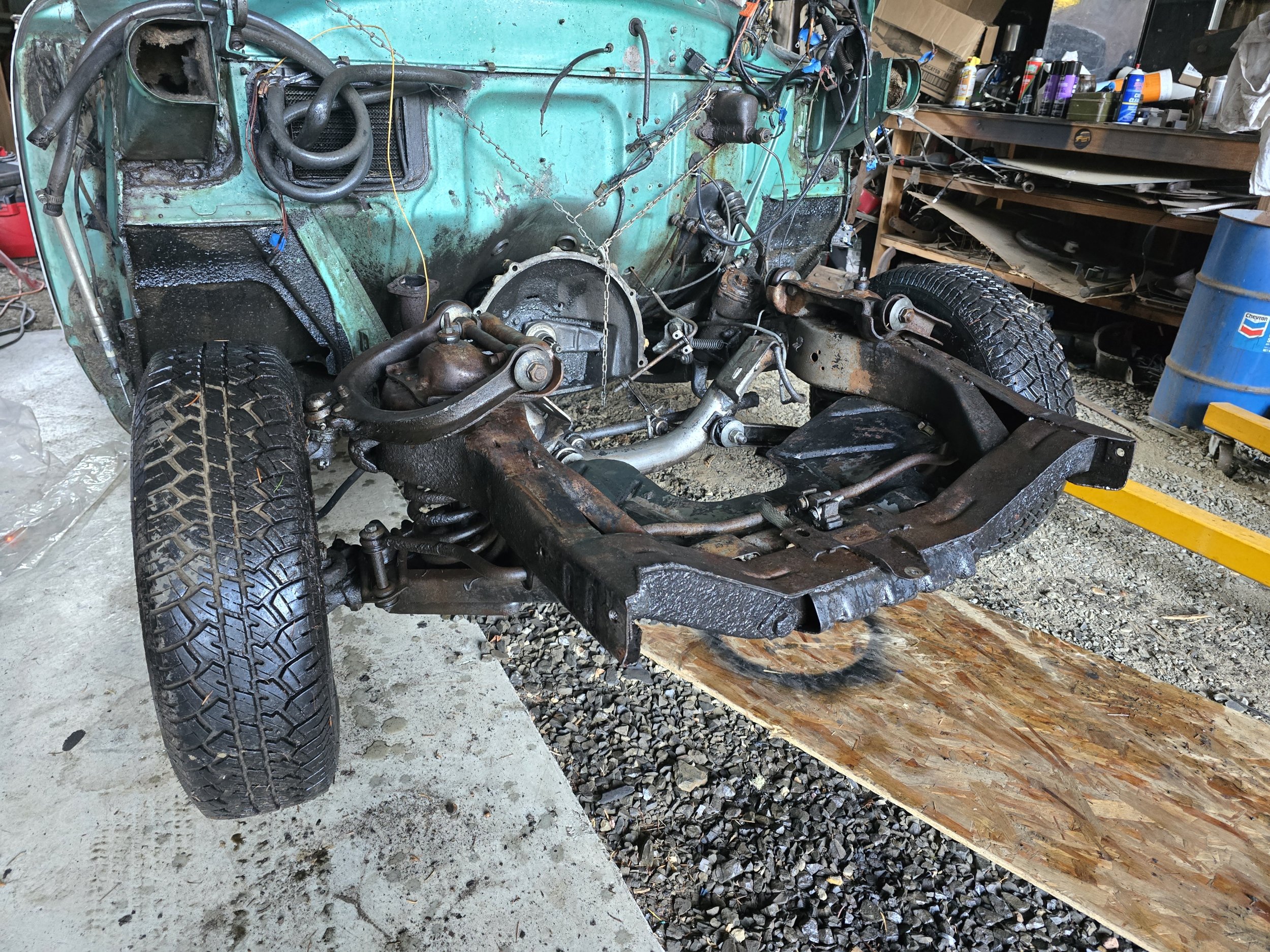

    Degreased.... cpl surprises. Looks like control arm bushings and brake flex lines are a part of the picture now. Theyre ordered and on the way

    Little more progress today. Degreased and pressure washed the 239.
    Degreased the front end again and sprayed a lil paint.
    Majority of the front end is coming apart though so most paintwork will happen the right way

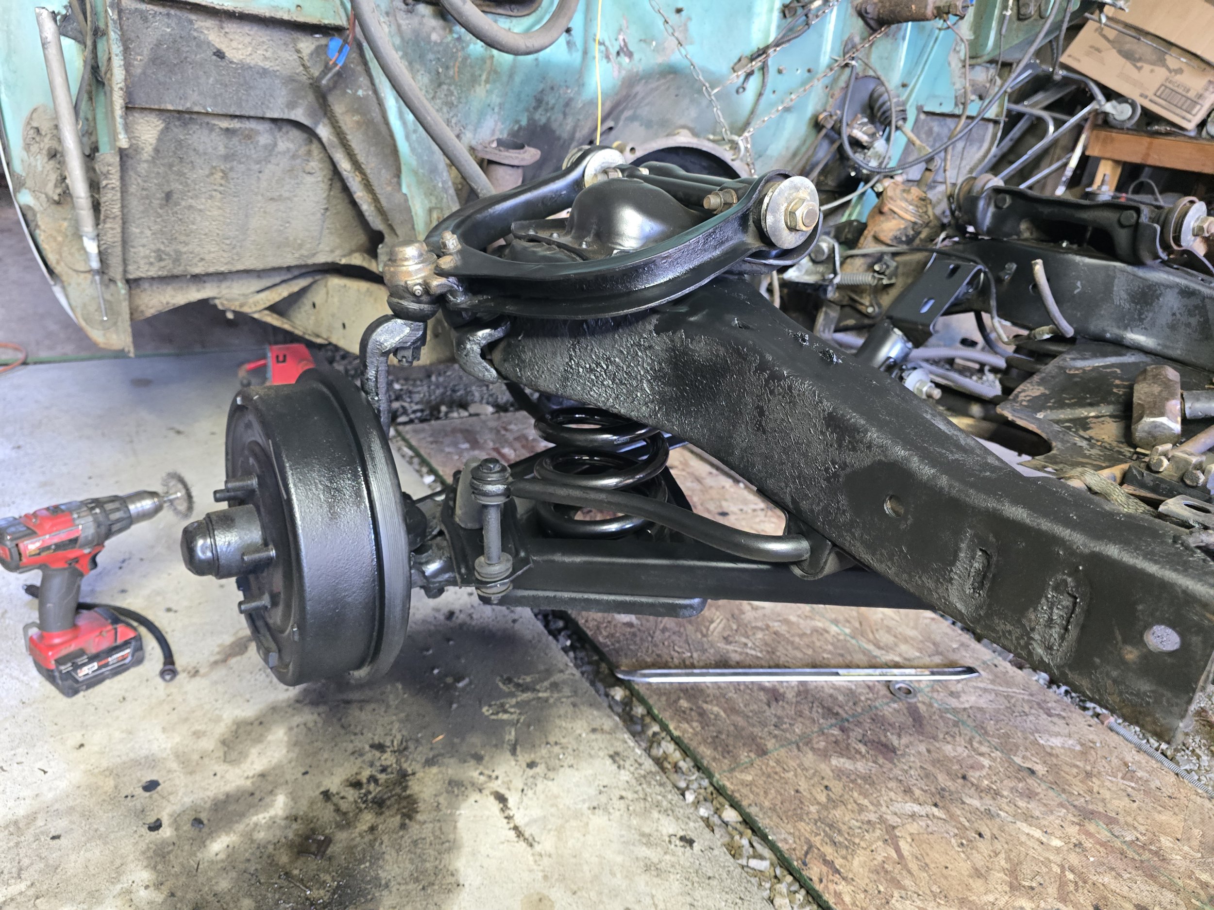

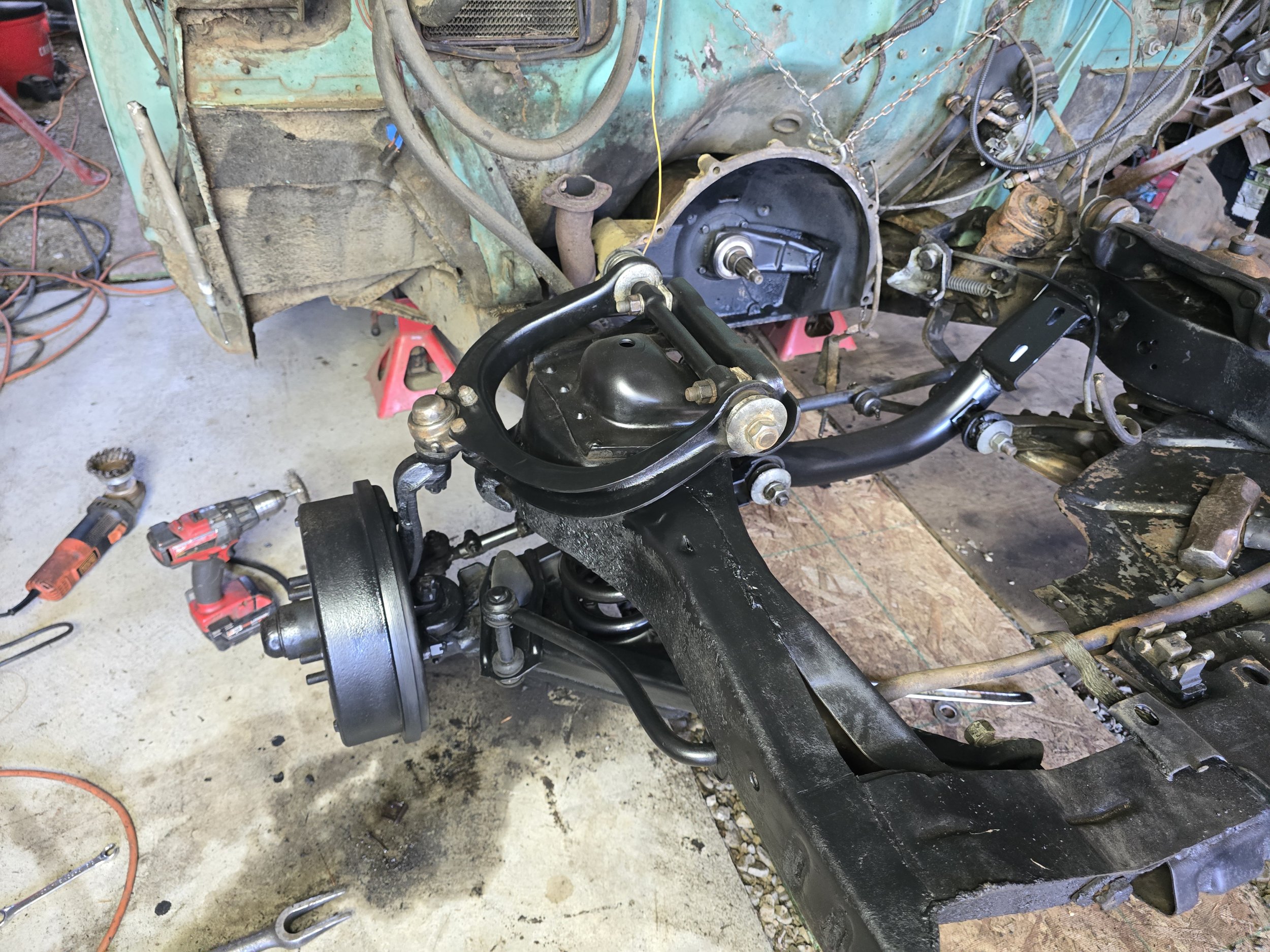

    Little baby steps but trying to make near daily progress. Today I got the p***enger side coil spring out, set her up on the bench next to the shiny new aerostar coils.
    Then I pulled the upper control arm amd rebuilt it. Smashed my thumb with a sledge.
    20251016_145310.jpg Then managed to stick the shaft in backwards. It all came together nicely in the end though! 20251016_170932.jpg

    1 side back together and complete!
    Relatively smooth sailin. Did make a video on the process...

    Okay...teensy weensy bit of progress.
    ...no, we didnt do it any sort of safe or easy way... it was me and one other guy willing to risk it all on a plan with likely a 40% chance of success. As han solo said...."Never tell me the odds!"
    The plan involved a jack, a cinder block, several jack stands, a winch and a prayer!
    We got her done though with minimal damage to the ol girl. Sad to see her go but love to watch her leave! Next will be raptor liner on the ch***is then drop in the 292, build the exhaust, get her running and set the coupe body on!
