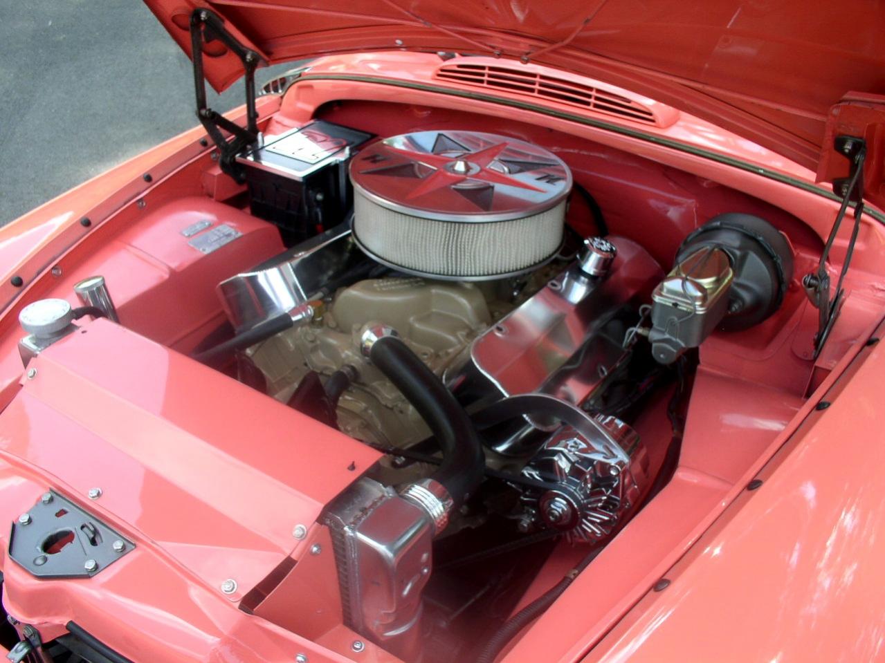

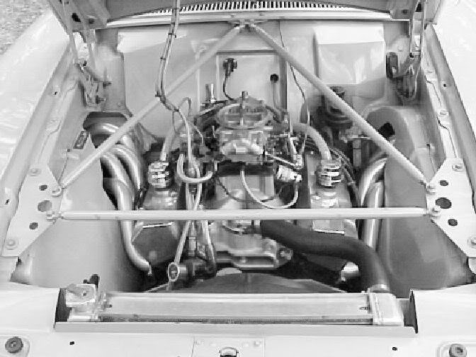

    theres actually more of thes out with small block ford/chevy's than you may relize....most ive seen keep the inner panel and remove the bubble are that Farna points out...wish i would have went this route with mine(less work/less money)...
    some of these examples are beyond what I'm describing...
