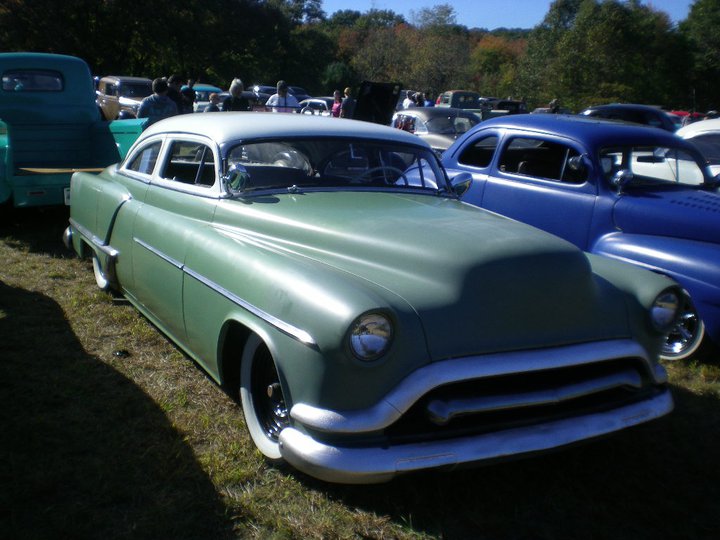

    you wanted it..here it is...
    damn doesen't that b pillar gap look like poo-poo? well he filled it on the p***enger side but got lazy... what do you want for a weeks work, right!?
    we took all but 2 leaves out of the rear, stacked 2" & 3" blocks, & added air shocks to make this ****box sit & drive.
    stance is killer. body lines are killer. kar is killer. so proud to be a part of this build.
    also, i know for a fact the owner of this kar i lurking this thread so from now on, all questions can be addressed to matty!

    haha good question!i had to use a piece of plexi for now

    this is him! He built this ****box! Bug him!

    the grille is a sectioned 69 camaro front bumper with cannibalized rear stock 53 bummperetts

    yeah i just laid it down and hat to make filler pieces on the sides and rear.the back gl*** when laid down is not wide enough so i had to fill the gap close enough so i could use window glue to seal it with a weather strip.
