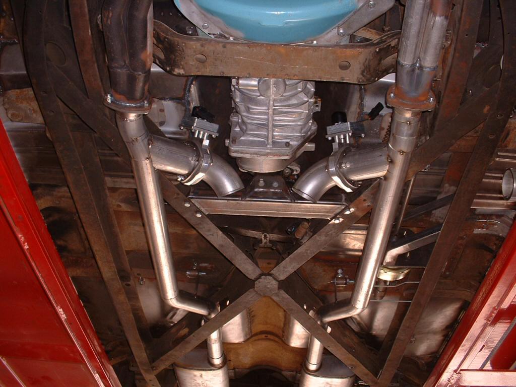

    For those of you who are wondering WHY this is all such a big deal, have a look at how it's mounted. This is a picture of my '53 without the engine in (before I got it back). The MC is mounted just inside the frame below the steering column. Craziness!
    Sorry for the scary picture.

    Oh, same as the tri year cars...............poop, I thought you had a firewall mount. I want to rebuild mine, but damn.

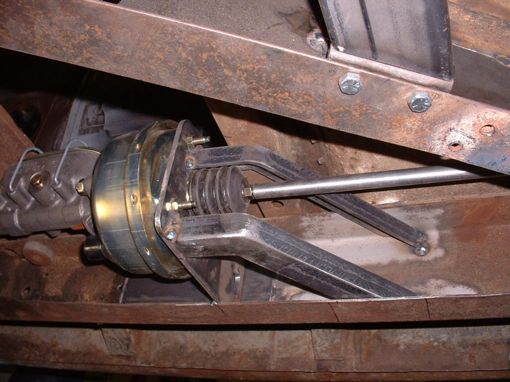

    Here's some pics from a 57 Pontiac , real close to the same deal. A universal underfloor booster/master is used and a bellcrank is to operate and mount the master backwards as you can see. These pics are from Pontiacsafari.com.
    For my 55 i'm mounting a hanging pedel assembly from a 55 chevy. I made up a plate and welded in the area of the defroster holes to give the firewall some rigidity. Although i've found I don't like the short arm for the brake, I want my master mounted up pretty high on the firewall. So i'm using an arm from an old truck to offset the pedel assembly where I want it exactly, real close to the stock location. I don't want to have to "feel" for the brake pedal under a panic situation. A cast iron gm master bolts right up or i'm using a 85 Chrysler 5th ave master, very similar to the Wilwood master. Same for manual or power brakes. Bill
