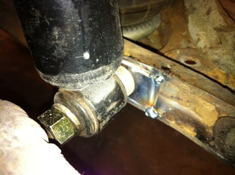

    It's so simple its hilarious. the cups are for a 65 Impala,welded a piece of allthread to it and ran it though the stock shock mount.I will end up clearancing the lower A arm around the lower bag a little after I blow it all apart.

    This iPhone app **** is pretty sweet !
    Some more front end pics, just a generic shock bolt with a 3/16 plate . The upper shock mount is from the Impala kit. Would be easy to duplicate .there is a nut welded to the back of the 3/16 plate on the lower shock mount. Drilled it though so I can weld the bolt to the A arm.

    Came up with this little idea tonight, used some tubing close to the size of a shock. Looks a lot cleaner than the all thread. Getting ready to pull the rest of the suspension and start sandblasting' !

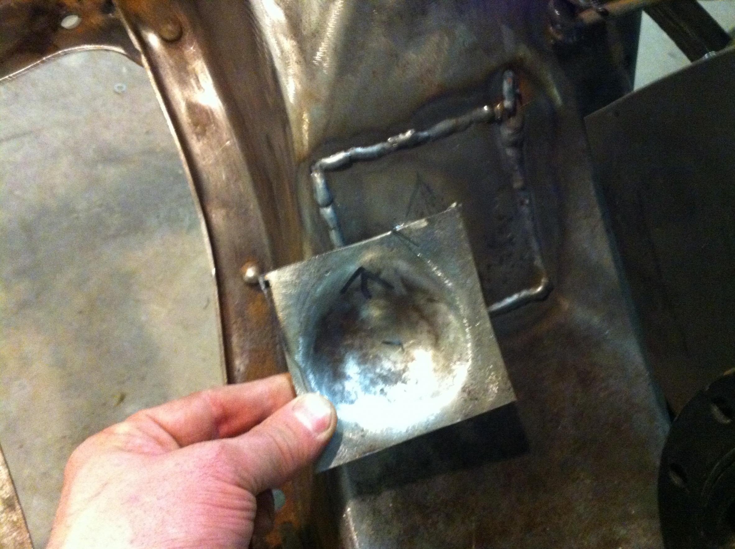

    Had to cut the depression out of the frame where the original fuel pump was. Used flat head style mounts for the front mount.

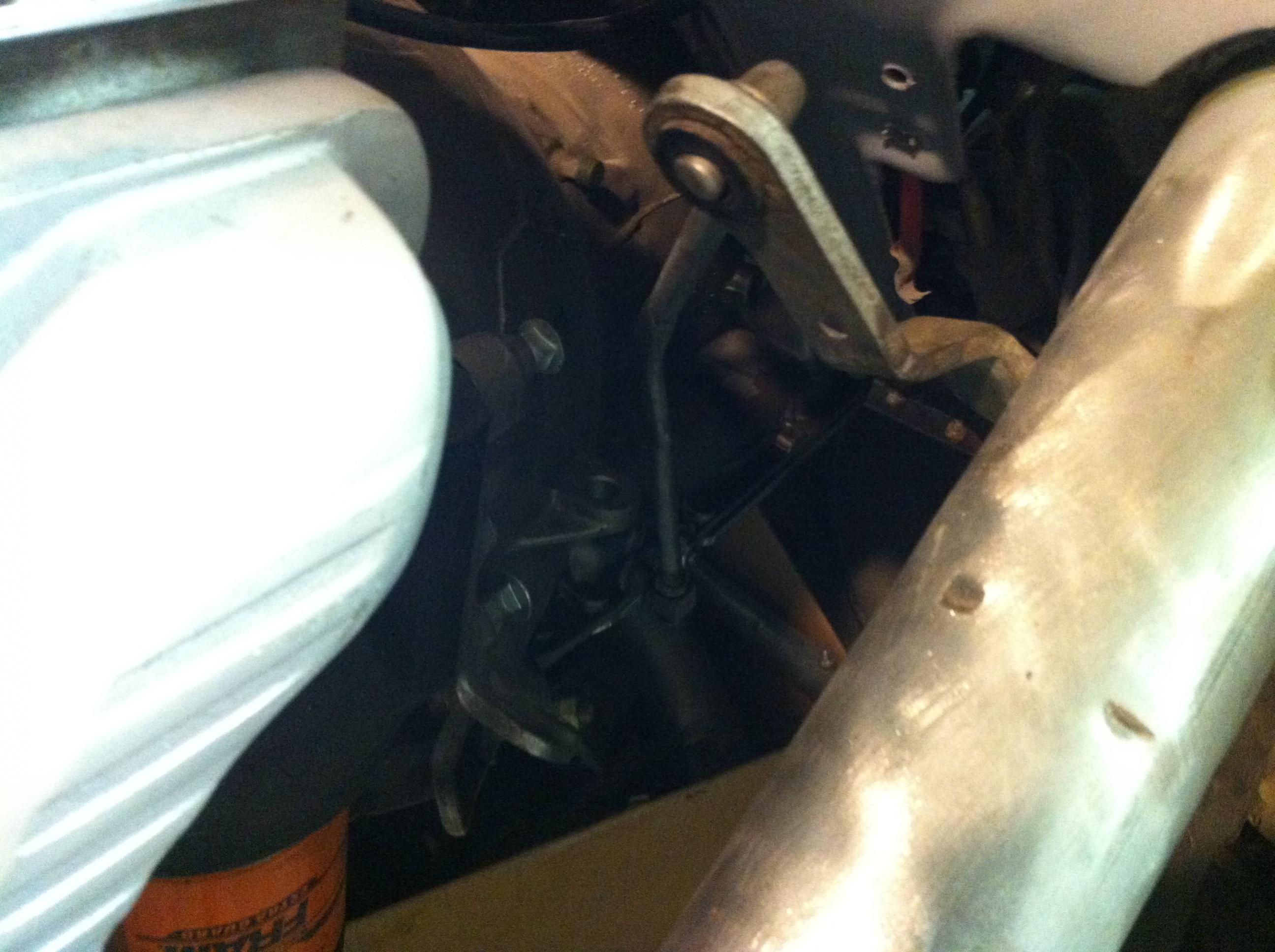

    Finished up the shift linkage today, just shortened the original arm , I did have to make the lever for the ******. Seems to work well !
