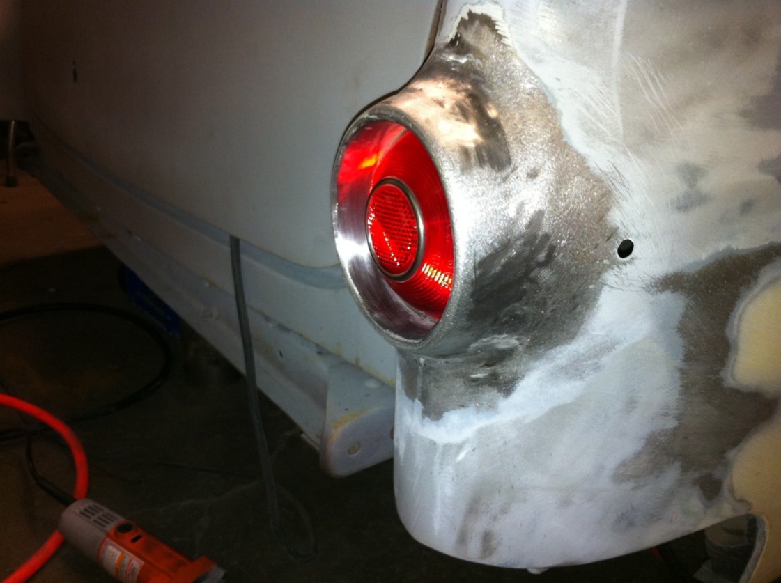

    A little progress today ! Finally got off my *** and got one of the tail lights fabbed. Stock lense tunneled and mounted from behind .

    Used a piece of 4 inch exhaust pipe, than made a ring from 3/16 round stock.

    Nice job on the car! Post a few more pics of frenching the rearlights if you got, Im thinking of that for my 53 Poncho

    I should have some pics somewhere. I made the ring by first making a paper pattern,transferring it to sheet metal.Its one piece with a seam.
    Maybe Ill do the next one as a how to...?

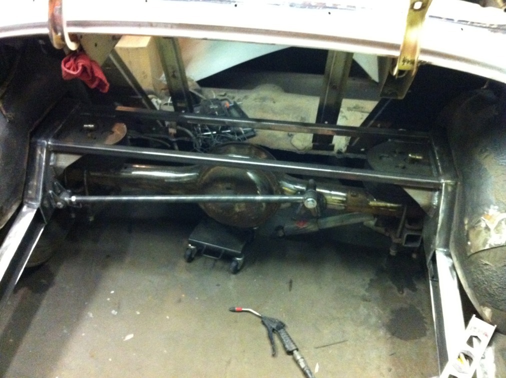

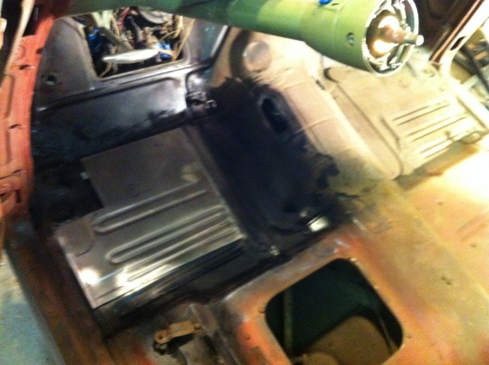

    Well, figured I'd post some updates, Im pretty bad about posting as I work. Anyways, I got the rear suspension about 85% done. C notch , custom built trailing arms , etc. panhard is from welded series . Still need to position and weld lower bag mounts . Finally finished my bead roller , so I built a new floor for the drivers side and got one of the trunk pieces made . Also stripped the dash ,I filled a few holes and did the body work already , haven't taken any picks . Plan to get the dash and door jams finished this week . Need to get the doors blasted and primed , than I'll get the nose back on and finish the body . I have five months to finish !

    So it looks like your going with a parallel 4-link? Got any more pics of your rear set up?

    Thanks guys ! The rear is actually three link, I built the trailing arms from 2x2 stock with adjustable bushings from welded series .

    Interesting approach. I like Welder Series' notch kit. For $90, you can't go wrong. They actually look like they make a ton of nice parts. I can't believe this is the first time I've heard of them.
    Questions though:
    What rear end did you go with?
    When the bags are deflated, do the trailing arms put an angle to the bottom of the airbag?
    Did you use the factory spring mount for the trailing arms?
