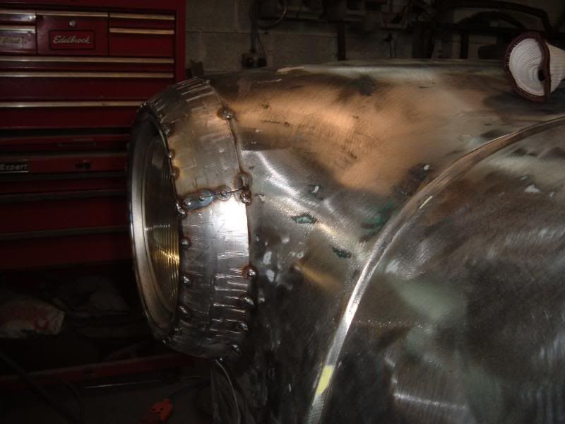

  21. heres a few mor updates.
    Started to french the headlights in. Picked up these rings a few years ago but they are a bit small in diameter and the headlight looked to be too deep in the ring.
    I cut about 1/2" off and tacked it in
    Then made up some filler pieces to blend it in to the fender

    Look cool mate, any grille hints yet?

    Kelvin, Very NICE work indeed! I look forward to seeing your Pontiac this year.

  25. I have a buick grill here to try, I am just going to mock a few things up to see what looks the best
