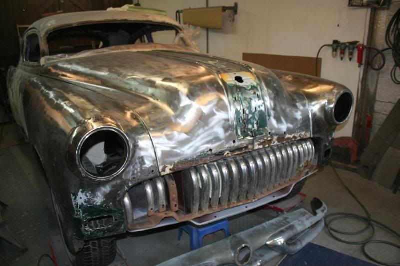

  2. With help from a few good friends we managed to get the two front wings straightened out and looking the same.
    Thanks Pete
  3. Next onto the front grill and Hood. First had to repair the front of the Hood
    Then welded on the original trim piece
    Not sure what the front bumper is from
    Had to make up a new splash pan
  4. Picked up two Buick grills and made up one good one, replaced the teeth where they were short on the original grill.
    Welded part of the pontiac front grill to the wings adding the parking lights and finishing off the front end
    The last bit was to finish off the lower part of the grill and make a filler piece.

    Bloody hell, Kelvin NICE work! I wonder is that bumper from a '55 chevy?
    Looks GOOD what ever it's from!
    Just seen the grille, damn NICE that is too!
    Nick.

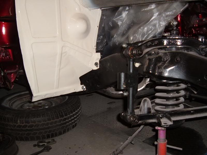

  6. Now starting on lowering the front with some 2" lower uprights from Fatman

  21. Now got her sitting 4" lower at the front using fatman uprights
    Because time is running out I am using the kids to help out with the body work
    made up some new rear light bezels, these will be welded to the body and painted. The old ones were pitted and needed re chroming.

    How'd you make the bezels?
  24. turned them up on a lathe out of mild steel
