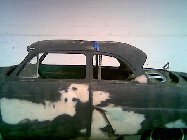

    awww ****!! so i tried to do something other than cutting off the roof and all i got out of it was a buisness cl*** ford. man! well id like to thank all of you for your input(good or bad). im just gonna chop the rest of the roof off and go with my original plan. im so bummed! this is my first project so i guess ill learn from my mistakes. if you have any ideas please let me know. heres some pics. i took out 5 inches from the rear window mid section and moved it. the way i cut it seems as though cutting the rest of the roof off might be a problem. anyhow if you have any input ill take it. thanks.

    Your idea of chopping the car was to section the roof and move the rear gl*** 4" forward?

    i sectioned it 5 inches and moved the rear gl*** forward. i think it would look cool with a longer trunk. i dont know i have had this car for a year and havent done **** to it now i have im thinkin what did i do. mabey im just indecicive. i should have stuck with my original plan. and now i will. only ill have a streached trunk. check out the pic.

    that roof line kinda works but if your gona finnish it that way i hard topit

    gotta agree with sko_ford. . . the bidniz coupe look is sweet, but DEF do a HT for it. . .
    with all that tin sliced out of that thing behind the package tray, you're almost there if you'd want to chop the top an keep the stock gl*** in the backlite... just lean the lite forward, then lift it enough to keep the entire leading bottom edge above the quarter.
    smooth's out the lines in the back of the roof, and allows about 5" of chop from the rear without really chopping it that much... should also get around 3-4" out of the front and the top will flow like ****er on a hot day :cool:
    PS... to get the business coupe look from what you have, you dont need to lengthen the decklid, just the deck from the lid to the gl***... i have thought about that trick on my 54 more than once
