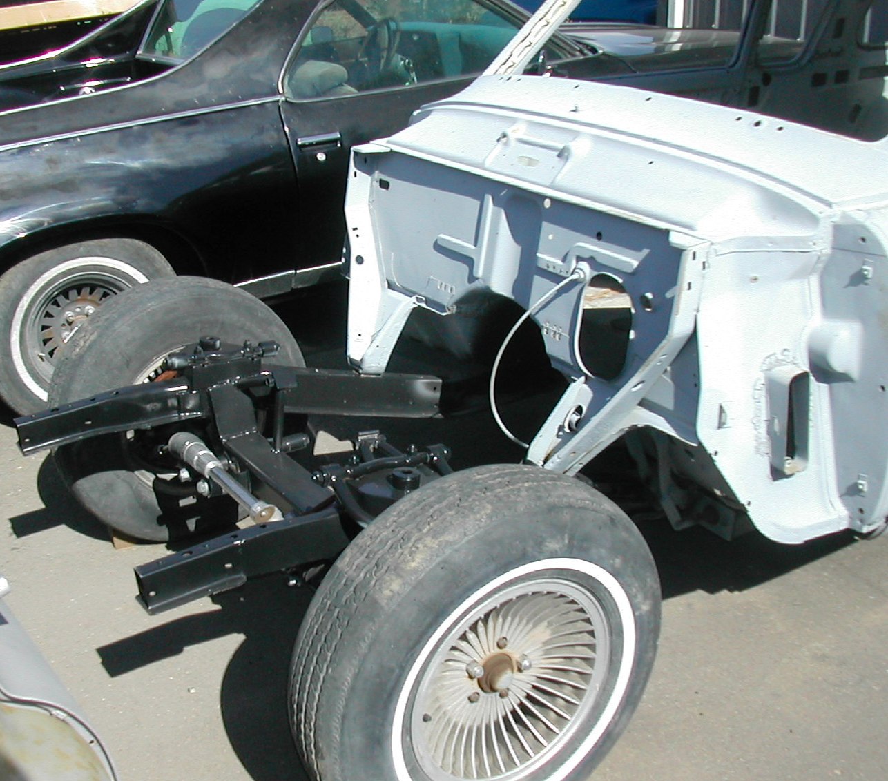

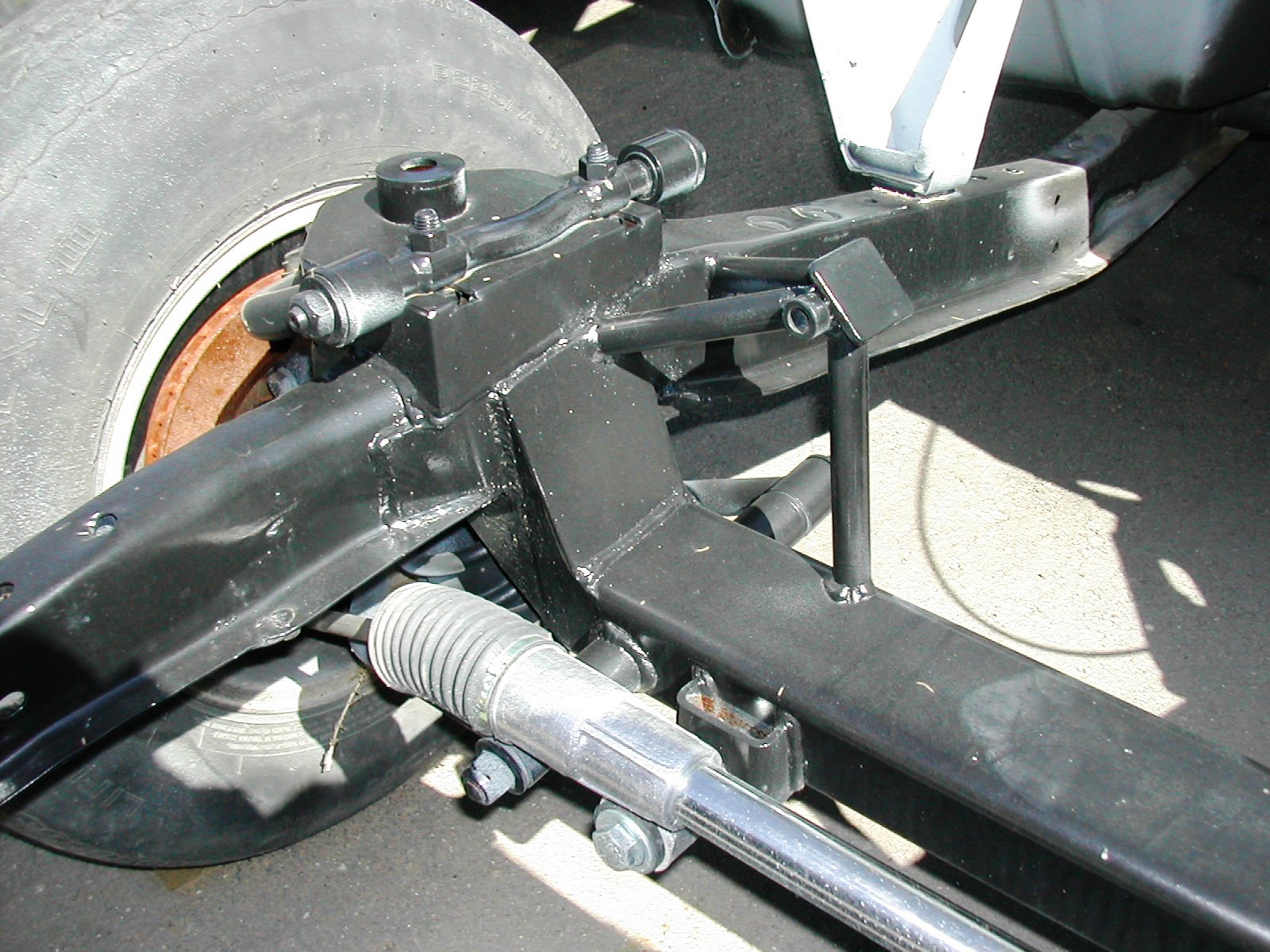

    I have a '53 in the works. I'll round up some pics if you want.
    Mine also had a 6, but a friend sold me a fresh 259 v8 Stude he swapped for a hemi in his '56. The Studebaker v8 is solid, albeit heavy, heavy. Basically, its a rip-off of the '49-54 (I think) Cad 331. The later R2 Stude models were 289, with a nice cam, and were made until something like '63. As Studebaker was coughing up death moans it used Chevy engines. Internals are available. The guys making old Offy parts have started recasting a 331 Cad 2X2 intake. Really cool. It fits by hogging out two bolt holes. Like I said, the Stude v8 is basically a Caddy rip-off.
    I'm guessing you've found Studebaker Vendors on the web. There are some sheet metal parts, etc. available from Classic Enterprises. These generally need a lot of tweaking, but they work.
    Be very careful in inspecting the area around the bottom of the A pillar. This car, even with the post, is too flexible. The top hat frame was not great. If there is rot at the bottom of the A pillar, it goes from bad to hell. Classic has hood stiffeners. Advised!
    There is a guy who hops up the little Stude flathead 6 and it dresses up nice. I forget the name, but if he's not on Studebaker Vendors, I'll find it for you. The 3 speed overdrive had a hill-holder feature on some models. It's a nice tranny. The original BW auto in those things is junk, the rear end too. I put an 8" in from a v8 Maverick. The rear anti-sway I rigged up is cool. Let me know if you want pics.
    I put in a T5 from an S10. The adapter came from Berentsen. I am using a Hydraulic set up to move the throwout bearing shaft. Several outfits make an adapter kit to put a T350, or 700R4 behind the Studebaker v8.
    I believe the motor mounts for a chevy are available. Plenty of room.
    There is a good disc brake conversion available for the stock spindles. Again, if you can't find it on Studebaker Vendors, holler. BTY, I have most of one. I didn't use anything but the wheel bearings, as I went with a firewall mounted power master. I'm happy to try to figure out what you need and what's missing from my setup.
    Much monkey motion in the stock steering, with the center bell crank, etc. I rigged up a rack and pinion, but I found an R&P that's better, albeit steep in price. Let me know if you want some pointers. If you want R&P it would be cheaper to go with the Fatman MII clip. If I were doing it again, I'd go with the Fatman clip. The original front suspension sucks, but I was lazy, will try a heavy anti-sway bar from a later Hawk for now.
    I found a '56 dash. It's fiberglass, nice, with a flat center surface, bolts right up.
    What can I do to be helpful?
