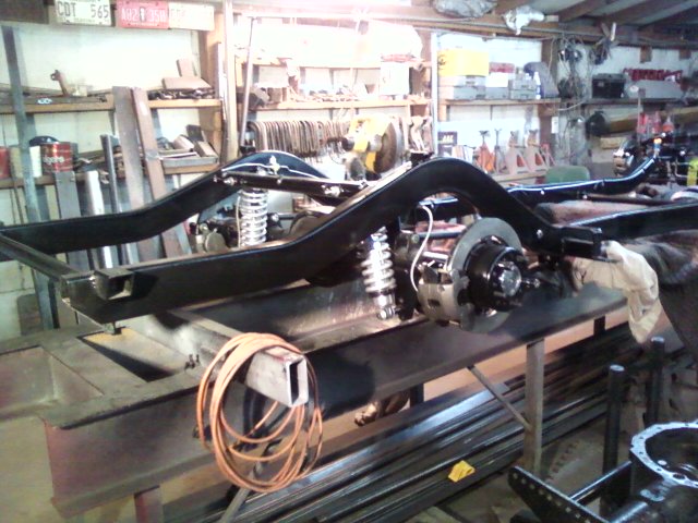

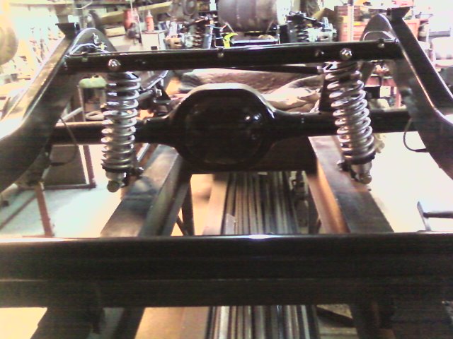

    I do the studebaker ch***is in house turn key with mustang II ford rear 4 wheel disc, coil over rear with 4 link great street rod ch***is 2x4 mandrell bent just finished one tw weeks ago ... your biggest issue is the hood clearance at carb...

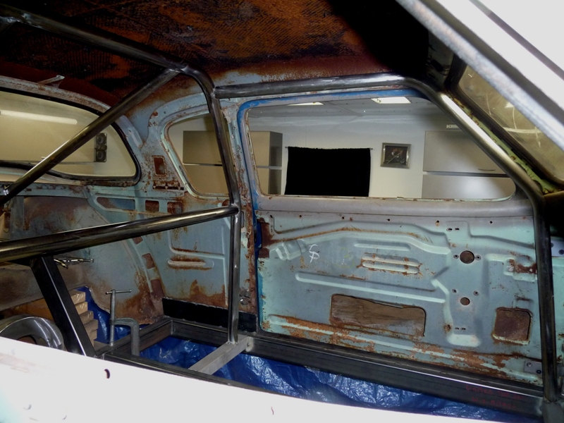

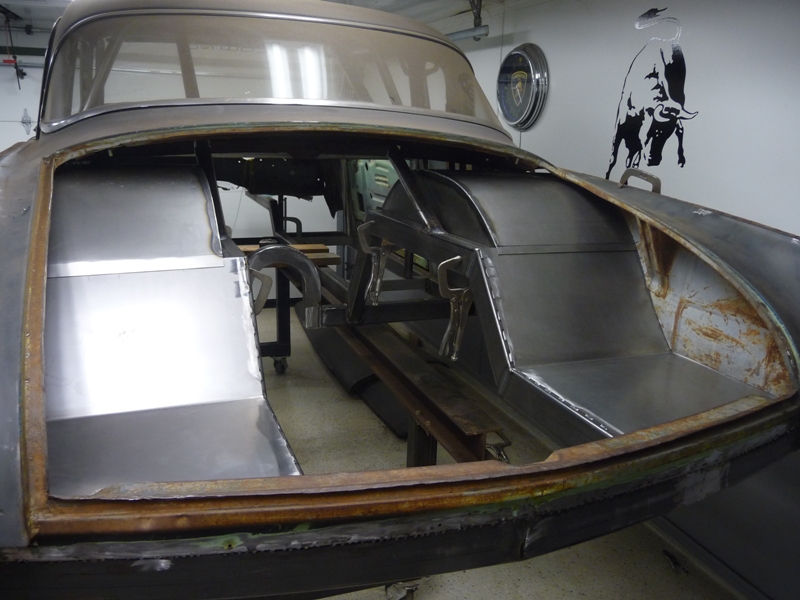

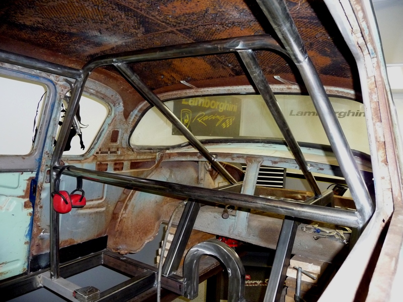

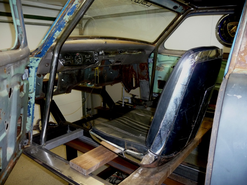

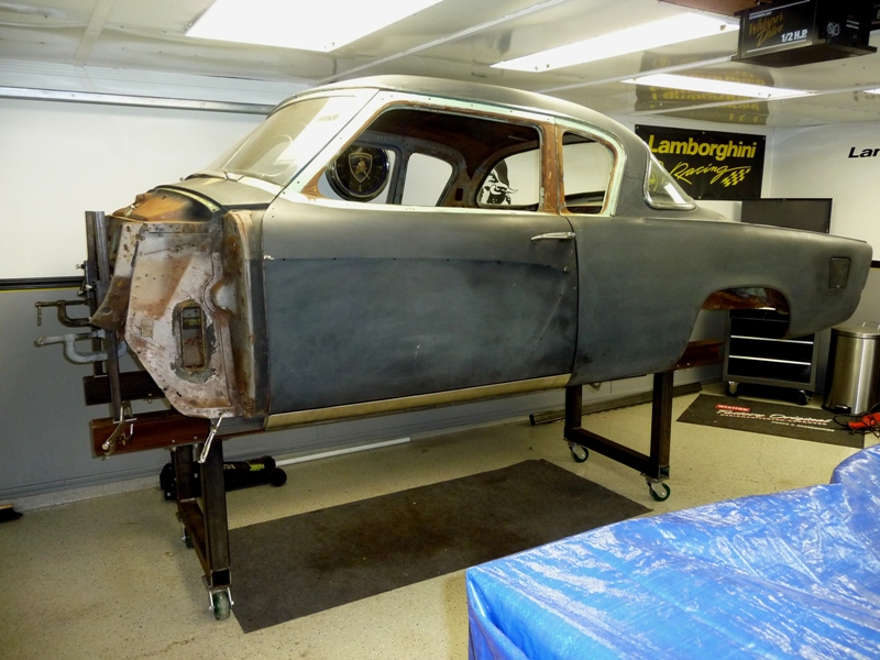

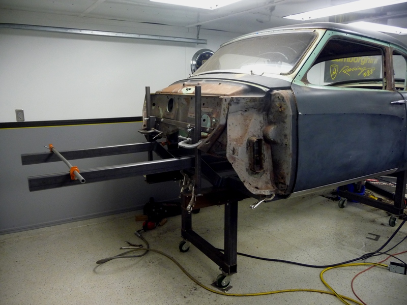

    Well, another 53 Stude project! Here is where mine is at. I will be going with big block Hemi. The stock frame is history as it is way too light. Rack & pinion is the way to go on the steering. I also choose the MII front end. Good luck on your choices. They are awesome cars. Post pics of your progress I would love to see them.

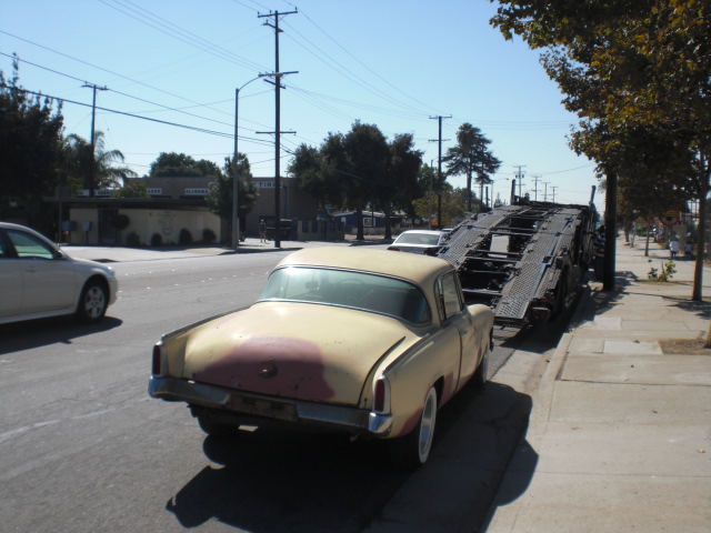

    This photo in Long Beach by Bill & Ricks Studebaker shop?
