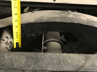

    I am looking for a little advice on a truck that was just purchased by my friends dad. It is a 1951 Chevy 3100 truck that has had a lot of work done to it by its previous owner; 350/th350/10 bolt. I went over there tonight to check it out and he got excited and wanted to dive in so we decided to take out the rotted wood floor in the bed. Once all the wood was removed we saw that the old owner built some sort of frame in the bed that is a little shady. Then I noticed the frame notch that was done. Looks pretty decent, but kind of thin. Looks to be about half of what the frame used to be, but still small looking. I crawled under the truck and look it all over and it looks solid. No signs of any issues. The old owner claimed he towed a trailer and hauled a bunch of stuff in it all the time, but I don't know for sure.
    My question is, how sturdy is this frame really? Or I guess I should ask how does it look in the notch section? Is this normal? Is it strong? Is this frame notch going to hold? If my friends dad tows his car trailer with it, is the frame going to break? I am used to the typical frame notches and was hoping I could get some information to p*** along the my friends dad. We are all learning and need help from the professionals!
    Is there anything he can do to strengthen it the way it is? Or is he going to have to put a better notch in?
    Any help or advise is greatly appreciated!
    -Jeff

    It should have had an internal gusset to strengthen it before it was boxed. Given that the shocks are mounted on a tubular cross member and it still has leaf springs that's a relatively small area to rely on for strength, especially when carrying a load or towing. I'm surprised it hasn't broken its back already as those 'C' notch vertical sides are the weakest part of the frame. Another reinforcement plate on the inside or outside will strengthen things up.
    [​IMG] [​IMG]
    It's wider on the horizontal than verticals and that's the weak link.

    I am having a hard time understanding the pictures. It almost looks like I can see thru the frame like it has no vertical section. But I can give you some facts about how a beam works. ***uming a beam loaded vertically

    ...that truck must sit really low in the rear as these orig. AD frames have a good arch over the rear axle to begin with, usually no need for a notch,...personally i don't like the way those look but I'd just add a metal plate to the framerail, inside or outside to stiffen it up. good luck.

    I forgot to mention that the pictures I took are a little deceiving. It was taken from a top angle. The notch is not angled like it looks in the pictures. It is squared. The back of the frame is about 4" and the center of the notch is 2".

    put a plate on both sides of the frame and if you can make them taller than the top of the frame now, then box the two plates in over the top, a bit of overkill but it'd be plenty strong enuf to do what you want with it. got any pics of the whole truck?

    This basically says that the frame is 1/2 it's original height so it is therefore only 1/8 as strong as it was. (.5 X.5X.5=0.125).
    Not knowing how strong it needs to be, I would target increasing the strength to as close as possible to where it was originally. Therefore I think that you need to do more than adding doublers on the vertical sides. You need to add doublers to the top and bottom flanges as well. On the top flange since adding metal on top may interfere with the way the bed fits, you can add the doubler on the under side of the top flange.
