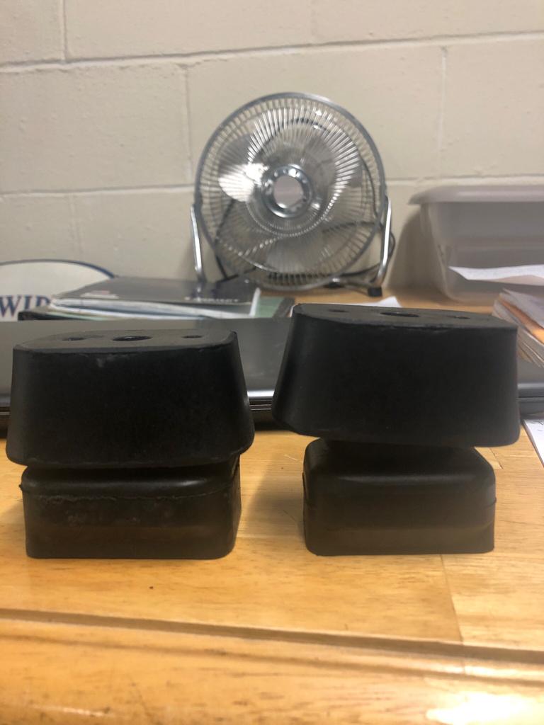

    I have 2 correct lower mounts (thick ones) 2 upper mounts that are 2 different sizes. Which ones are correct??
    The new mounts that I ordered came in and are the smaller upper mounts. Larger upper mounts look correct to me.
    Confused....scratching my head. Can’t really do anything until I mount this motor back in place.

    The opening on these are totally different as well. Just want to know which one is the correct one. IMG_5979.JPG

    been a while since i done one. i think the smaller pads go under the mount with the big ones on top. big washers on both sides. top and bottom with long bolt.

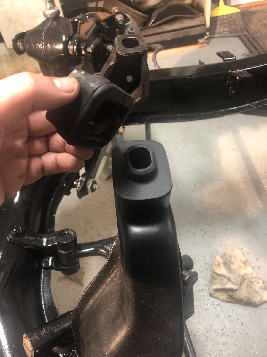

    Got her all figured. The confusion one wrong part can create!!! Thanks for help. [​IMG]

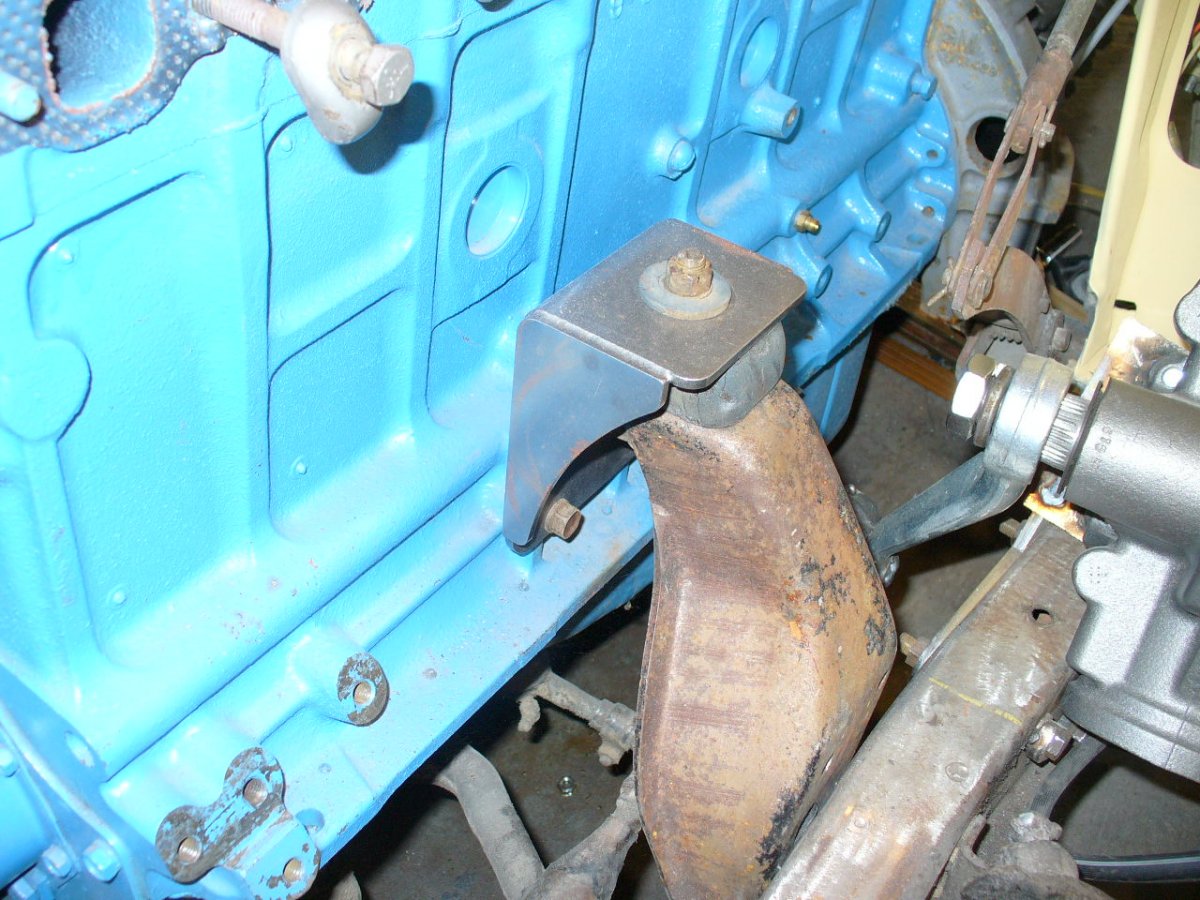

    I think that may be the wrong installation. As it was said in an earlier answer, the mounts should be above and below the side frame bracket. This is from the 49 to 53 shop manual. IMG_9759.JPG

    Hardtop! Thanks my man. I looked and looked and must have skimmed right over that 15-20 times. After I read that I went back and looked. I’ll be damned my shop manual says same damn thing. In a ***** for over looking good it.
    Anyway, thanks. I flipped them around and it makes whole lot more sense. Appreciate your help. [​IMG]

    Hey buzzbrother, nah, you're welcome and you're not a *****! Man I used to ask all the time to when I was doing my car. I was given lots of help back then. I just have to give back whenever I can. It's the same way in my 52 with the 54 engine. One thing I did though, was to put the bolt with the nut down under. Just in case, you never know! If, for some crazy reason the nut came off, the bolt won't fall out of the mount.
