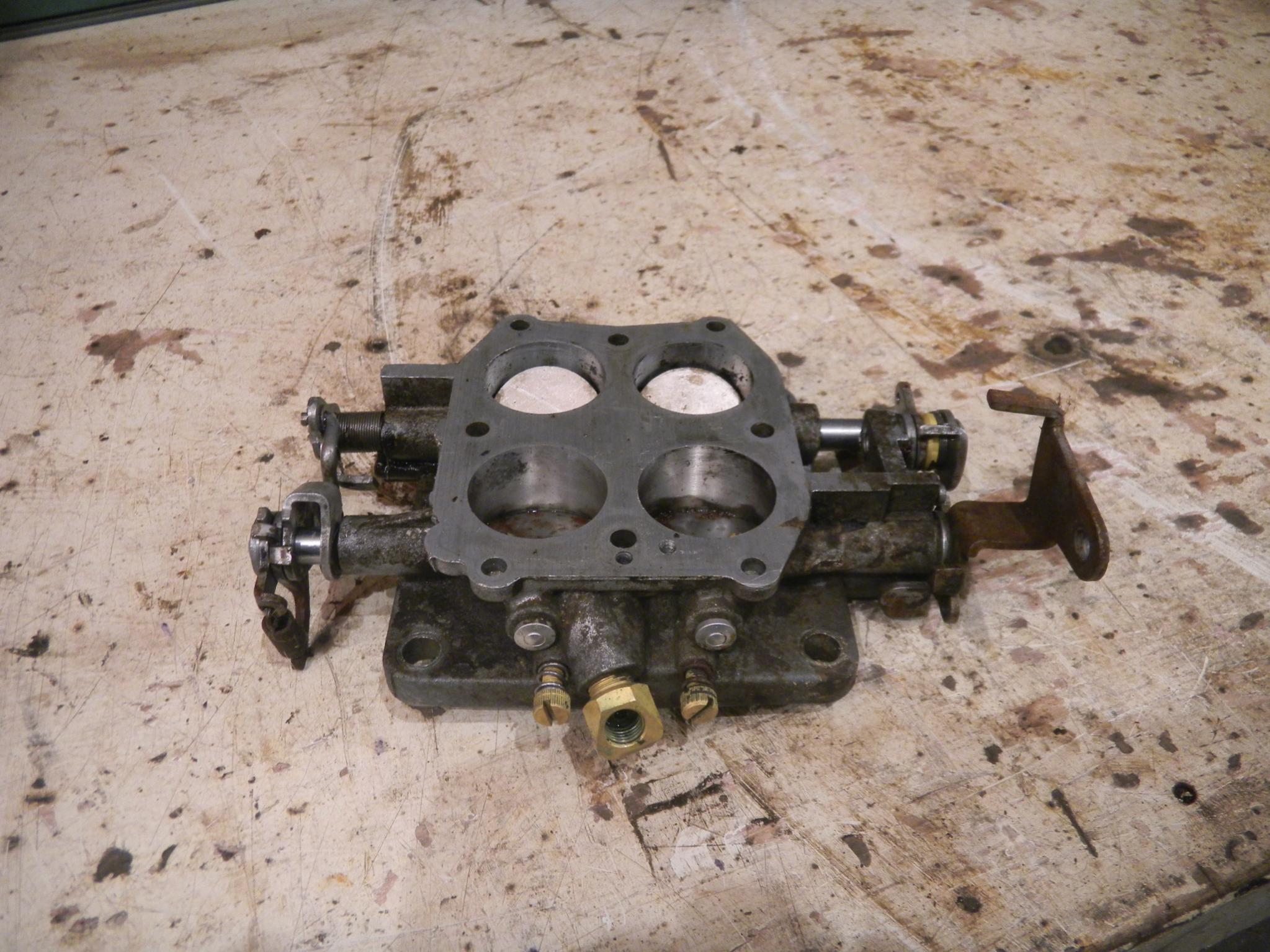

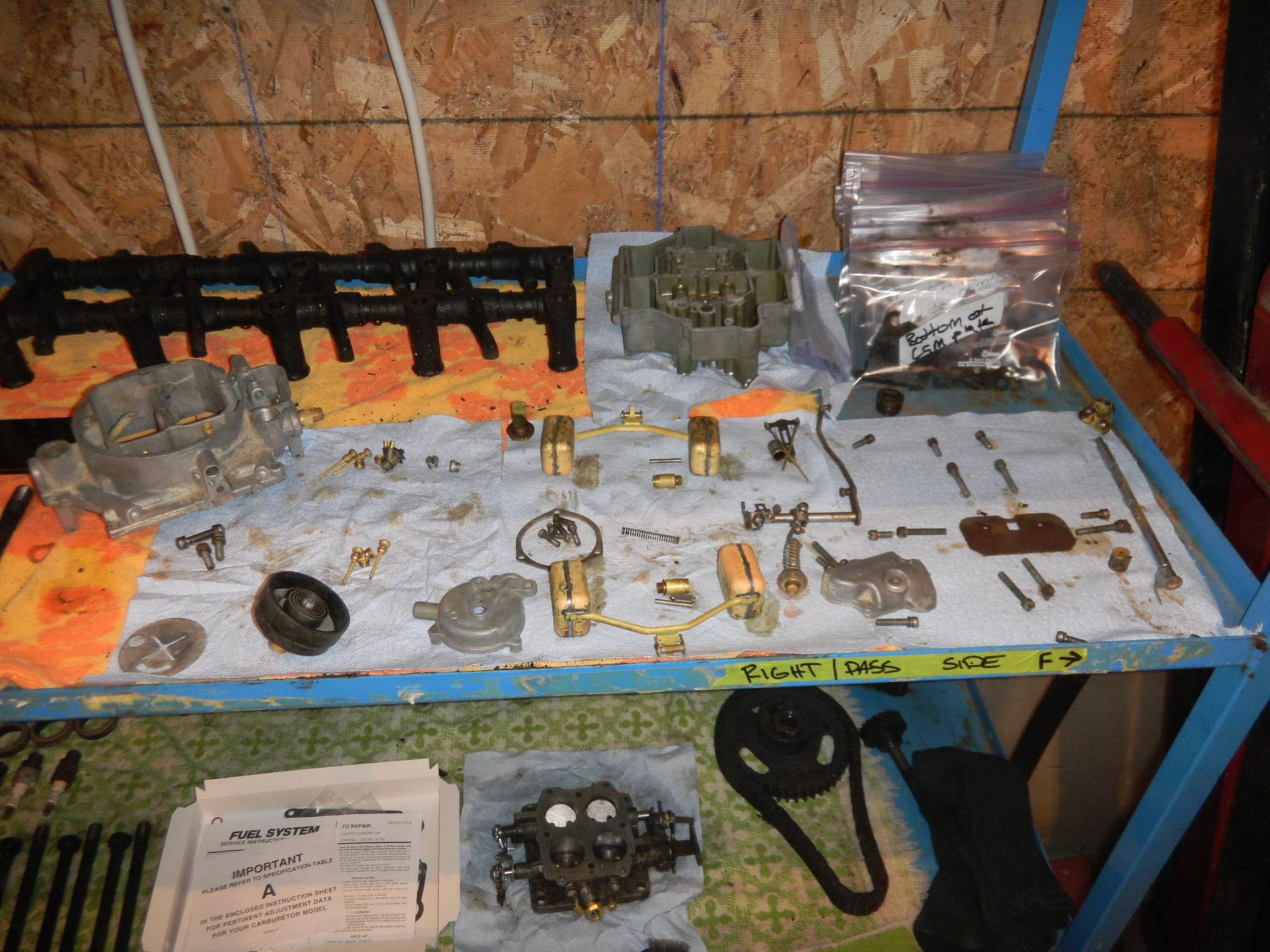

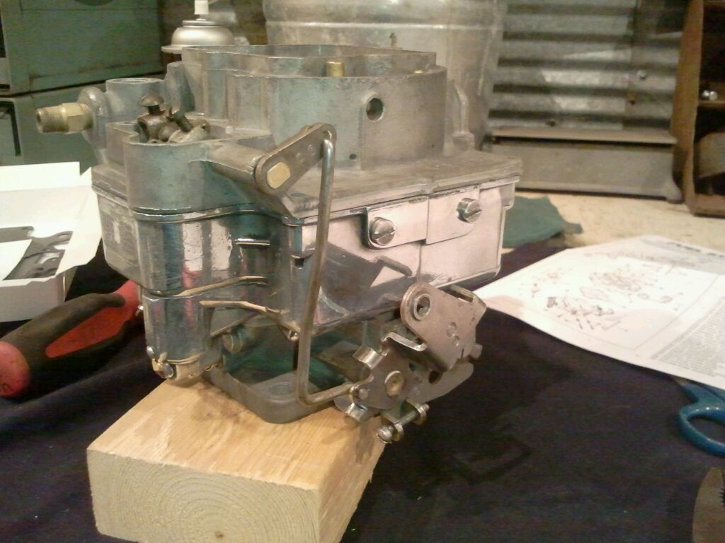

    UPDATE- Soaked the carb for about an hour in some chem dip and started taking it apart. After serveral more soakes i have it all dis***embled and cleaned. The carb was so dirty there were tree sprouts growing in the bottom. I should have taken a pic.
    I would like to dress up the carb a little by either bead blasting it (i know not a good idea) or painting somewhat stock.

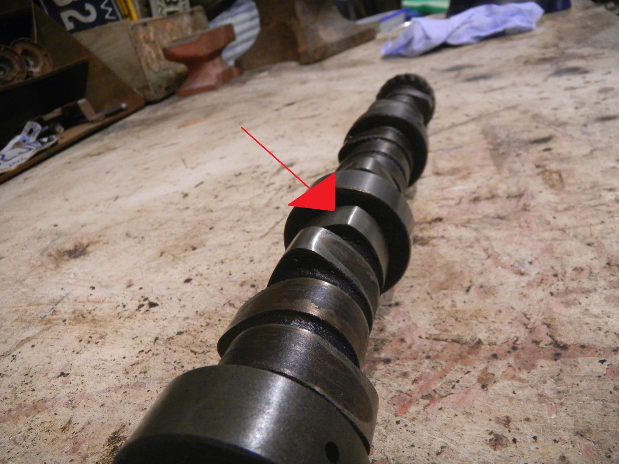

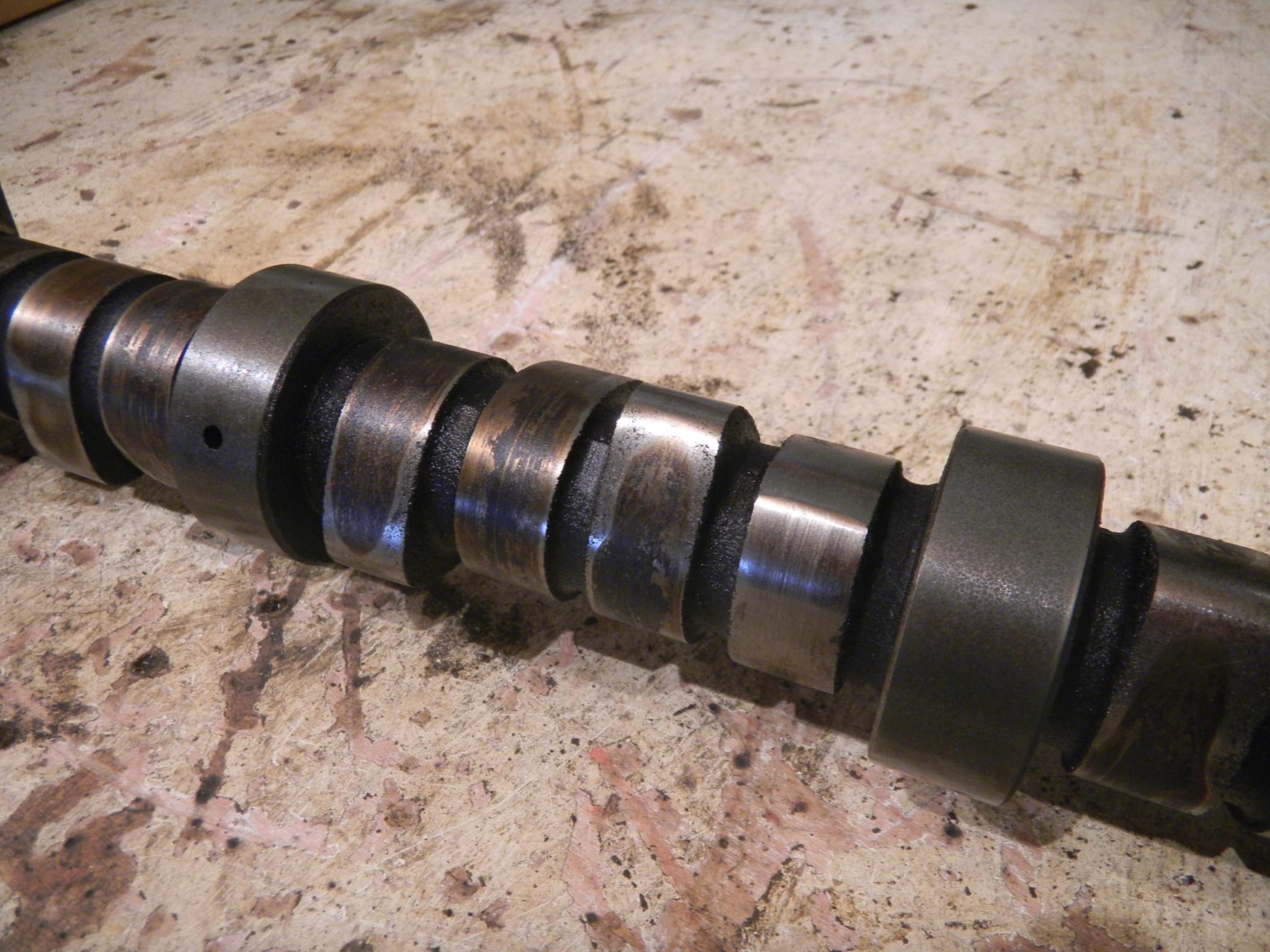

    Pics of the carb apart and bad cam lobe
    Ok dumb question. I plan on using the stock water pump and timing cover. Does this mean i have to have a "1954" cam and run the stock timing setup or can i get a cam with a short nose and run the newer setup? Im guessing not if i still want to run stock fuel pump.

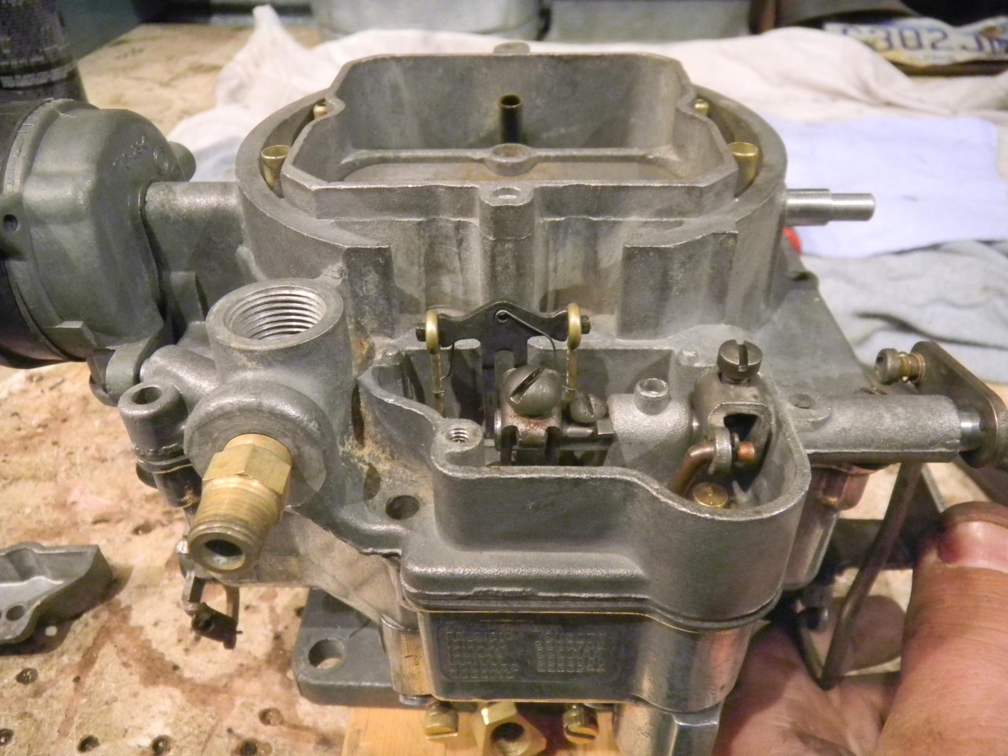

    Carb going back together. Lots of work.

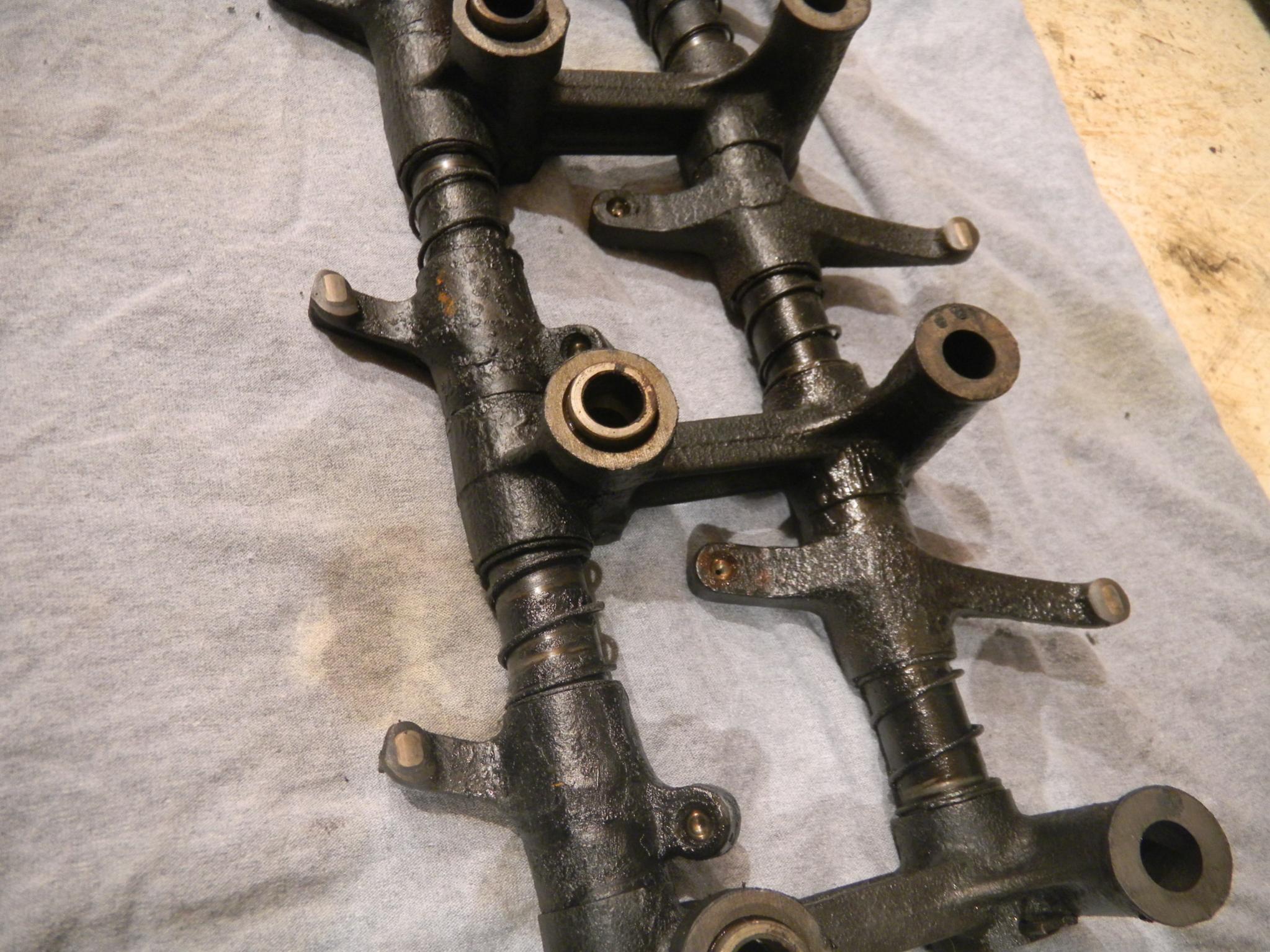

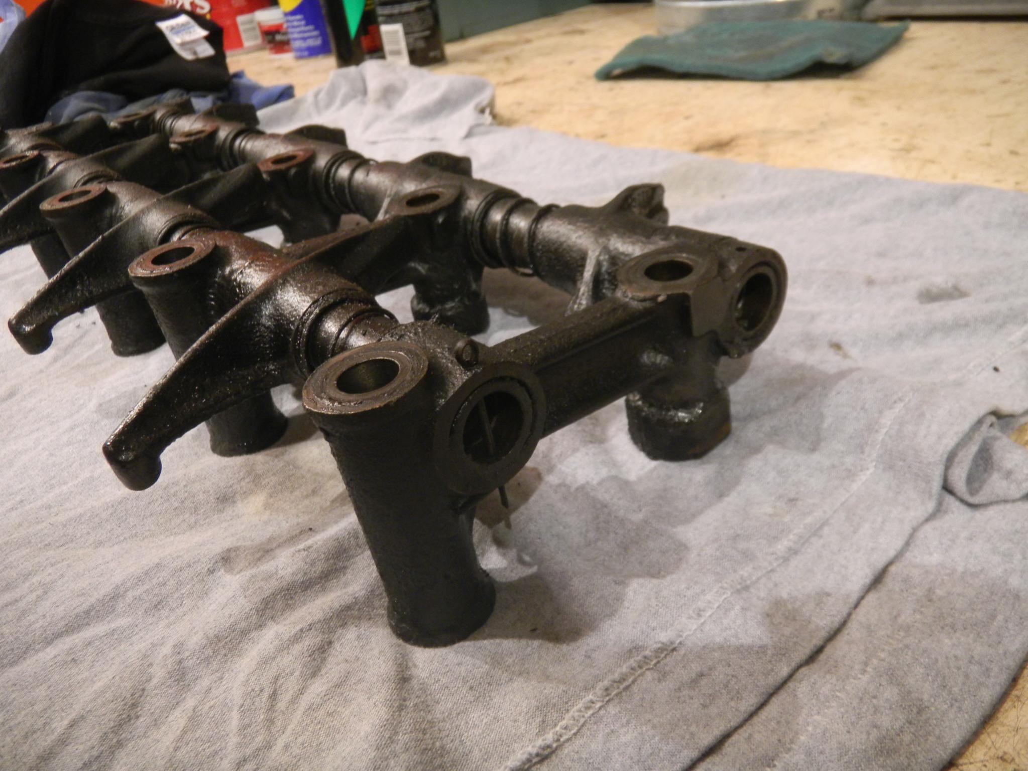

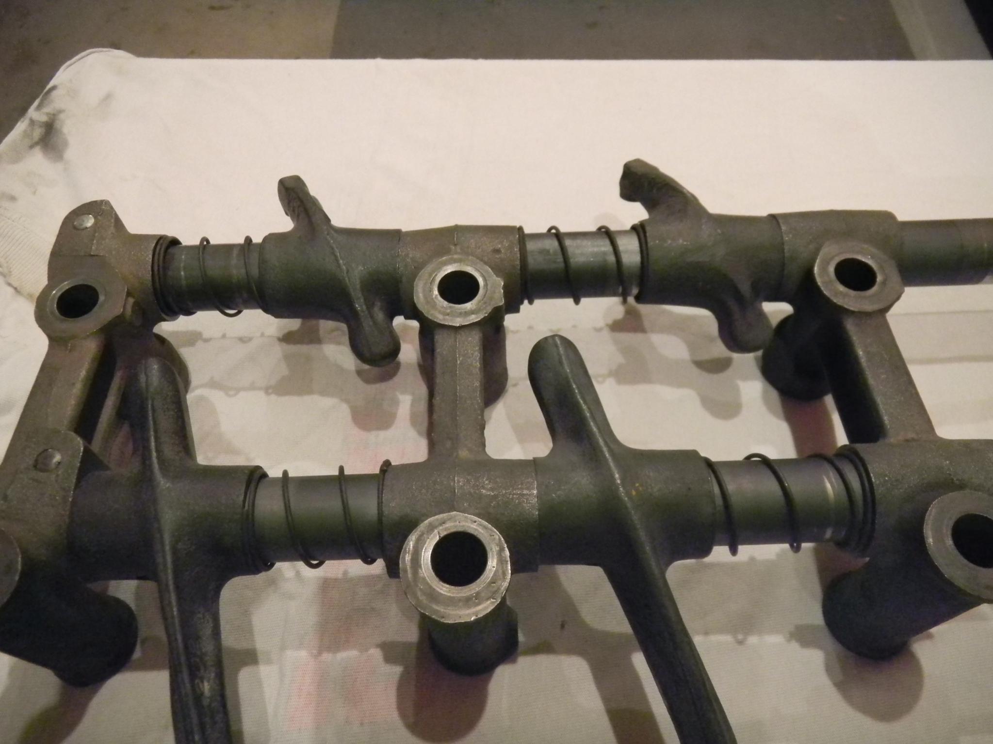

    tankwilson
    Went out and worked in the shop tonight. Finishing up the carb, got hung up on the metering rods. Need to do some more reading from the service manual.

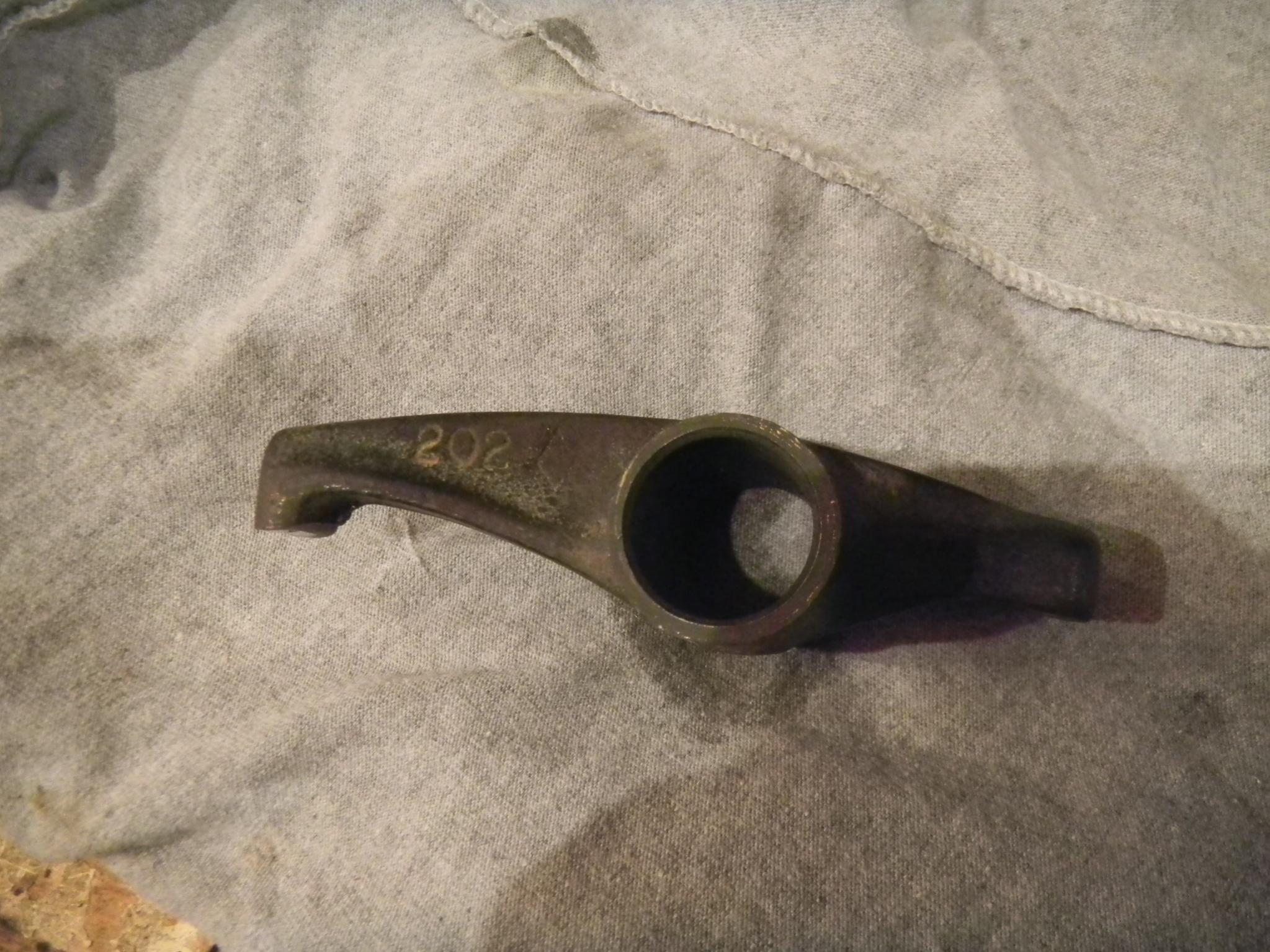

    Took apart one set of rockers also. Not sure what is accpetable wear and whats not. Have to have Gary (73RR) or any of you other experts chime in.
    Take a look at the pics.
    Not sure if they are suppose to have two cotter pins or not... if so mine was missing one.

    As to the rockers ***emblies, first order of business is to get the sludge and varnish off so you can better see/feel what is there.
    Easy way to clean is just throw the whole mess in a hot tank (remove the shaft end plugs first), but if not an option then use lots of solvent and a scotch brite pad. Use caution though, a fresh scotch brite pad is abrasive!!!
    •A casual look will tell right away if any galling has occured due to lack of oil. If the shaft is damaged then the same will be in the rocker.
    •Check each rocker location on the shaft for ridges; run a finger nail along the shaft. If a ridge exists then that rocker will not likely be round.
    •The tips of the rockers will wear as they beat on the valve stem tip. Less oil = more damage. Loss of oil to the lifter will cause speed up the process.
    Some folks will run worn rocker ***emblies and get by. You will be the one to decide how much damage you can live with and whether or not a proper rebuild is in the financial picture.

    As said, take the rockers apart and clean them good for inspection. Hard to say for sure from your pictures, but the shafts look borderline. When I resurface the rocker tips, I try to avoid any that have much more wear than yours. You can get away with a spot or two inside the rocker arm pivot, but the shafts need to be smooth. It is impossible to polish a galled shaft and have it within specs, (physics) which is why companies like myself offer hard chromed shafts.
    Did your machine shop sonic check your block?
    Chrysler rockers usually have 2 cotter pins. Most of the Desotos I have seen only have one. They are basically used to keep the ***emblies together before bolting them on the engine.

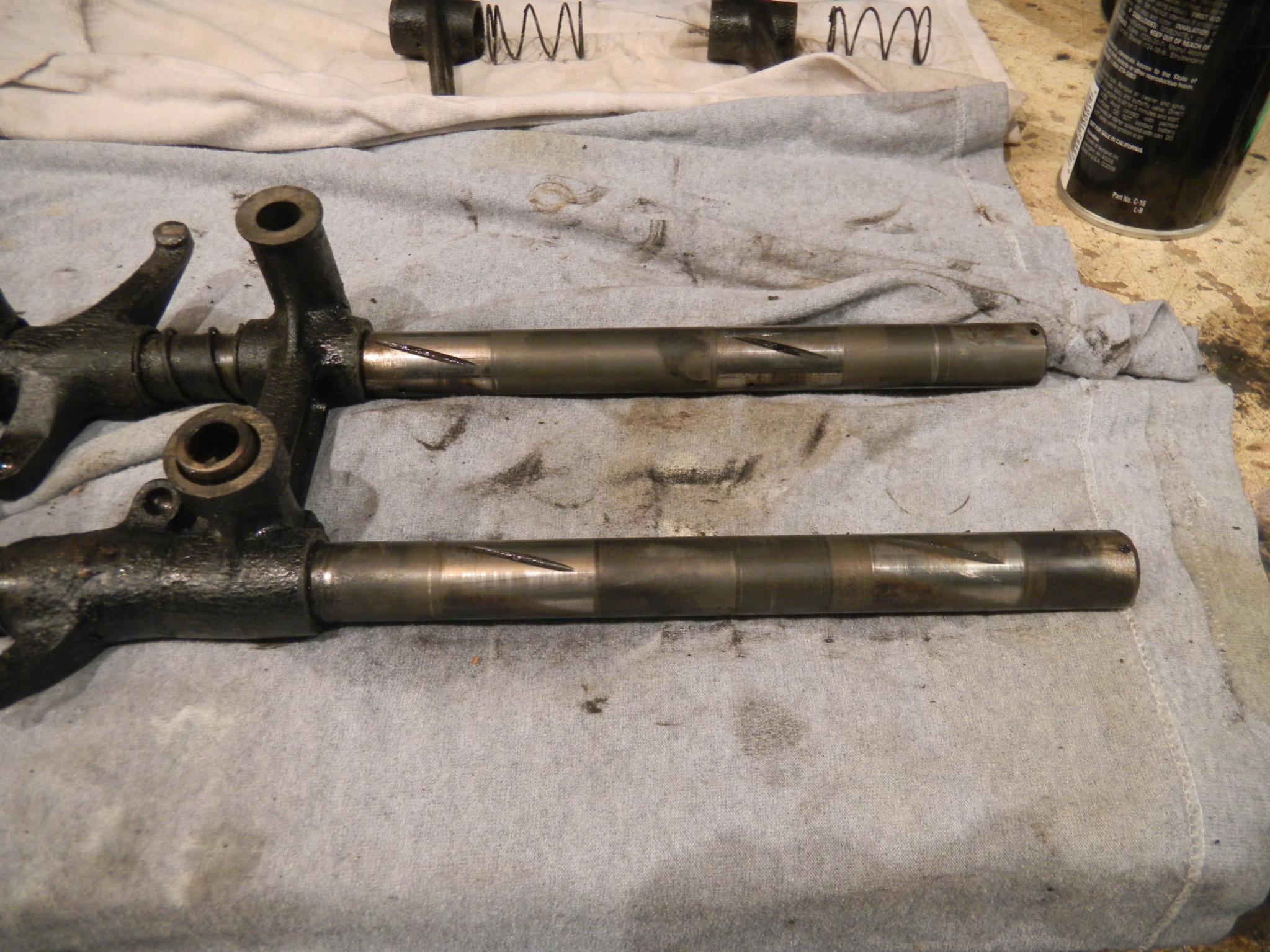

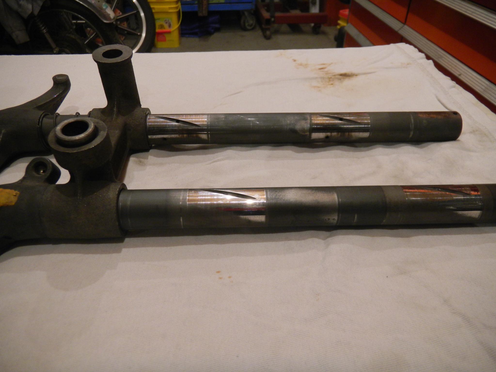

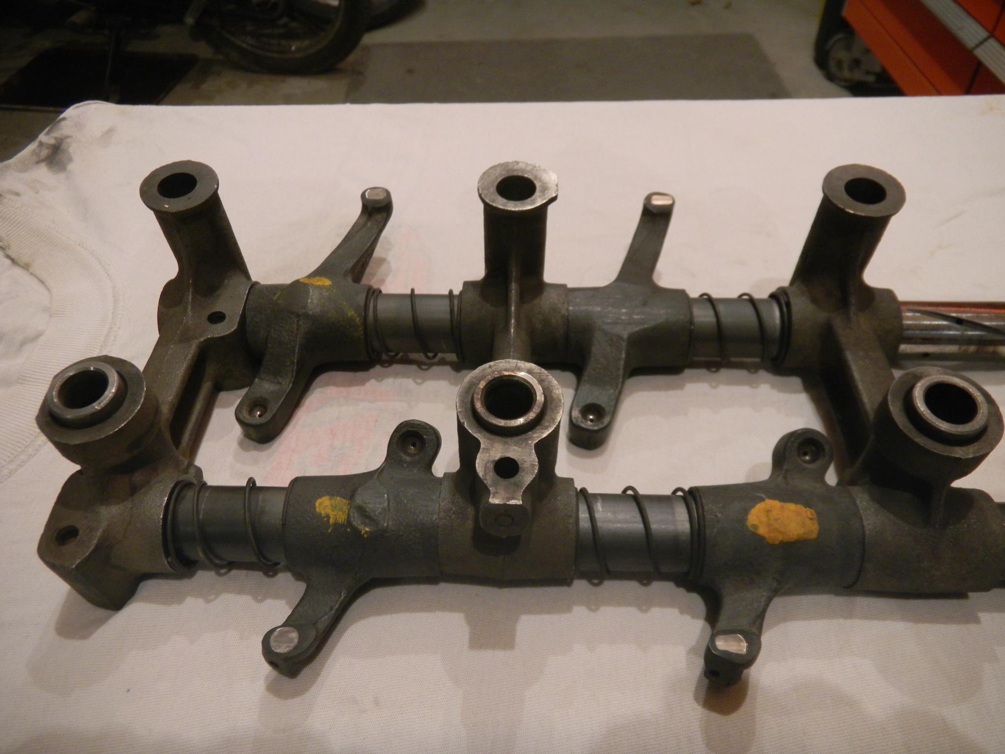

    Just spent some time cleaning the rockers.... take a look and see what you think. They are probably boarder line. They "feel" good by hand. I dont want to, but will probably spend the $$$ and get them or buy rebuilt ones. I hate to half *** anything and would rather do it right the first time. Let me know what you experts think.

    :confused: I'm no expert, but the shafts look better in those pictures. I would say you have a rebuildable set of rockers. I would use them.

    The tops of the shafts are perfect.... the bottoms have wear where the rockers sit. the rockers dont have alot of slop when checking by hand on the shaft.
    Im seriously thinking about using them to keep some of the costs down, but dont what to skimp either.

    The rocker to shaft clearance is listed as .0014 to .0027.
