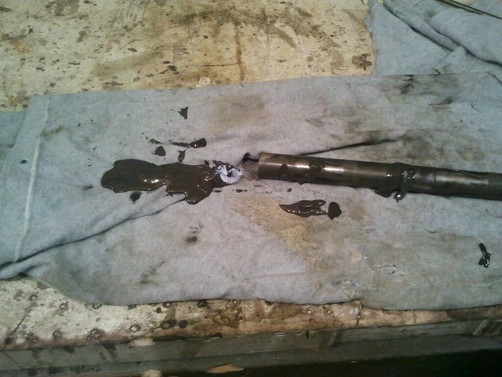

  19. tankwilson
    Joined: Oct 12, 2004
    Posts: 1,161
    tankwilson
    This is why u knock out the plugs and clean the inside of the rocker shafts
    Sent from my DROID device using the TJJ mobile app
  20. 73RR
    Joined: Jan 29, 2007
    Posts: 7,342
    73RR
    ...sometimes the **** isn't even in a liquid form...
    Hey, it ran real good when we parked it, just fire that baby up...:eek:
  21. tankwilson
    Posts: 1,161
    tankwilson
    Get a can of carb cleaner, roll of paper towels, and ur gun cleaning kit and put on dark side of the moon. When the album is over then it might be clean
  22. tankwilson
    Posts: 1,161
    tankwilson
    Cleaning the rocker posts. Make sure u spend extra time on the one that has oil p***ages. Just when u think its clean.... clean it again.

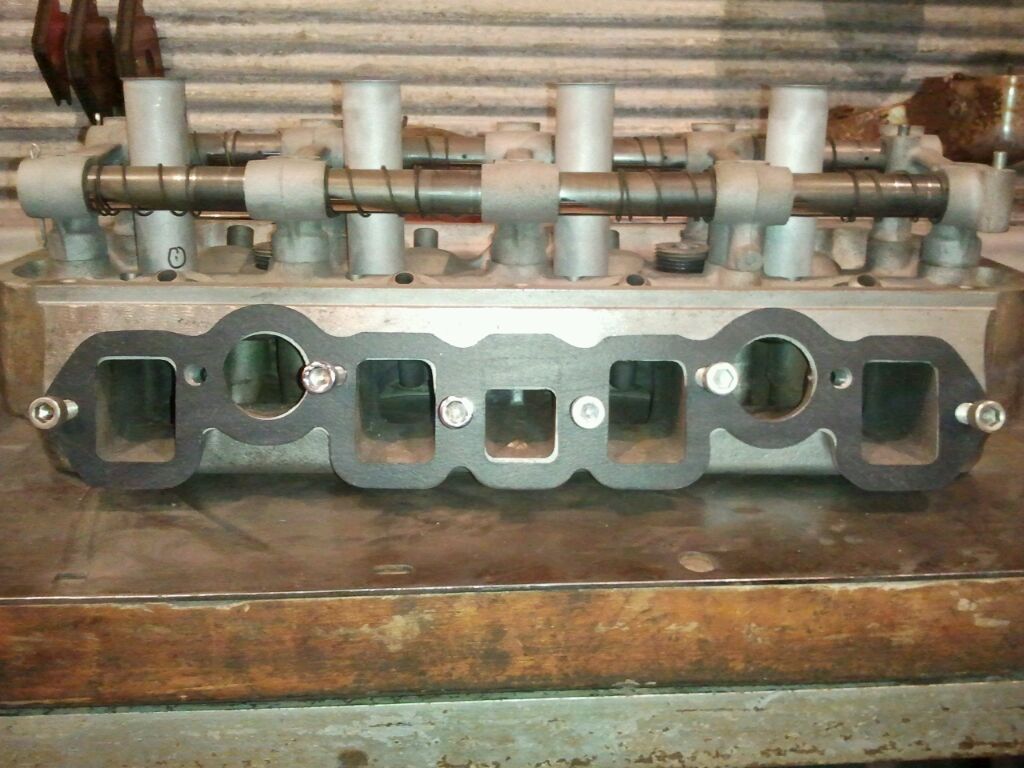

    Got my gaskets today.
    So how do I "gasket match" ? Set the gasket on the head. Mark it. Grind to match gasket? What about the part of gasket that overlaps the hole? Exacto knife?
  28. George
    Joined: Jan 1, 2005
    Posts: 7,994
    George
    Yeah, & hope the gasket is right....

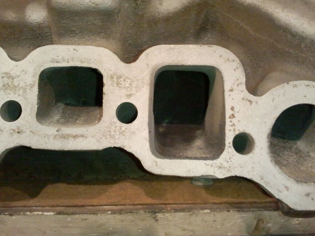

  29. tankwilson
    Posts: 1,161
    tankwilson
    I just bolt on the intake and shot some paint down each runner painting the intake where the ports don't line up. U can see bout a 1/16" mark on the left side.
    Im thinking I will clean/open up the ports a little to help better flow.
    Does this sound right? Im not gonna go crazy but would like to match a little better
  30. 73RR
    Posts: 7,342
    73RR
    I'll take a slightly different approach on the 'need' to do much of anything considering that this is intended to be a daily driver.
    You have ports big enough to throw a cat through which means that velocity will be on the low end when the rpms are in 'cruze-mode' so making it even easier for the air to move may not be the best course of action. Keeping the air churned up a bit will help keep the fuel in suspension rather than letting it fall onto the floor of the intake.
    Any gasket protrusion or port mis-match just might be a good thing.
    my 2¢ ...other opinions will differ.
