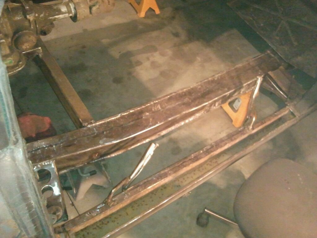

    Decided to cut out most of my floor and build a new sub floor structure and a new floor. So much for having this done for torque fest. New deadline is gonna be Greaserama. Come see it there. (I hope)

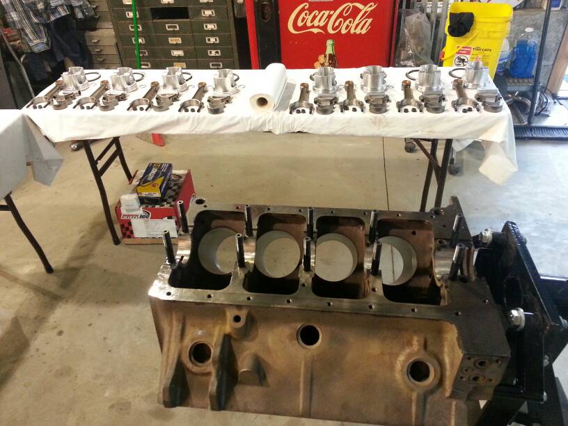

    Well its been awhile. Kinda got side tracked for a bit. Was waiting on pistons use to be my excuse....not no more. These are the most beautiful pistons ive ever seen. Special thanks goes out to gary (73RR)

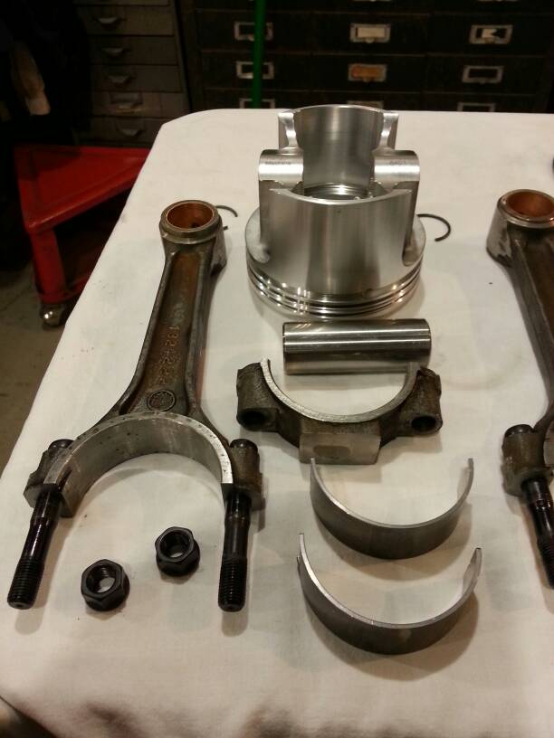

    Not sure if you guys can see this but follow the link and take a peek at the first three pics. I got all my parts and pieces back from the machine shop and going through it all. Most everything looks great except for a couple of parts. They told me they had a heck of a time installing the cam bearings, but finally got them in and fitted. I did notice that there appears to be some marks or "dents" on the face of the bearings. Appear to be from installing and removing several times. Is this something to worry about or no?

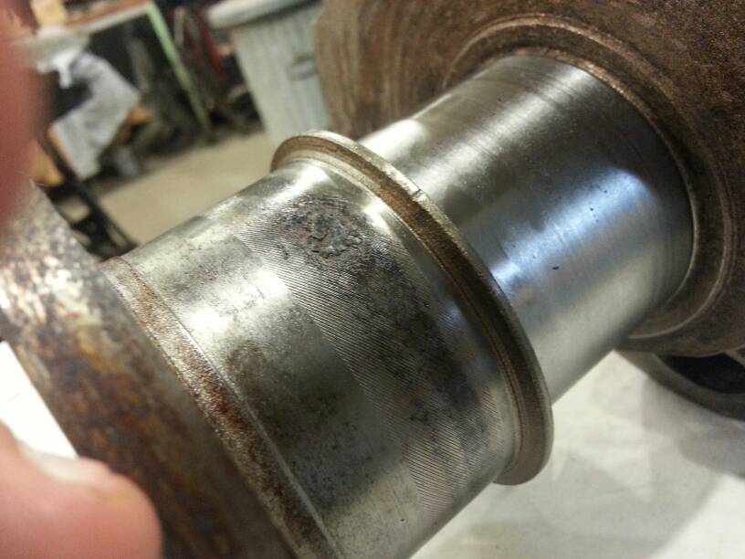

    Also I was inspecting the crank last night and noticed a rusty and crusty spot on the part were it contacts the rear main (I think). What can I do about this??

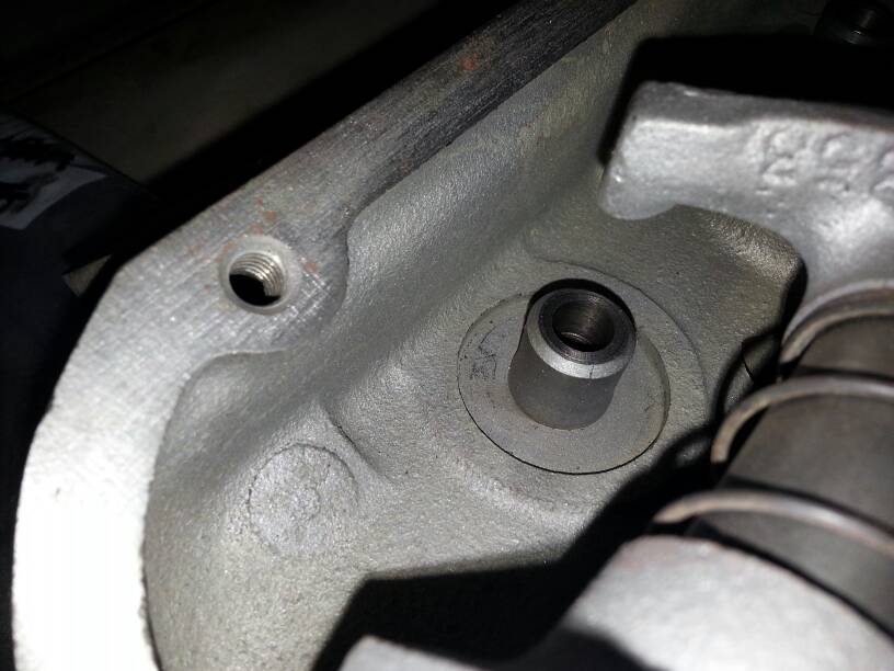

    Ok double checking everything the machine shop did.
    Heres the deal. I got new valve guides and had them install them. Looks like they drilled out part of the old ones and pressed in the new ones. Had a buddy help me take all the valves and springs out so I can make sure everything is clean. After doing so I noticed that the thin wall of the original guides had a crack in almost every one. Is this going to be a problem in the long run. Take a look and let me know. The crack is in the old guide only not the new ones.
  19. gatz
    Joined: Jun 2, 2011
    Posts: 2,272
    gatz
    They got too much of a "press fit" between what was drilled (reamed?) and the O.D. of the new guides. Hope they used something more than a hand drill to open those up.
    There isn't any load to speak of that would force those in or out of the head; but still, a quality job was not done.
    You'll have to decide if that's what you want in your engine.
    I'd visit the shop and diplomatically bring the topic to discussion, and see if they'll redo them..
  20. tankwilson
    Joined: Oct 12, 2004
    Posts: 1,161
    tankwilson
    So whats my options guys? Run them or try and get them fixed?
  21. slammed
    Joined: Jun 10, 2004
    Posts: 8,150
    slammed
    Fix them. Peace of mind will come with all your double/triple checking of everything.

    Wow. I just went thru the whole thread. Based on your recent posts, are you going to have everything rechecked? Some thoughts:
    1 - Crank. Did the machine shop do anything to the crank? That main journal does not look like something I would put a set of bearings on. Looks rough to me. And the surface for the seal? Is that rust or crud? Did you have balance of the ***embly checked with the new pistons? If not, did you weigh the new pistons and compare that weight with the old? Some of these replacement pistons are 100 grams heavier than the factory pistons.
    2 - Deck surface. Looks rough to me. The following is from a rebuilders site "Another dimension that needs to be mentioned but often receives little attention is waviness. Waviness ("WT") refers to the subtle undulations in the surface left by milling or grinding operations. One reason why nobody in the aftermarket pays much attention to OEM waviness specs is because it takes a very sophisticated and expensive profilometer to accurately map it. So people tend to ignore it. Yet waviness can cause problems if it is beyond the acceptable range. According to Fel-Pro, the maximum acceptable waviness height is .0008˝ (.020 mm) for peak spacing greater than .100˝ (2.5 mm), and .0005˝ (.013 mm) for peak spacing between .030˝ and .100˝ (0.8 to 2.5 mm). Waviness peak spacing should be no less than .030˝ (0.8 mm)."
    I would use a depth mic to see where you are at. If any wave is >.001" I wouldn't even ***emble it with coated composite gaskets.
    3 - Guides. If the guides are straight, they are thick enough to support the valve, and the valves are sealing, the guide itself will probably be OK. But, you need to remove the old guide from anywhere it's exposed (and cracked). Otherwise, that old guide remnant will come apart at some later time. You will then have to get seals to fit that new surface. I had this happen to me on a set of heads that I sent out. After talking to the guy for 5 minutes, I realized that he had no idea what he was doing. Think about it... If he sent it out like that he has no idea of what he's doing.
    4 - Ring gaps. Want it right? Top ring gaps should be within .001" of each other in the recommended spec for that land.
    Good luck,
    My 2 cents,
    Dan

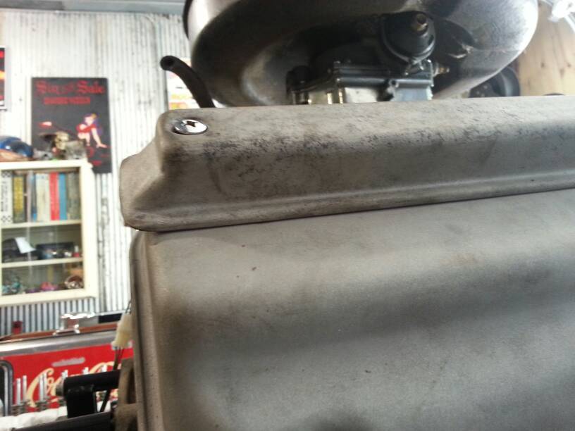

    Hey guys I would like to find a couple more stock parts. Anyone got a stock oil dip stick ***embly? Also looking for one stock plug wire cover?

    Yea I bought a set off ebay but the end was different and it was little longer than what I want. This one will work but needs some metal work

    The ones on ebay have the bend start at the top and hang off the end of the valve cover about an inch. Looks kinda chessy. The original one I have is the one in the pic. I got a second one but the other end is messed up a little. I can prob fix but would be easier to buy one.
