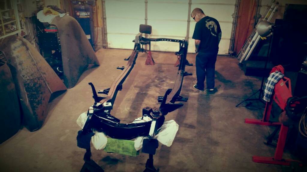

  16. tankwilson
    Joined: Oct 12, 2004
    Posts: 1,161
    tankwilson
    Frame is painted. Front suspension done. Brake lines ran.
    [​IMG][​IMG]
    Sent from my SM-N920R4 using The H.A.M.B. mobile app
    dwollam and biggeorge like this.
