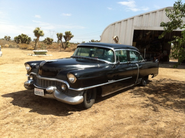

  7. matttupp84
    Joined: Sep 11, 2013
    Posts: 8
    matttupp84
    from louisiana
    Here's a couple. PM your email if you want some more.
  8. matttupp84
    Posts: 8
    matttupp84
    from louisiana
    One more.
