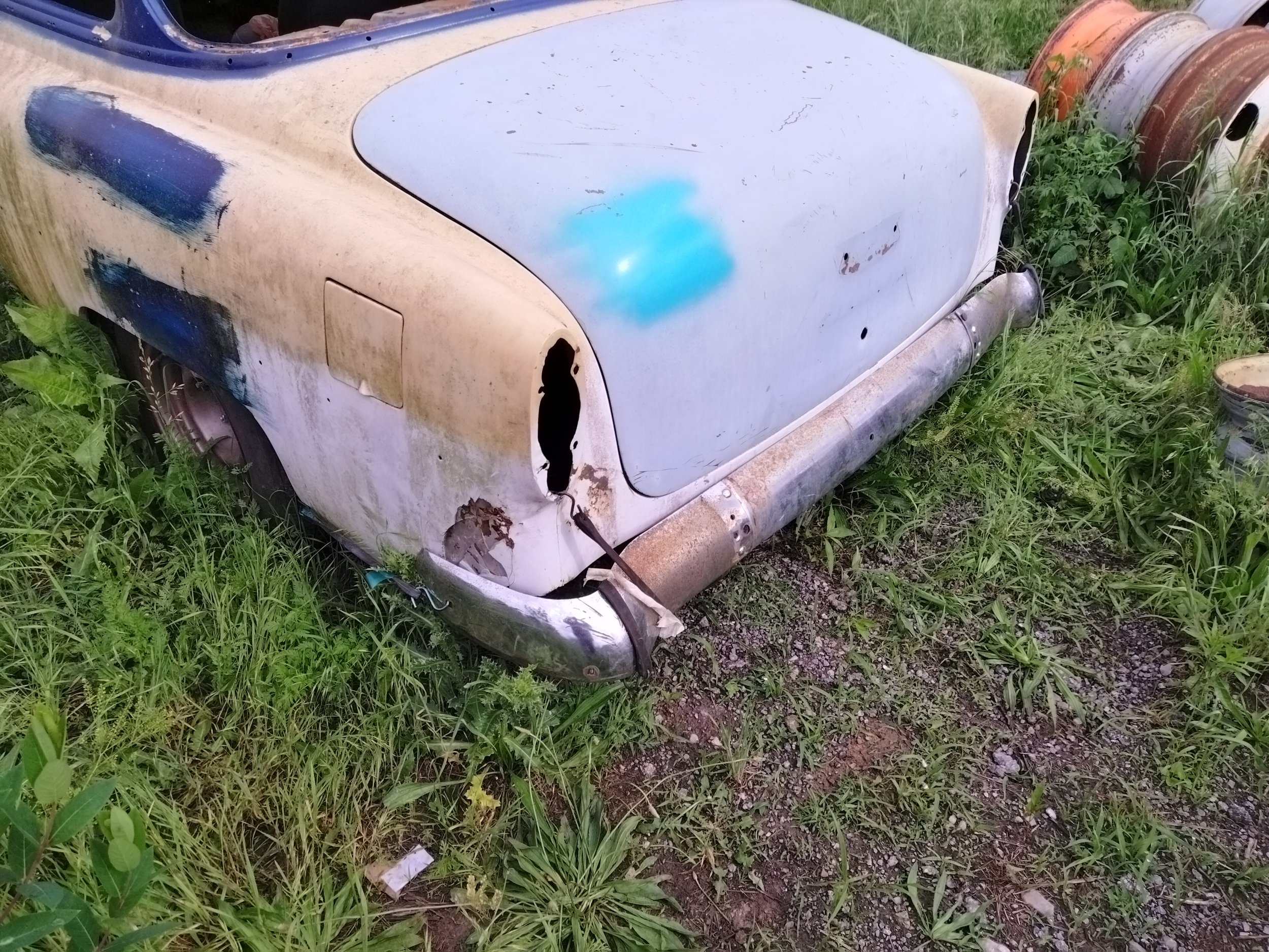

  1. And using highly specialized mockup tools I'm able to get an idea of the look lol. Thinking I'm going to move it rearward an inch or so and use a very narrow splash pan. Also thinking I'll extend the quarters to better match the shape. It'll keep 54 tail light bezels though. Overall I'm happy IMG_20250529_164048_HDR.jpg

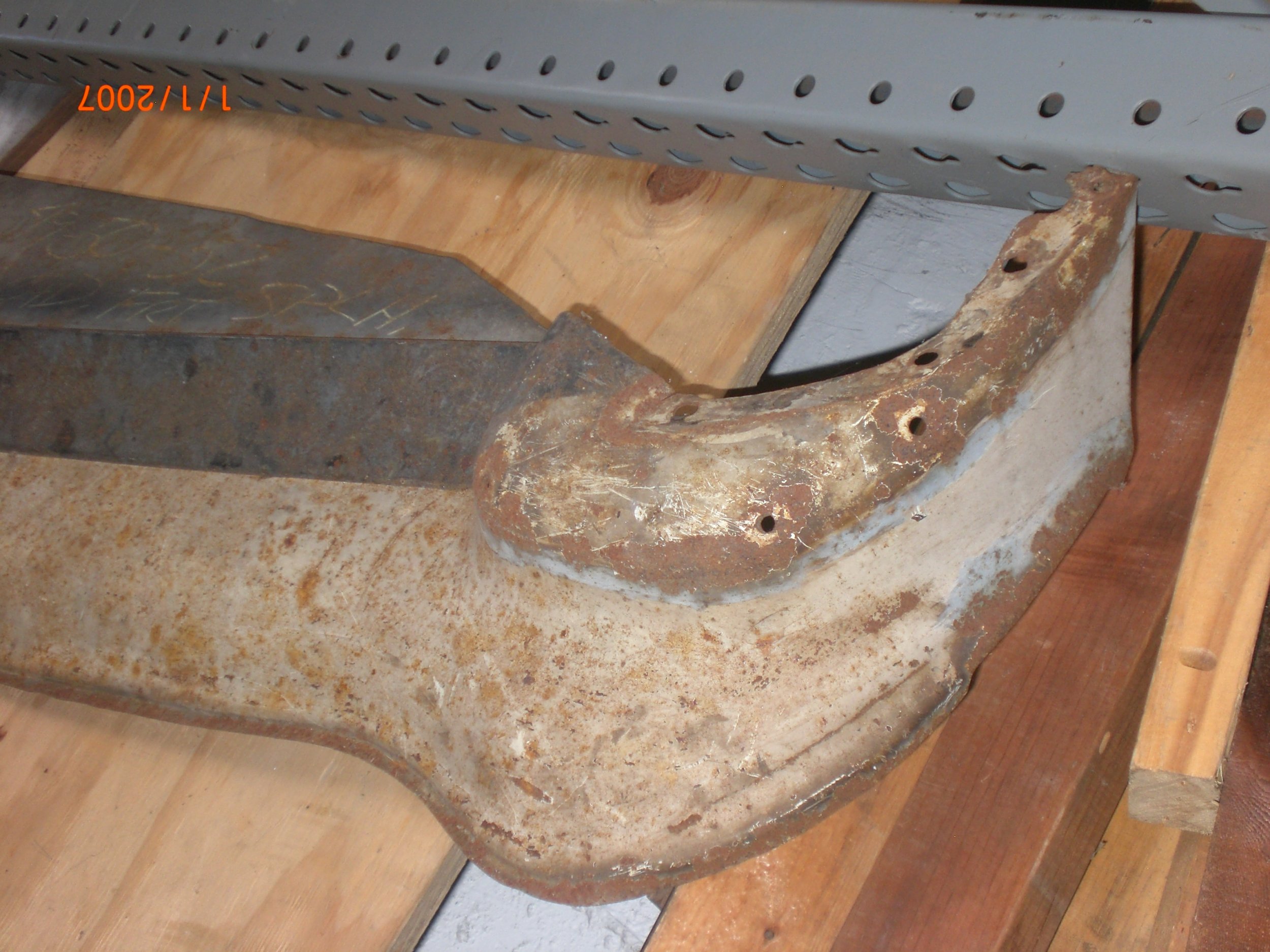

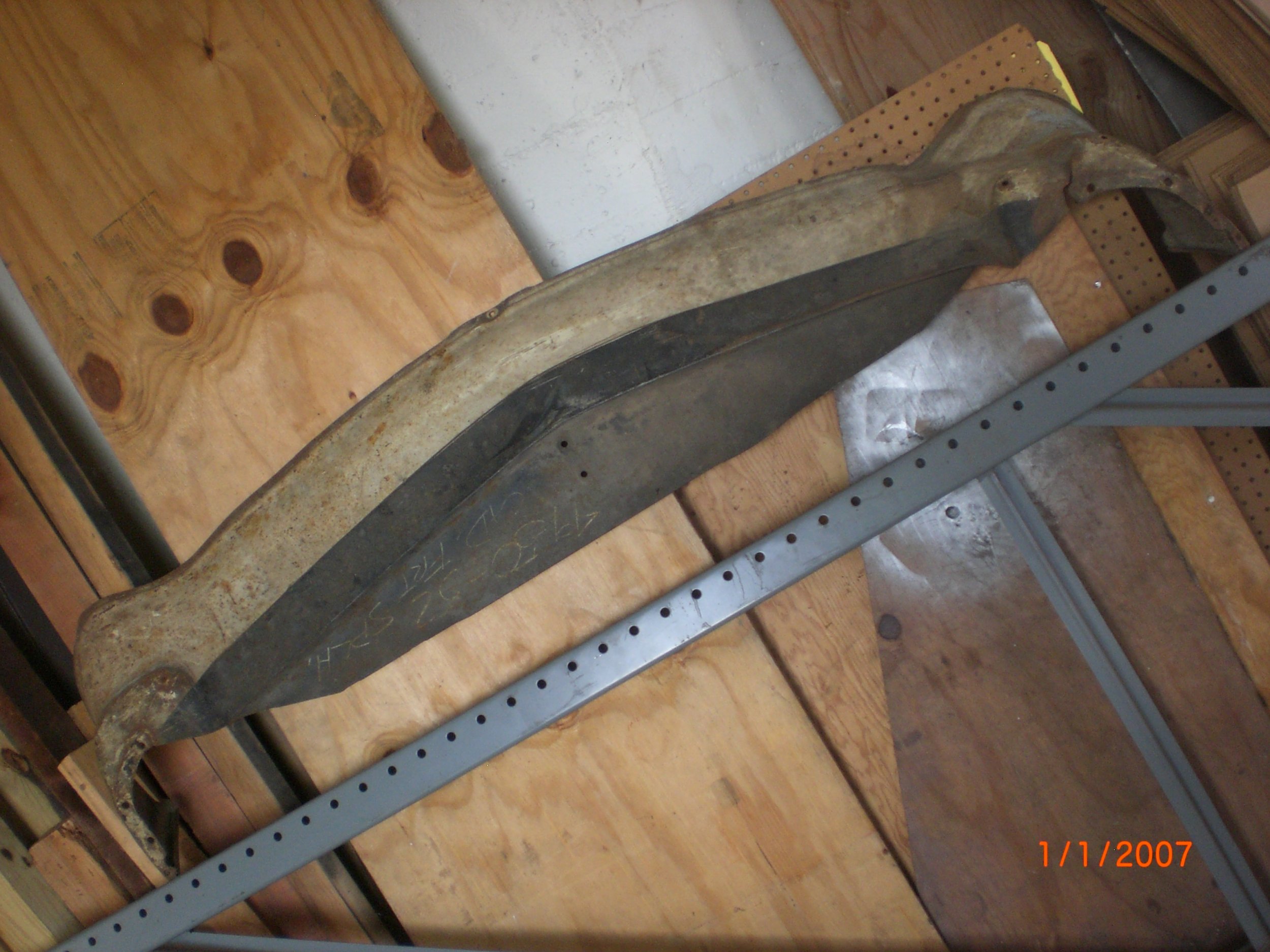

  3. And to piggyback off my latest post on my 53. I'm wondering how different a 53 and 54 splash pan actually are. I'm not likely to luck out on a near mint splash pan for this car like I did on my 53. And the mounting on the original pan on my 53 is rough enough I wouldn't feel bad butchering it. If I can get it to cleanly bolt to the 54 I can build the sections to meet up with the humps in the 54 bumper
    Okie Pete and The Chevy Pope like this.
  5. Ah so there is a good bit of difference. I'd be interested if I wasn't currently broke lol

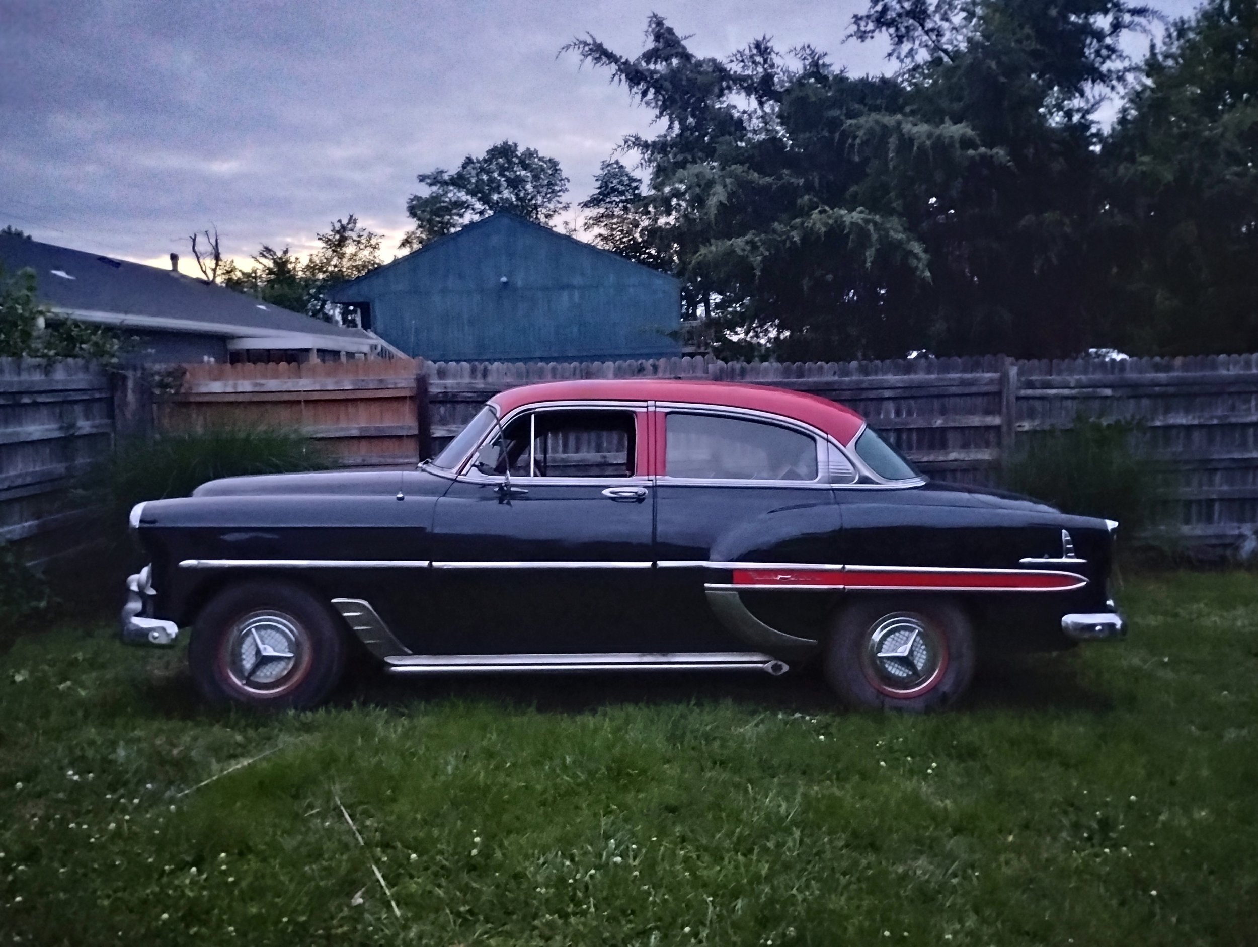

  10. Sitting in my back yard smoking looking at my 53 I got to thinking about my plans on the 54. One thing I've always thought on 53/54 Chevy cars is they have a bit of a stubby ****. Lol. I've seen guys overcome that look by chopping the top.....but that's not something I want to do
    even though the 55 rear bumper will actually fit a bit closer overall it should help with that. What should Really help is my plan to extend the quarters to better fit the 55 rear bumper humps while still retaining 54 tail lights. The added length on top of the fact due to the shape of the quarters to tail lights will be lowered a half inch to an inch should do a lot towards evening out the 54s tushie lol IMG_20250605_205445857.jpg
