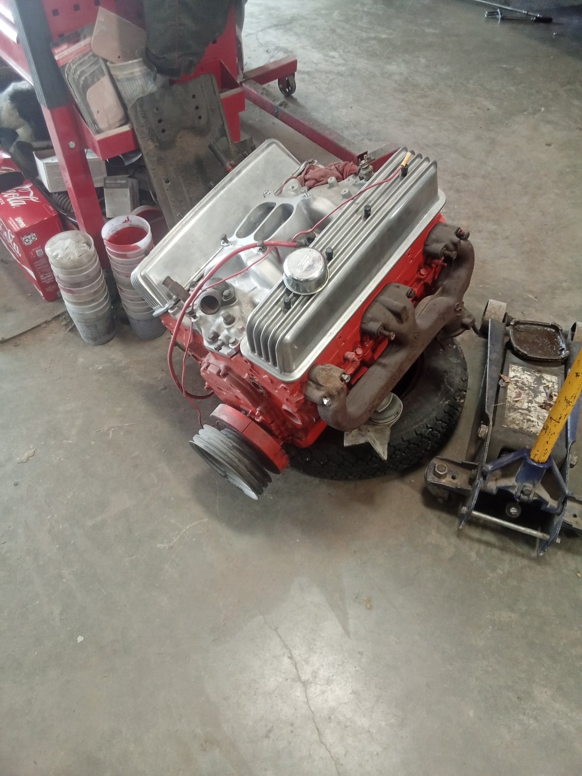

  3. Tried to turn the 350 over today and it would not budge past tdc. Peeked with a bore scope and found that while seven cylinders looked great number five had a good rust ring. Imagine condensation from sitting so long before I bought it. Lil brake fluid and pb blast and gently turning crank back and forth and the rust is gone and engine turns smoothly. I honestly kinda expected it from how long it'd sat. Does seem to have good compression IMG_20240412_122723.jpg
    Tim and fastcar1953 like this.
  4. And not much progress overall but progress nonetheless. Fixed the rust ring, installed the pilot bushing, swapped the breather cap for a pcv valve disguised as a breather cap (will be doing full pcv on this one), installed a new grommet for the p***enger valve cover to air filter tube, got the three groove crank pulley off, and swapped the heater core fitting for a pipe plug as I won't be running a heater on this car anytime soon, and swapped the thermostat housing for a straight ahead chrome one IMG_20240412_165220.jpg

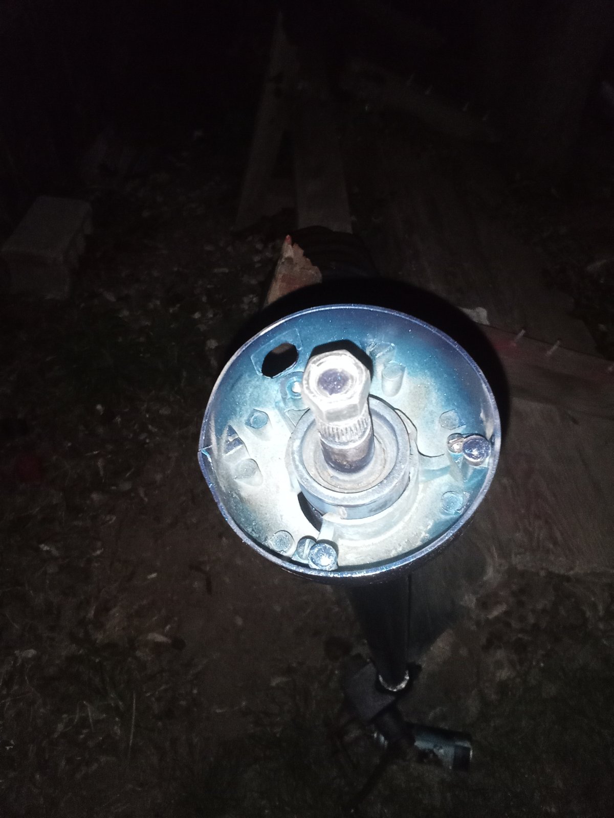

  10. And another tiny victory. An a rare example of Google being accurate lol. Steering column and box was in great shape but didn't include the bell for the factory turn signal or the steering wheel retaining nut. Happened to have the bell in my stash. But after all the GM cars I've done over the years I've never bothered to learn the thread size and count for the steering wheel nut...... usually just robbed a nut off a junk car that fit lol. Wasn't an option in this case. Googled the size and bought a locknut to see if it'd fit and bam lol. I'll throw a washer under it IMG_20240414_224145.jpg

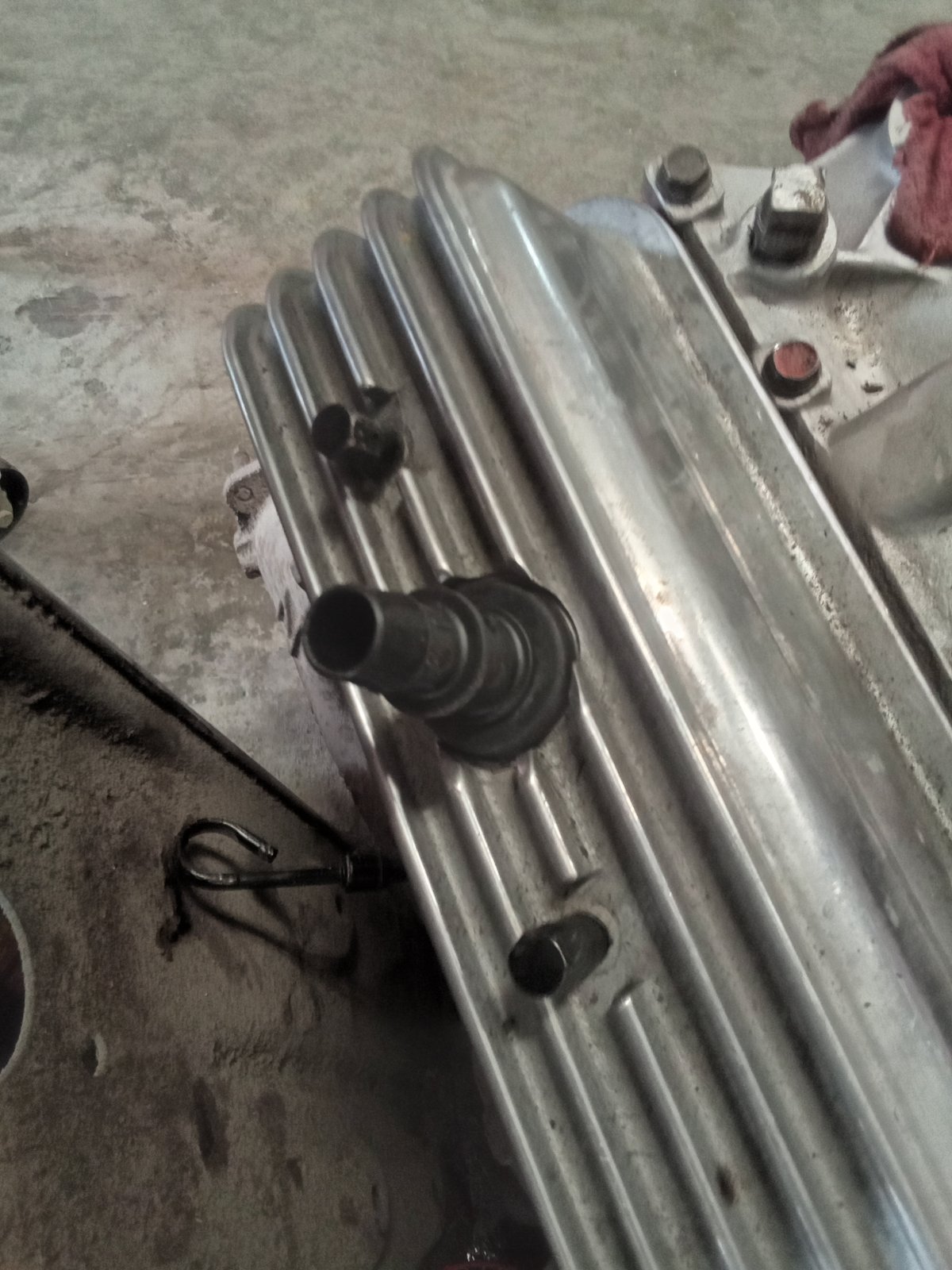

  11. And another piece sorted for the pcv. I'll put an elbow on this and run a tube to the bottom of the air filter IMG_20240415_103825.jpg

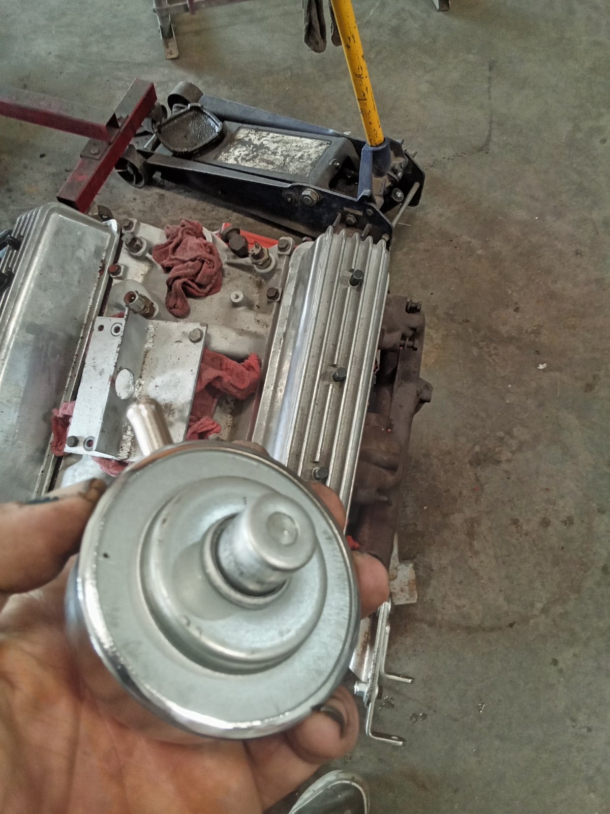

    If you are running that breather in the other valve cover, you are going to want to run a pcv valve hooked to vacuum here.
  17. The breather cap in the over valve cover is actually a pcv disguised as a breather cap
  18. Lil more visually pleasing than a standard pcv lol IMG_20240416_115916.jpg

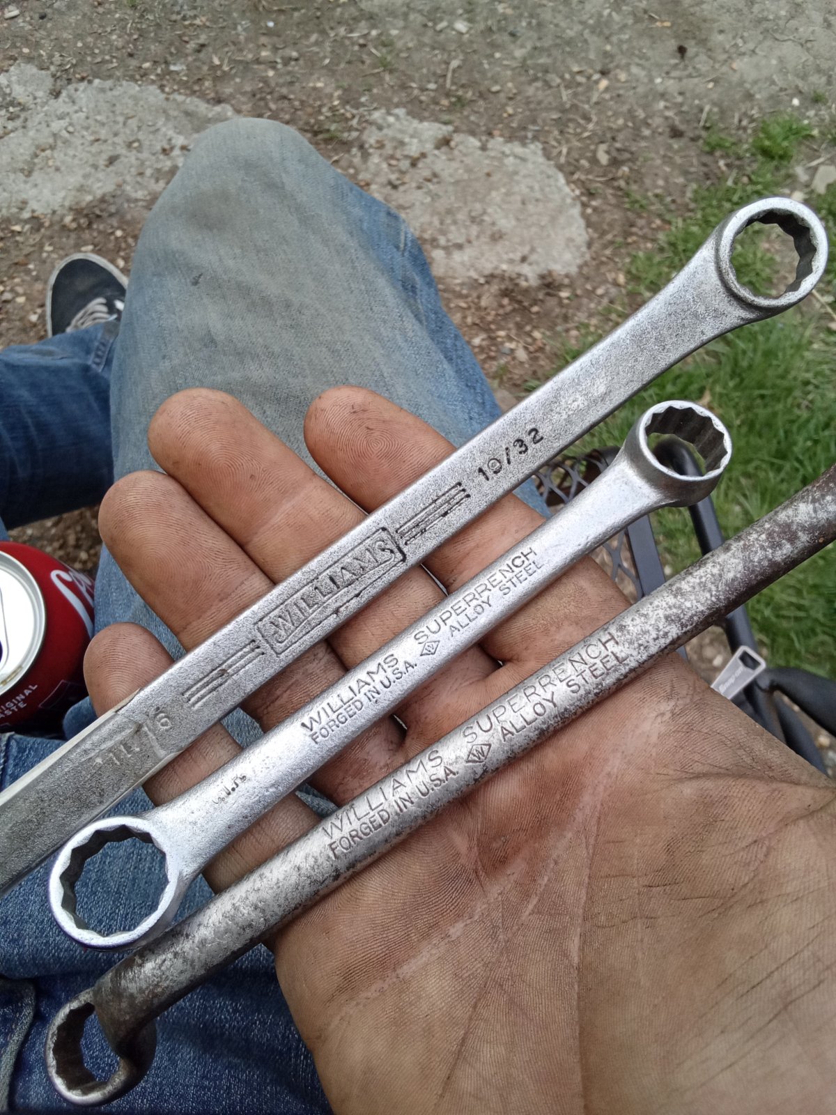

  25. Odd bit for the build. Anytime I do a car I like to do up a small metal toolbox painted the cars secondary color full of vintage mostly snap on tools. I have a snap on red Kennedy box for the 53. Still haven't gotten a box for the 54 (but I think I have one found) but I found these Williams wrenches at a flea market today. While not owned by snap on when these were made Williams is owned by snap on now. In fact most snap on dealers will warranty Williams for snap on. But yeah these are common Chevy hardware sizes so I'll put them aside till I get a box IMG_20240420_174245.jpg
