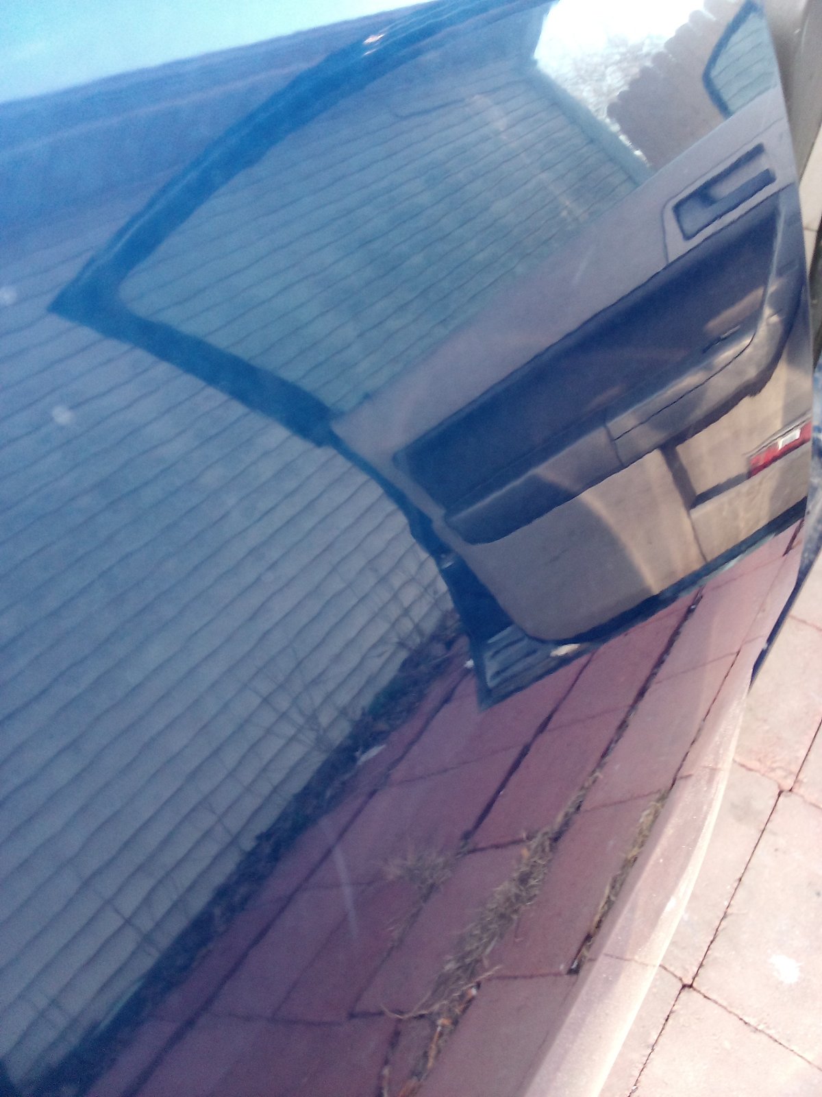

  2. Started on the other side. Hopefully have it painted in a week or two IMG_20240422_162640.jpg

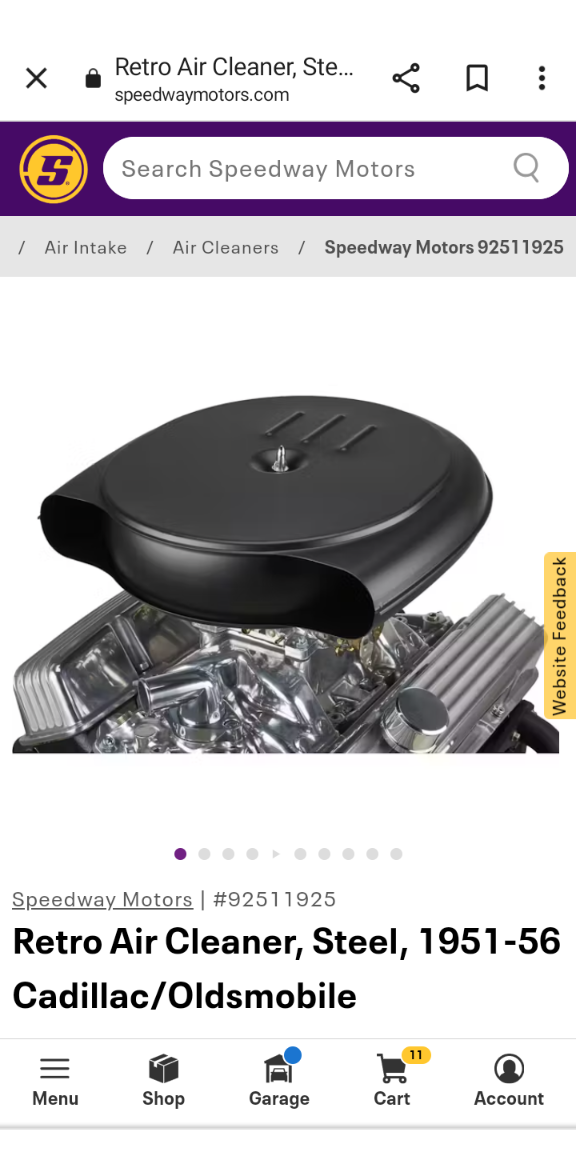

  3. So supposed to be hitting up a semi local speed shop Friday afternoon I haven't been to in a few months. Gonna try to pick up the cad/olds style breather while there and hopefully meet up with another hamb member to jaw a bit

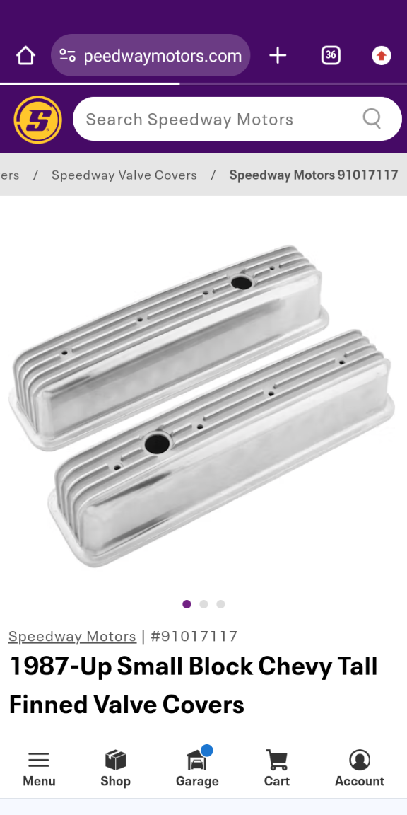

    Beware of tall, finned valve covers. Be sure you have all your accessories and brackets ready to bolt on then order the valve covers. Once they come in, bolt them on and test fit your accessories, alternator, A/C compressor. Tall covers tend to get in the way of these things. And don't believe you don't plan on running an A/C. If the wife isn't happy cruising without it, you'll be calling Vintage Air. Also, check out Summit Racing. They have the same parts, will get them to you faster, and don't typically charge shipping.
  16. Eh at this point I'm pretty sure I won't be running ac. Been with my wife 7 years and none of my personal cars have ac(four total not counting this 54....3 running). When she rode in the 53 she was shocked at how much air the wing gl*** moved at 35-40 mph. And yeah I dealt with tall finned valve covers on my 53. The alternator brackets I use clear them
