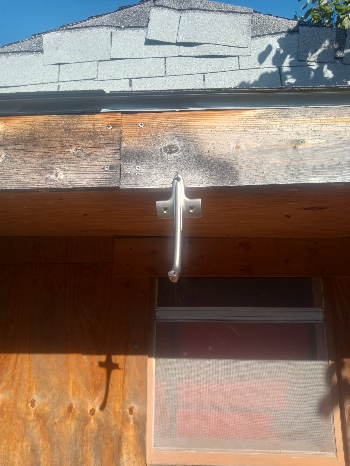

  18. Eh it works lol. Just an old shed dad and Grandpa built in 1989 that Dad added stuff to on a whim lol. Actually a nicely weather tight building

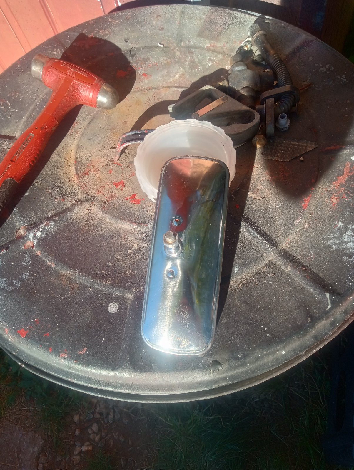

  22. Tore the worst of the two mirrors down and gave it a quick polish. Actually already looking presentable. Also this was one of the easiest mirrors Ive found to take apart and put together lol IMG_20240908_134913487_HDR.jpg IMG_20240908_140635354_HDR.jpg

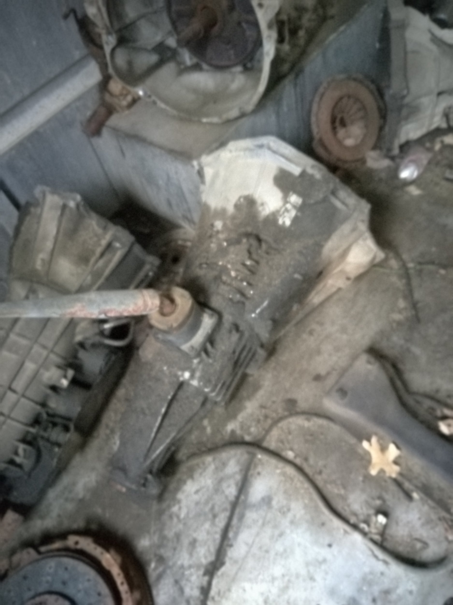

  29. Haven't officially taken possession but yesterday I officially earmarked and began negotiations on this nv3500 I've known about around 6 years now. Should be getting it in trade for a late 90s Pontiac I junked. IMG_20241127_144544_HDR.jpg IMG_20241127_144555_HDR.jpg
