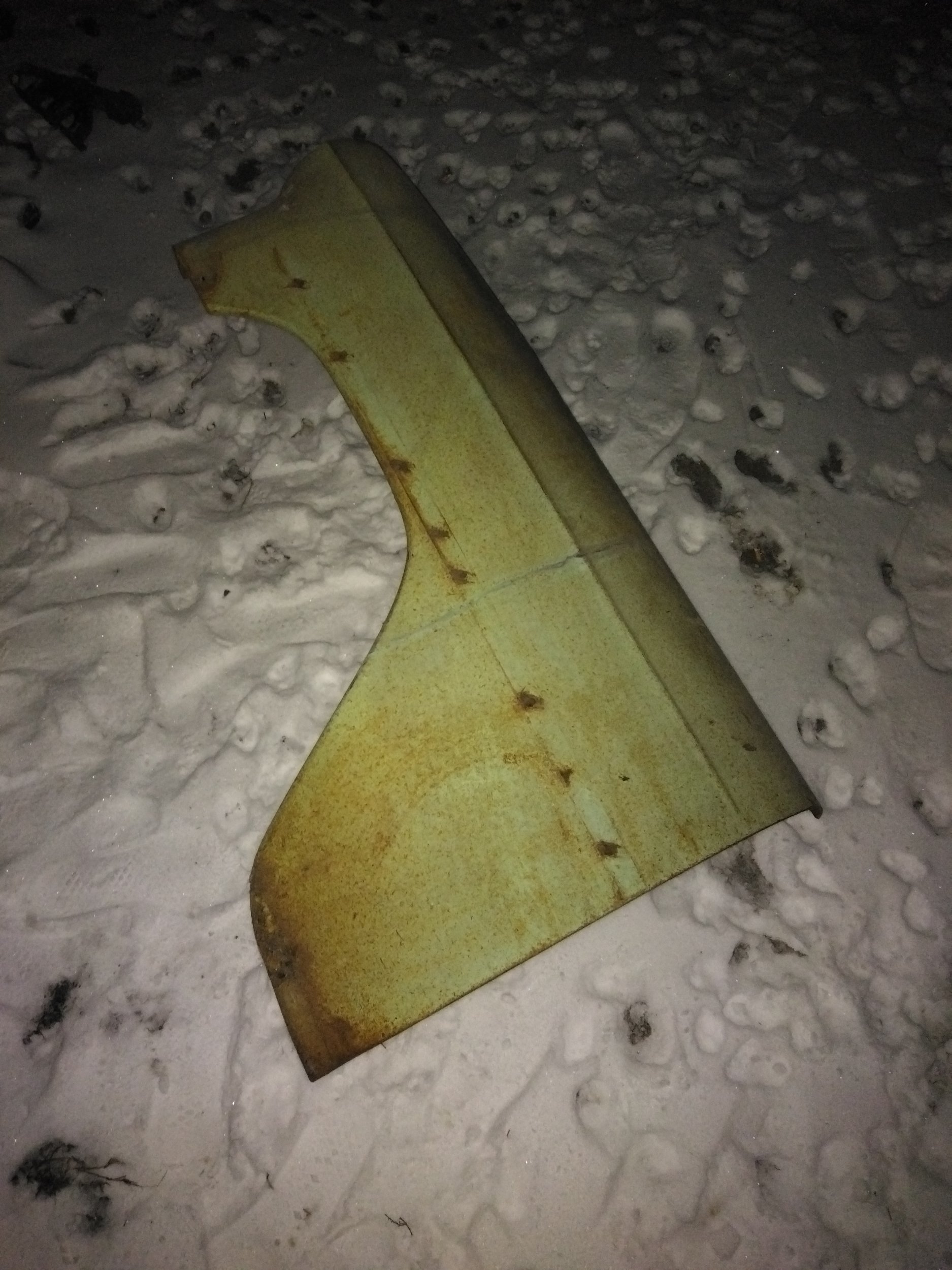

  7. And after actually getting a look at this fender in the light it's actually in really great condition. Story on the fenders for this car is I originally wasn't supposed to get them in the deal. As we were going around pulling out the parts we could haul in my buddy's pickup I asked about the inner fenders. Anyone whose heard me talk will vouch that not only do I talk kind of low I also have a bit of a hive to my talk lol. So he thought I was asking about the actual fenders. And happily threw them in. Last year I started working on the p***enger fender. Welded trim holes, started the frenched antenna, and started welding up a lil rocker rust. Just realized this fender actually has no real rust.

  8. And aside from needing a skim coat of filler the dent is gone. And @The Creature now knows how to identify highs and lows in metal and the direction to work a dent IMG_20250214_180650_HDR.jpg

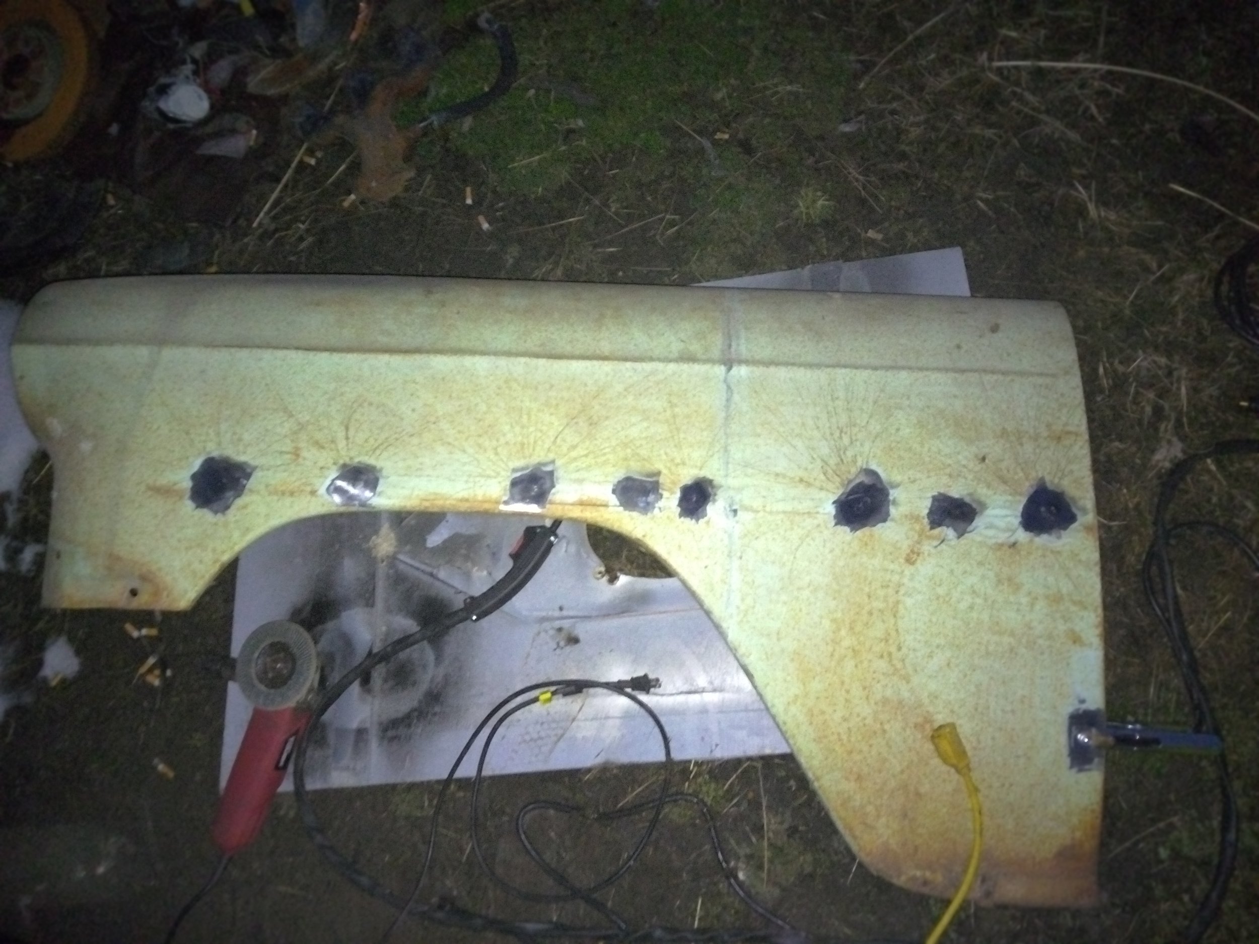

  11. Managed to get a lil work in on this fender before dark. Welded up the trim holes. Threw a coat of gloss red on to protect the newly bare metal and to use as a guide on distortion. So far I don't see any noticable distortion. Instead of my usual take the clip hardware out and slag fill the hole I just welded the hardware itself and flap disked smooth. Did go a lot faster IMG_20250223_182703.jpg IMG_20250223_184035.jpg
  12. And both sides ground. I didn't feel any distortion but still gave each weld a few taps with a pick hammer to make sure no high spots. After we sand the paint and rust off we'll get to the mud lol IMG_20250224_180429_HDR.jpg IMG_20250224_180438_HDR.jpg

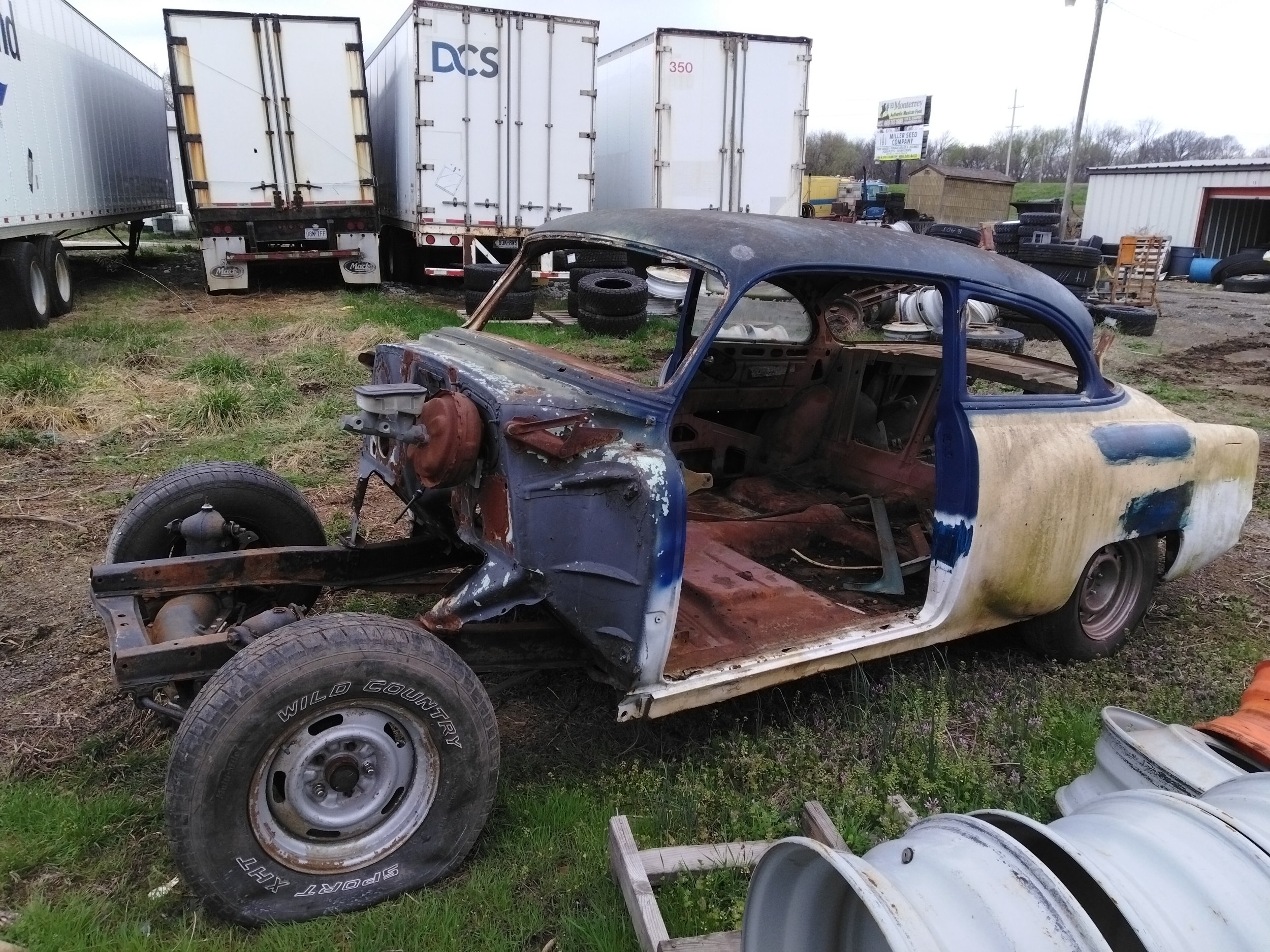

  24. This showed up today. Spent a bit getting it sort of on four wheels. Third pic shows the damage it was originally junked over before I got it. Rare a car actually looks better after you pull it out of the brush. But that's the case here. Even the tail panel was in good shape IMG_20250403_175643_HDR.jpg IMG_20250403_175658_HDR.jpg IMG_20250403_175709_HDR.jpg IMG_20250403_175717_HDR.jpg

  26. I'd hoped to have worked faster and have had it in my storage unit lol. But by the time I sort of had it on four wheels and had it positioned there I ran out of time and steam lol. And I still had to go home and weld that perch on the 53 and put the u bolts in after warranting them. Which I did lol. 54 should be inside tomorrow
