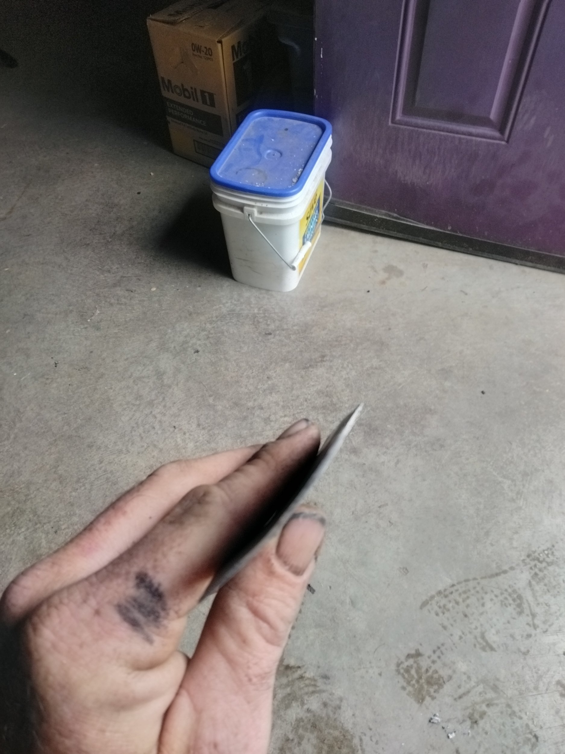

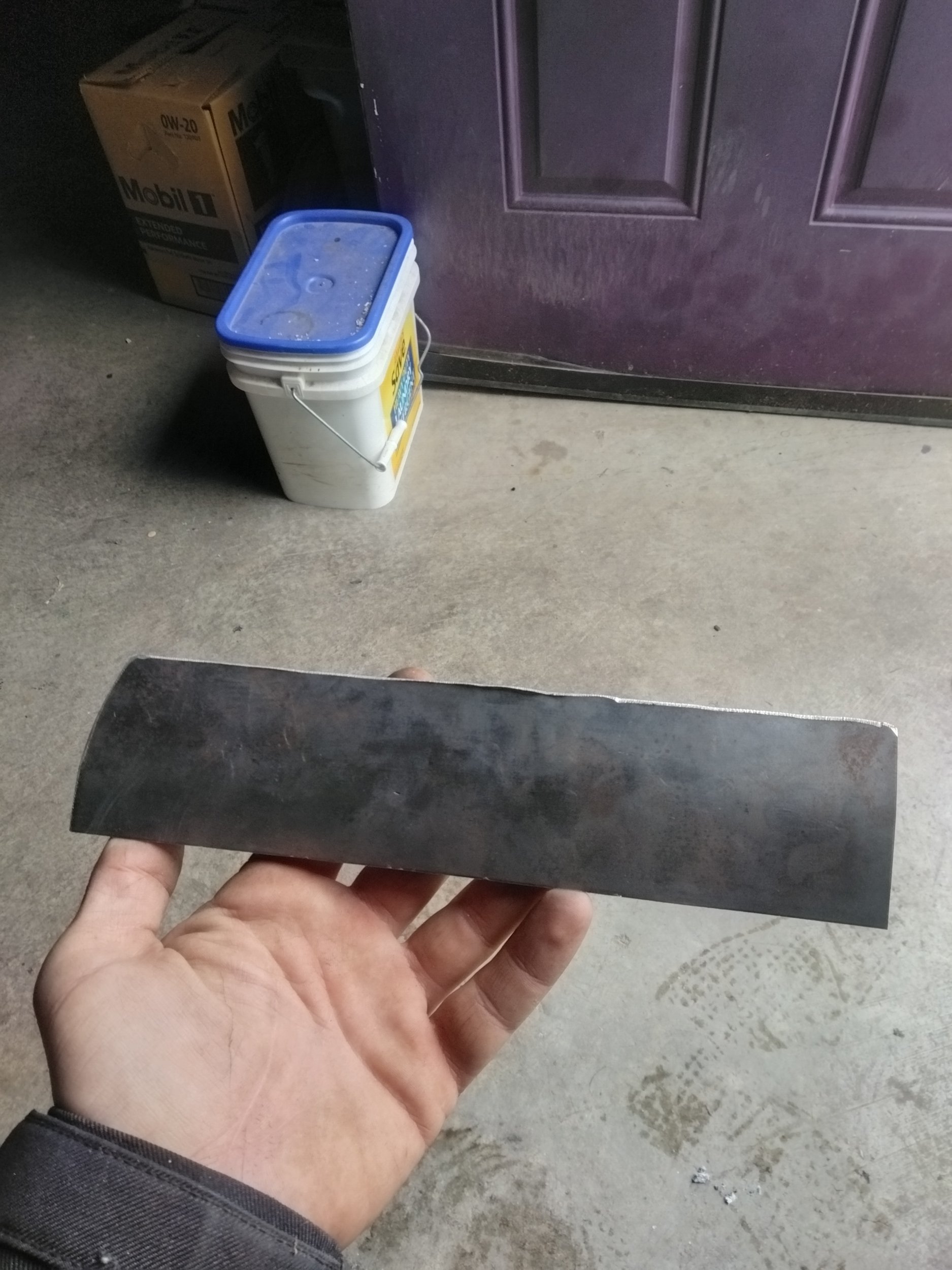

  27. And weekend wasn't a total waste. Made the first door handle patch/shaving plate. Used a spare driveshaft and a small ratchet strap to put the curve in it that I matched against the conveniently located 53. Thinking even though this area is solid on the driver door I may have it the same way as I'm thinking it'd be easier and cleaner than cutting and fitting and welding two small circles. Not to mention I could adjust the door gap at the same time IMG_20250427_123045_HDR.jpg IMG_20250427_123104_HDR.jpg
