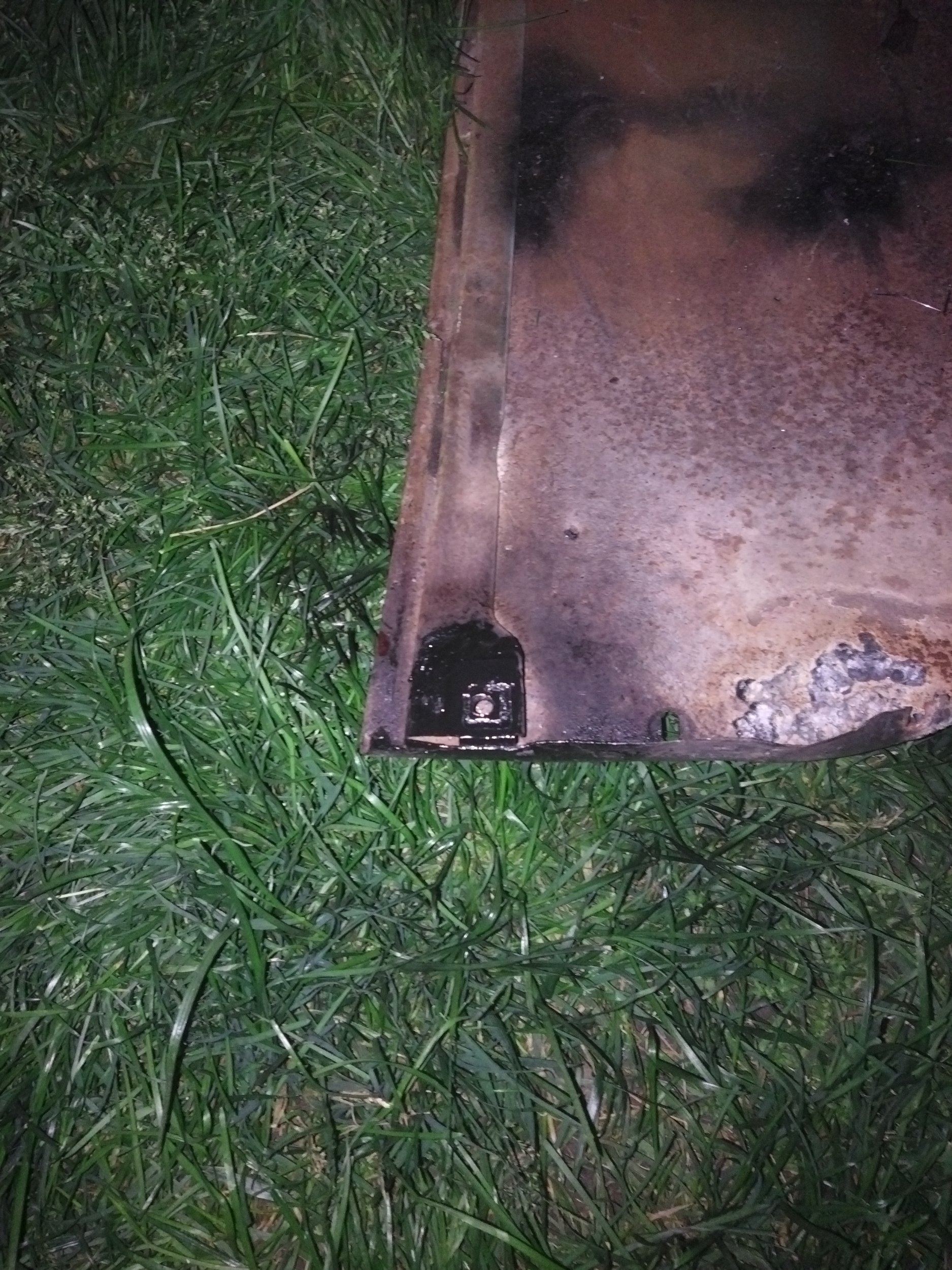

  2. See? Lol. Still some work left on the tail panel IMG_20250409_161049_HDR (1).jpg

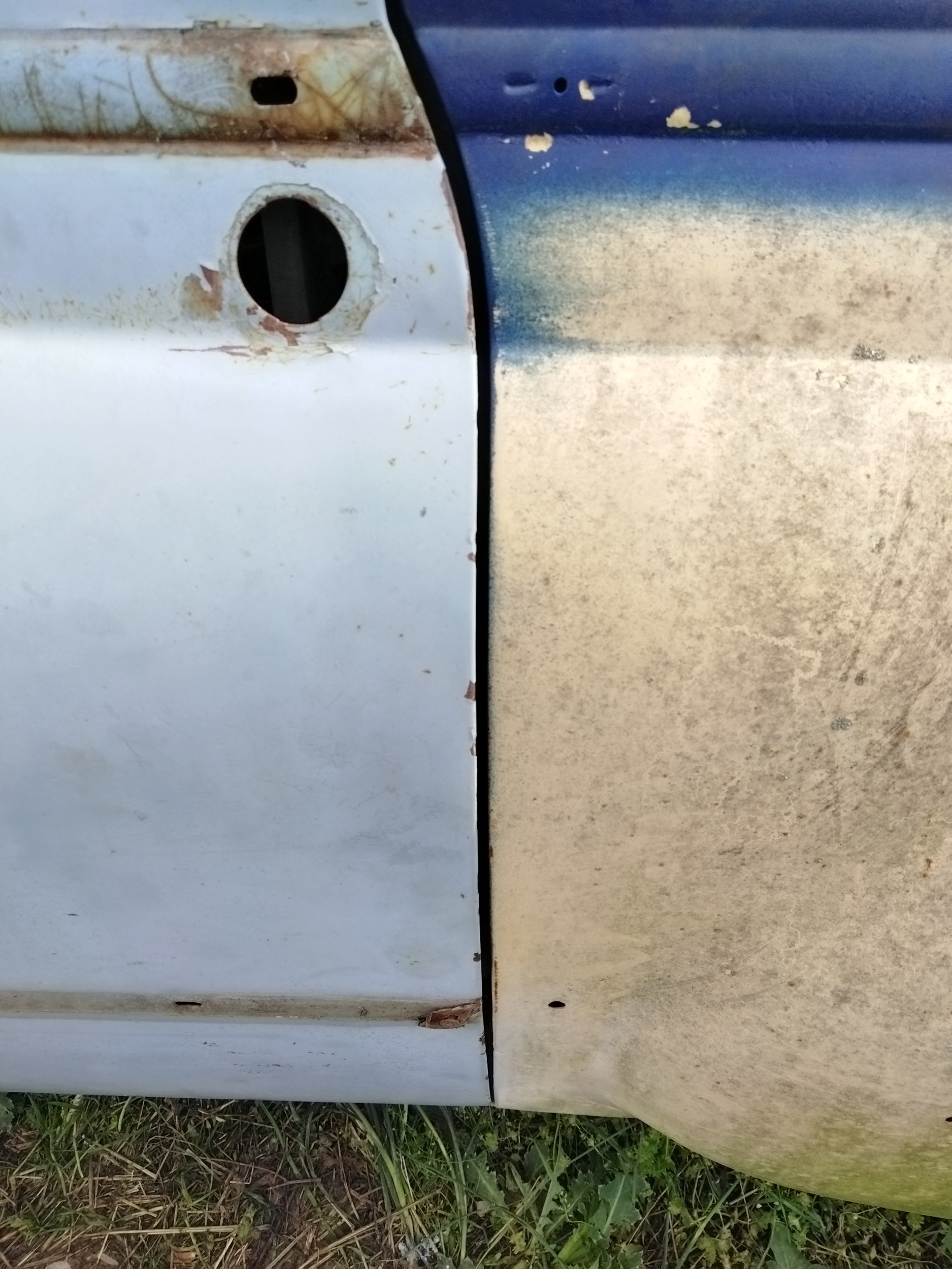

  7. So messing around with the door I managed to get a decent gap. Not perfect perfect but it's close enough I'm happy. Also took the trim off. And while I was in it I got to thinking. All the window channels and felts were in good shape on the doors. And honestly by the time I'm focusing on actual side gl*** I'll want to put in new channels. So I took them out with the intent on t******* down and using in my 53. IMG_20250429_162826_HDR.jpg IMG_20250429_162829_HDR.jpg

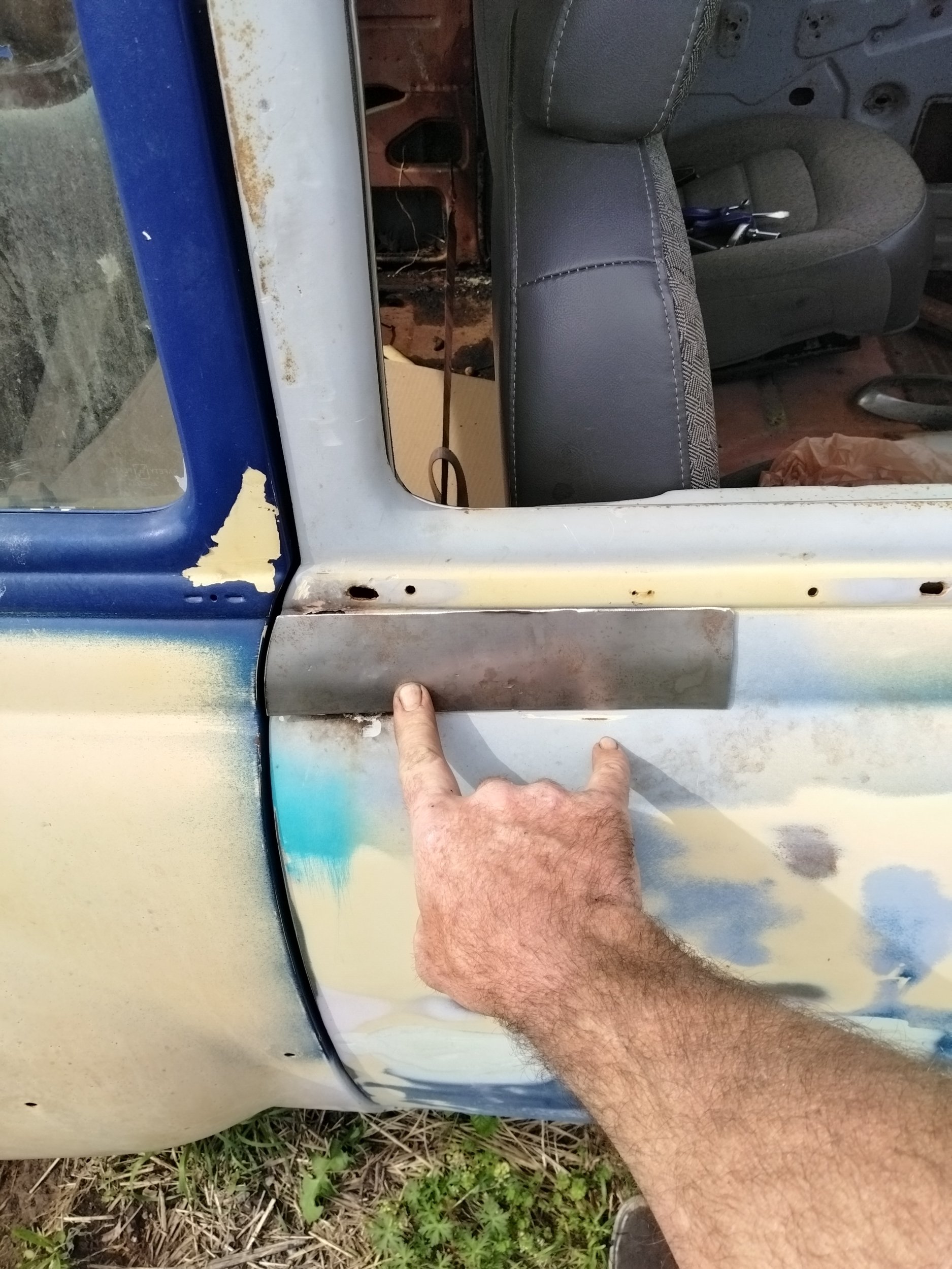

  8. Also the door handle patch/filler I made ended up being dead on. Masked out the b pillar patch too. IMG_20250429_162317_HDR.jpg

    Did you hammer that out of flat or is is off a p***enger door? Video wasn’t 100% clear but sure looks like it aught fit well!
    chryslerfan55 and The Chevy Pope like this.
  10. It's the top section of the rear of a p***enger door. The 54 210 @fastcar1953 started building to replace this car he ended up chopping the top on. When I received delivery of this car there was a bunch of chopped up bits of window frame and garnish moulding left over from when he did the chop. In the pile was a complete b pillar from a p***enger door. This is cut from that. Actually came up with the idea while making a video not long after the car was delivered lol
