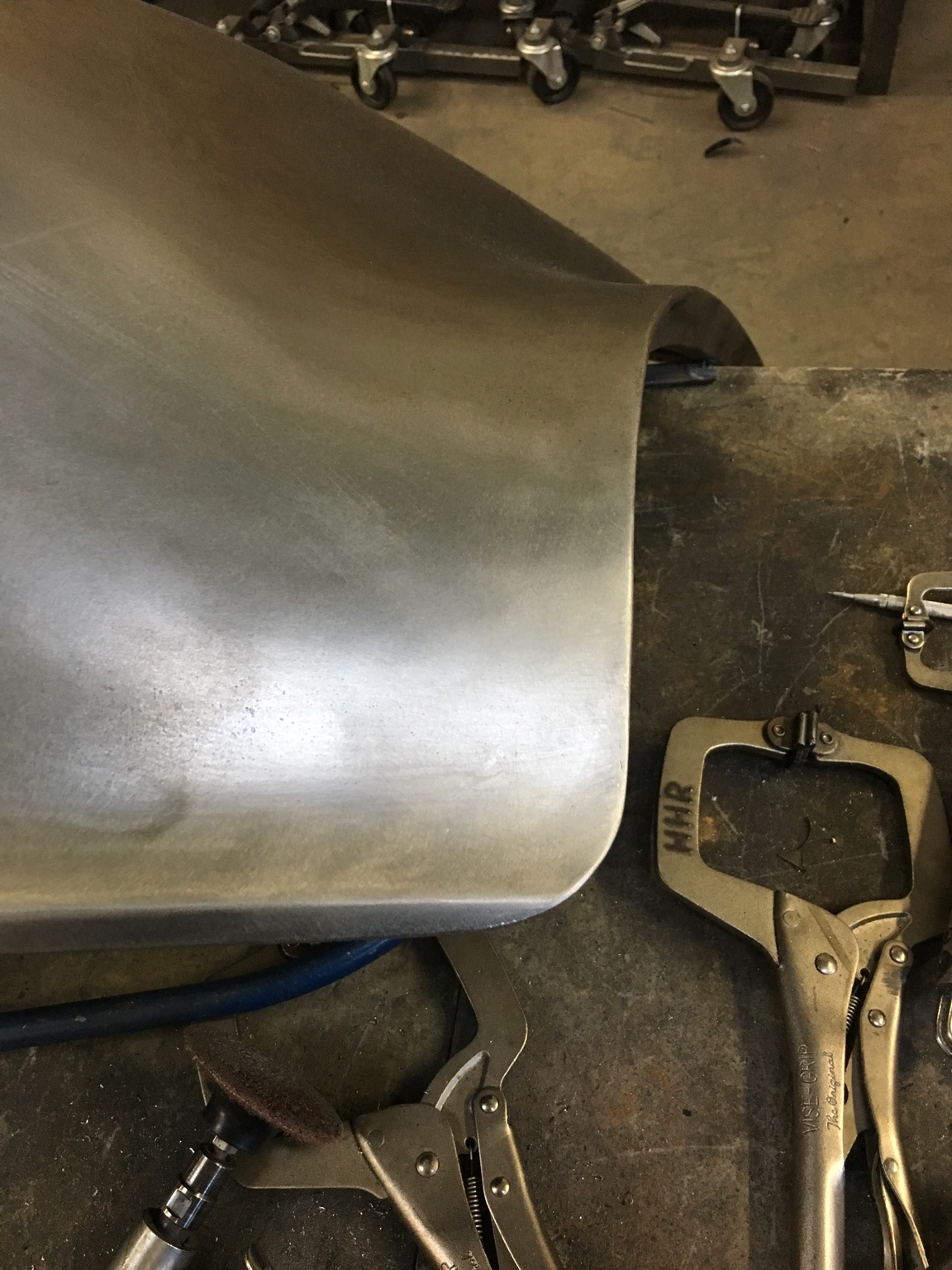

    I finally made a little progress on the 'ol poor '54. I'm going to have to move it soon, so I decided to to get the front sheet metal work wrapped up so I can bolt it back on. Then my goal will be to take care of a few other sheet metal issues, and get it back on the road.
    I finally wrapped up my my headlights, at least for the time being. There is still a little bit of tuneup I want to do, but in the interest of getting the car on the road, I'm going to move on and fine tune it later on.
    So the next step is the hood. Time to peak and one piece the hood, then round the corners.
    So, I fit and clecoed in the front peak. After much deliberation, I decided to go with a peak that fades out like the stock piece instead of running it the length of the hood.

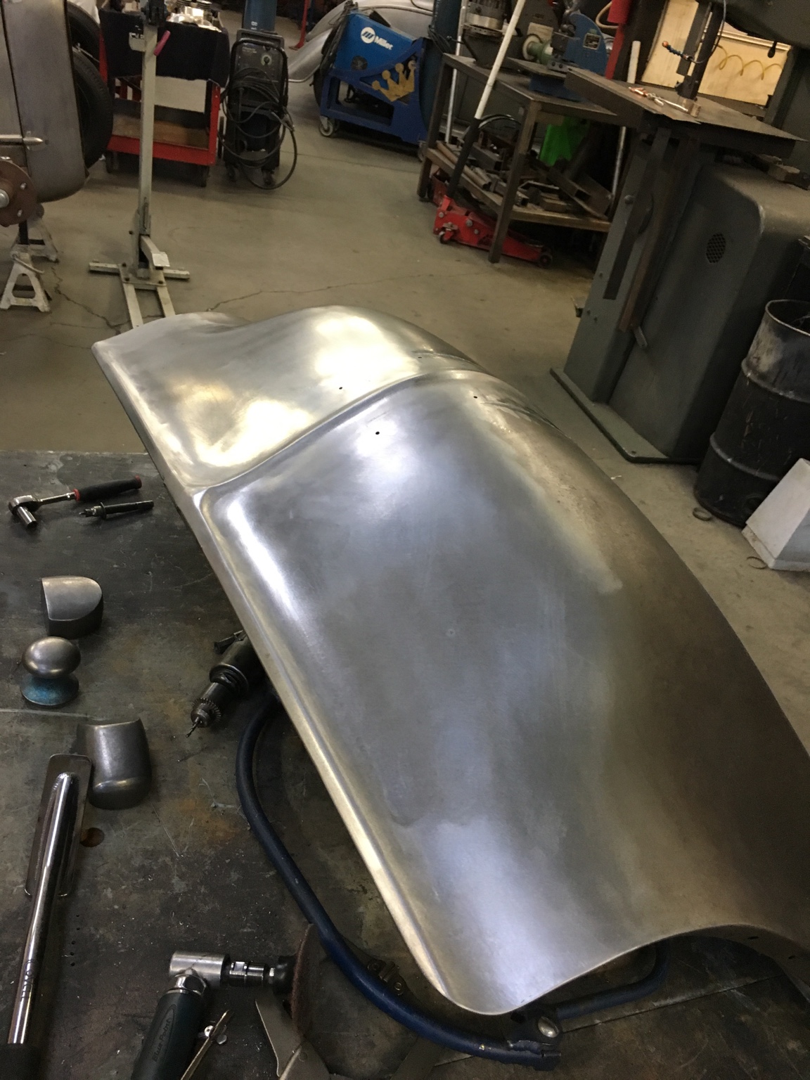

    Today I got the peak fit and tacked in, and got the top piece made and clecoed in.

    I got a bit more time in on the hood after work today.
    One of my friends at work gave me the idea to make a little radius detail at the end of the peak on the front of the hood. I thought it was a great idea so I went for it.
    I made a patch for the front that included these radii, and the flange under the front of the hood.
    It took longer then I expected it to to get the patch right, but I think the effort was worth it. I think it gives the peak a much more finished look.
    It still needs a little fine tuning, and I'll probably get to that tomorrow. Then I can finish the rest of the peak patch, then get rid of the holes and welds seen in the above photo.

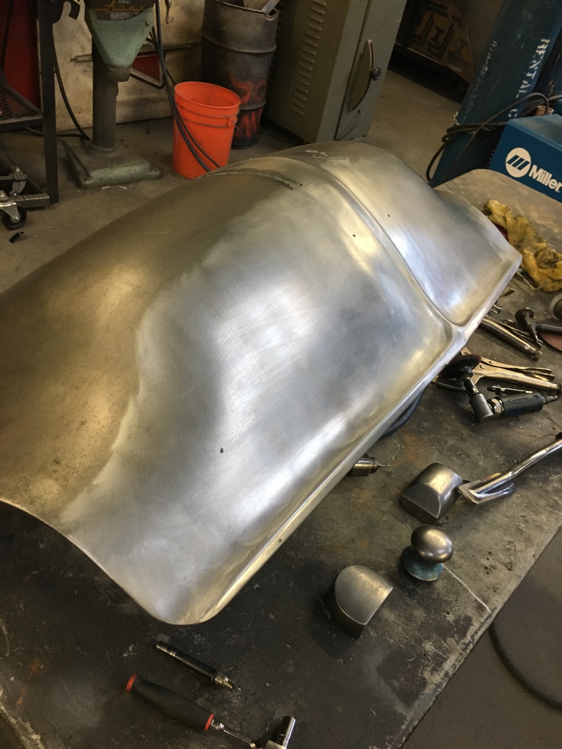

    Put in some more time on the hood today. Since I'm not going to be able to get the hood done before I have to move the car like I wanted to, I decided to concentrate on the front of the hood, and I'll do the top after the move.
    I cut out the welds seen in the last post and filled that an the holes from the last post. Rounded the hood corners, then welded up the peak patch. I began hammering and finishing the welds, and got up to about the center of the curve on the hood before I decided it was quitting time.
    I still need to ****m and smooth out this whole front area. I'll probably do that after removing the rest of the welds that are there and before doing the hood top.

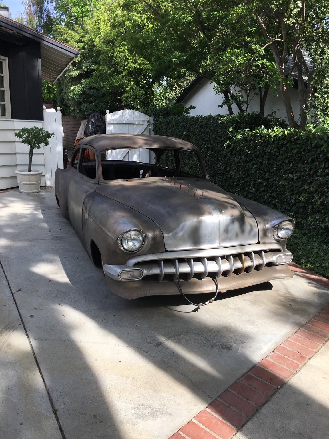

    The car said goodbye to what's now the old shop today.
    And it's now at its new resting place at my parents place.
    Now that tax season is over and the car is back here, my old man should be able to lend a hand with it, and hopefully this and the T can see the road again soon.
    I'm happy with how the front end is coming together. I think it's going to look great once I do the fender side of those rounded hood corners.
