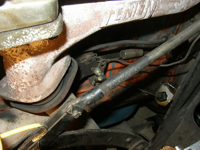

    I used an adapter from langdons stovebolt and after installing it in the car I'm having some trouble figuring out the throttle linkage and tv cable. I have a 2x1offy intake with steel tube headers and there is not a whole lot of room.I know the stock rod wont work for the accelerator pedal but if I use a cable where can I mount it??? I was wondering if any of you guys had a picture of how you set it up This is a pretty common trans swap so someone has felt my pain.......

  3. these are the only pics i got....but it's using a fenton, not a tube header, stock rod slightly bent and i've used my Ellis 2x1 and now a offy 3x1 with out problems, just gotta tweak the stock rod a little
