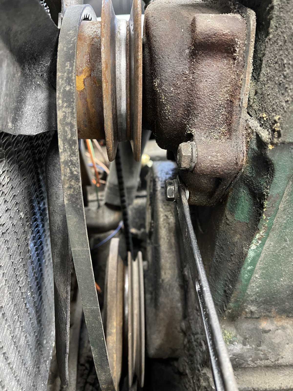

    Hi all as the title states, I need some advice. Have my 39 Chevy sedan project. Came with a 54 235 ci in it. Needs cleaned but starts after a little work.
    Sometime along the way, the water pump may have been replaced without worrying about pulley alignment. The pump pulley sits about 1/2” forward of the crank pulley. See the attached pic.
    I have been searching and I do not think this is a long pump shaft vs short. Does anyone know if the pulley can be pressed on a bit further on these? The car was a stalled project. I am in uncharted territory with old Chevys, but love the puzzle
    thanks!

    Looks like 39 pump pulley (wide grove) vs a 54 pump pulley (narrow grove) is the issue at hand.
    Then again been a long while so I don't remember if pulley is pressed on? If so, then you have an early water pump on a later engine.

    Kinda looks to me the mis-alignment could be from the alternator?
    Take the fan off an use a straight edge across pulleys.
    It also (if possible) doesn’t look like you could move the pully back without hitting the pump housing.

    For sure your alternator is out of alignment and you need a wide belt and a wide belt pulley for the alternator

    Thanks for the quick responses. The alternator is one I had kicking around and is just mocked up. I will slide the belt off and pull the alternator so I can post a better picture. I think the crank pulley is 3/8 but will measure and post back. More to come!

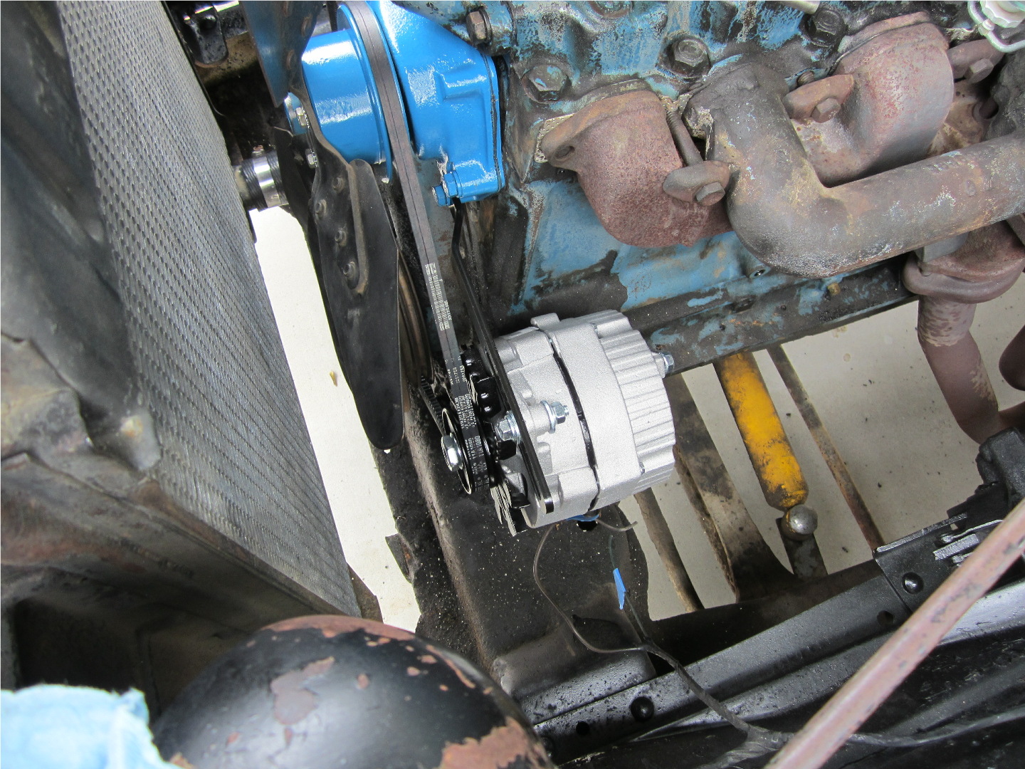

    Ok here are some cleaner pics. The water pump pulley is off (forward) of the crank pulley. The water pump pulley is much wider than the crank pulley. The crank looks to be a 3/8. A 3/8 belt fits the groove well. Thoughts?
    anyway thanks for your help! Jeff

    I did, and they both look like they are set further back from the one on the car. But the good news is, it isn't the alternator. Maybe all it needs is a different pully, or because the pump wasn't engine green, a new pump and problem solved.

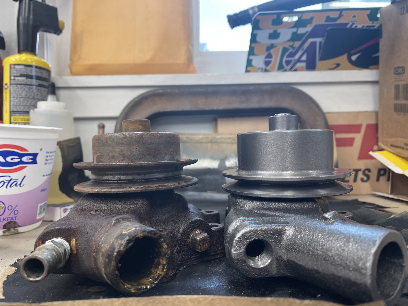

    I ordered up a 54 3/8 water pump...should be here Thursday of next week. I will let you all know what it looks like!

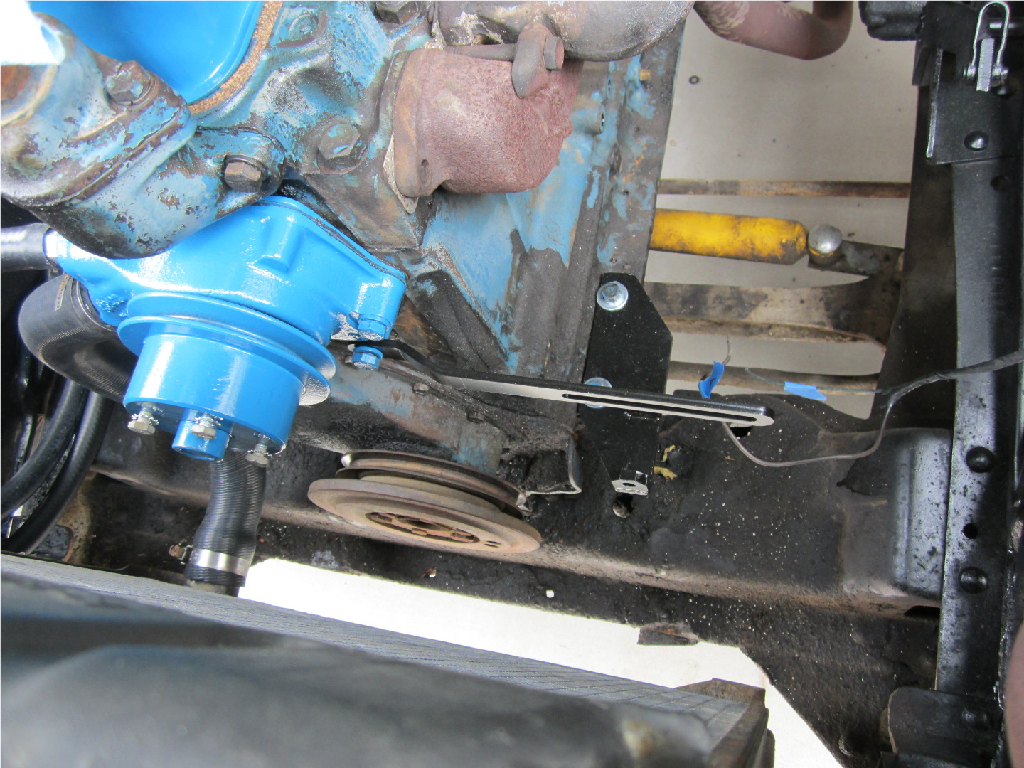

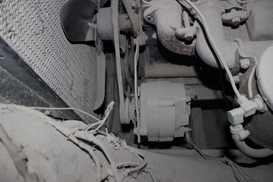

    It looks like your top alternator bracket has a bend in it, I’d assume to match the lower pivot point that spaces it out about a 1/2 inch?

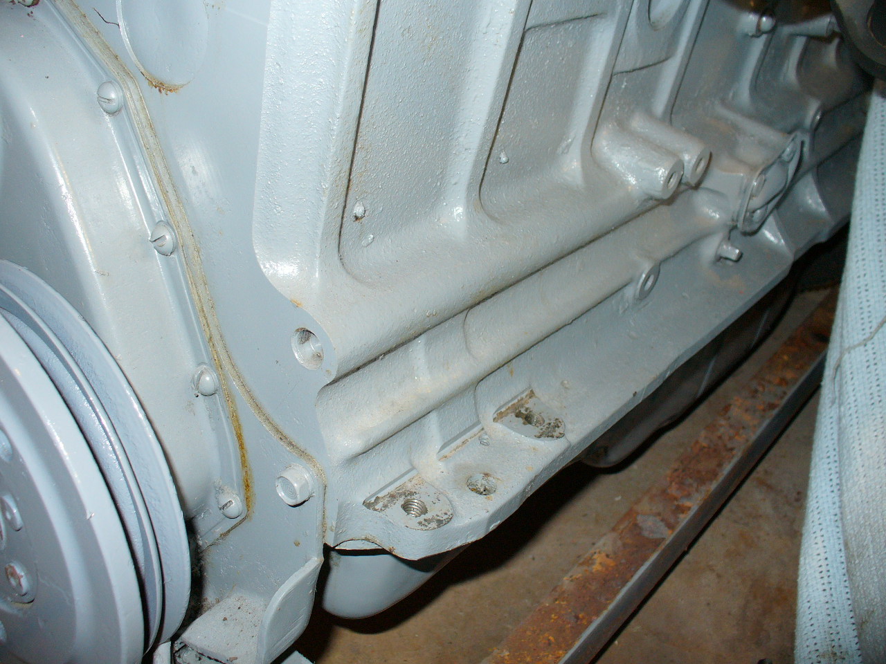

  27. It does. The lower mount and upper mount was a conversion kit. The older motor ('54 and below) mounted by the oil pan and the newer ('55 and above) mounted on the side of the block.
    37-54
    55-62
    Cosmo49 and Budget36 like this.
  28. But that's just one style of brackets, I've seen others. As long as it lines up, is adjustable and is strong.

    Hi all, thanks again. Wanted to bring this to a close. The 54 water pump worked as thought. Here is a pic showing the difference. I thought I took one installed but can’t see it. But the attached shows how different the alignment is which worked well on the motor.
