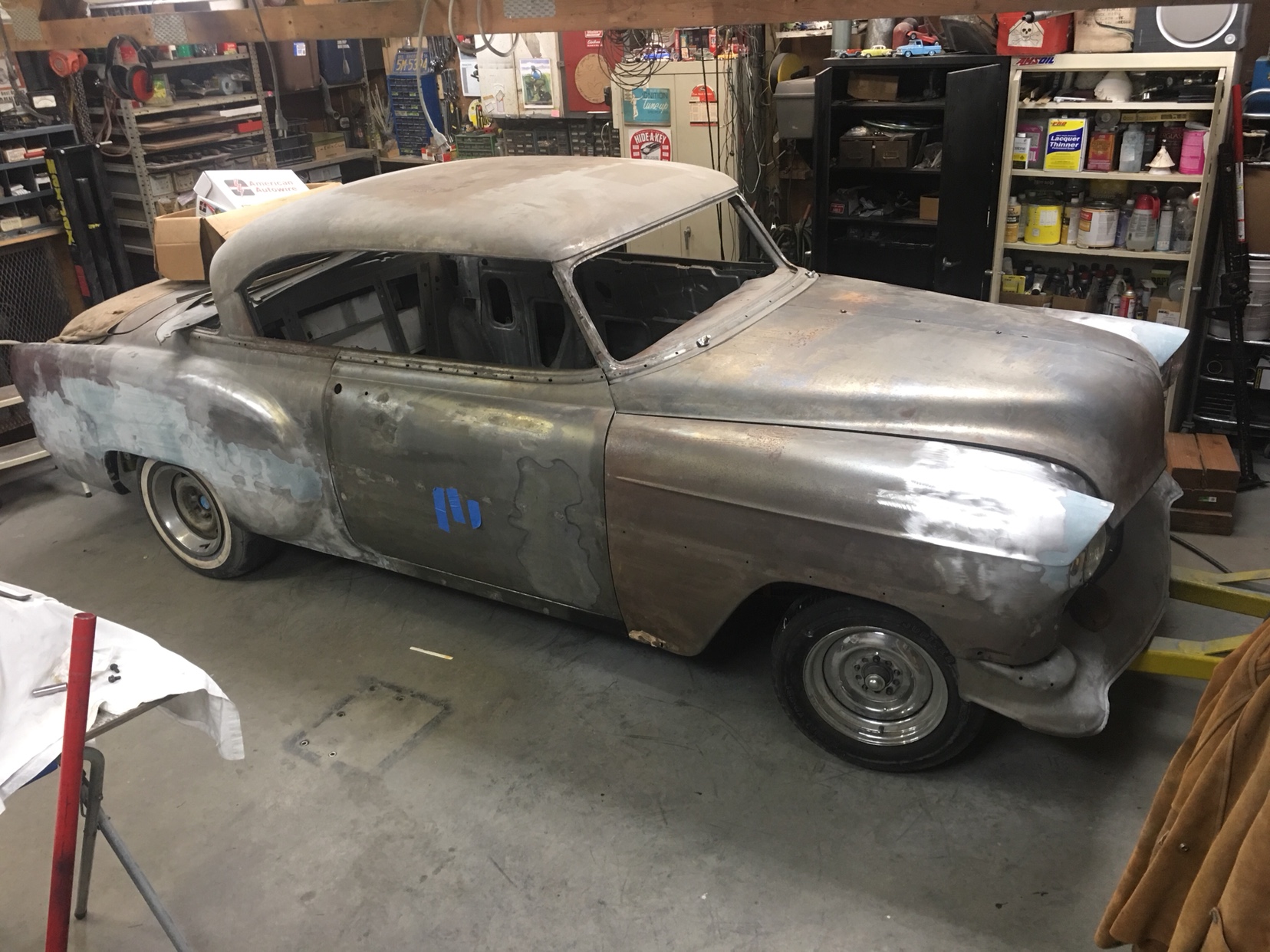

    [​IMG][​IMG]
    Pulled the transmission to put a shifter relocation kit in. My shoulders were bothering me and I don’t have a transmission jack. Made this rope sling to catch the transmission after sliding it out. Worked better than I thought it would. Was easy to pay out some line and lower it far enough to get it out on my belly. Figure I will use a few small ratchet straps in series to lift it back up in there to slide it back in.
    Once I got it out and apart, I decided to do a few upgrades to it.
    Waiting on parts.

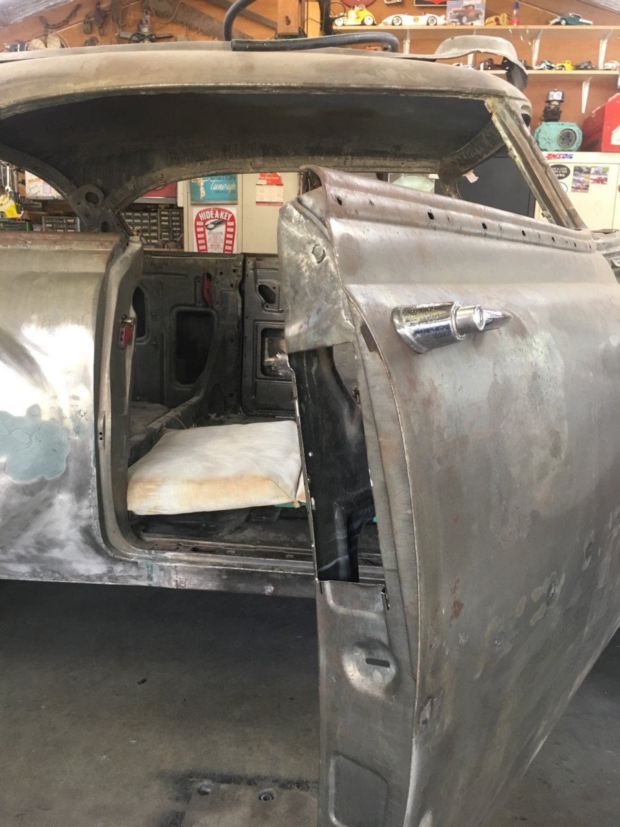

    Hung and aligned the doors so I can start putting the bear claw latches in tomorrow.
    Got the narrowed differential back in and the wheels and tires fit perfectly! Took them off and stowed them for now and put these rollers back on.

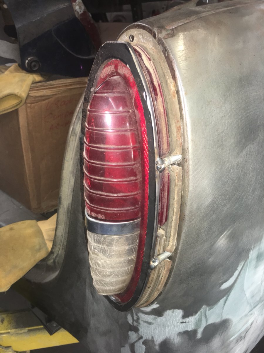

  7. Early Ironman
    Joined: Feb 1, 2016
    Posts: 553
    Early Ironman
    Nice gift from the company I work for after they s****ped one of the boats.
    Gave me a couple blowers from the boats spare parts cabinet![emoji3]
    Bowtie Coupe and chryslerfan55 like this.
  8. 'Mo
    Joined: Sep 26, 2007
    Posts: 7,419
    'Mo
    Lights look great!
    How about some Lee lenses, to finish them off?
    270ci, dan31, Bowtie Coupe and 3 others like this.

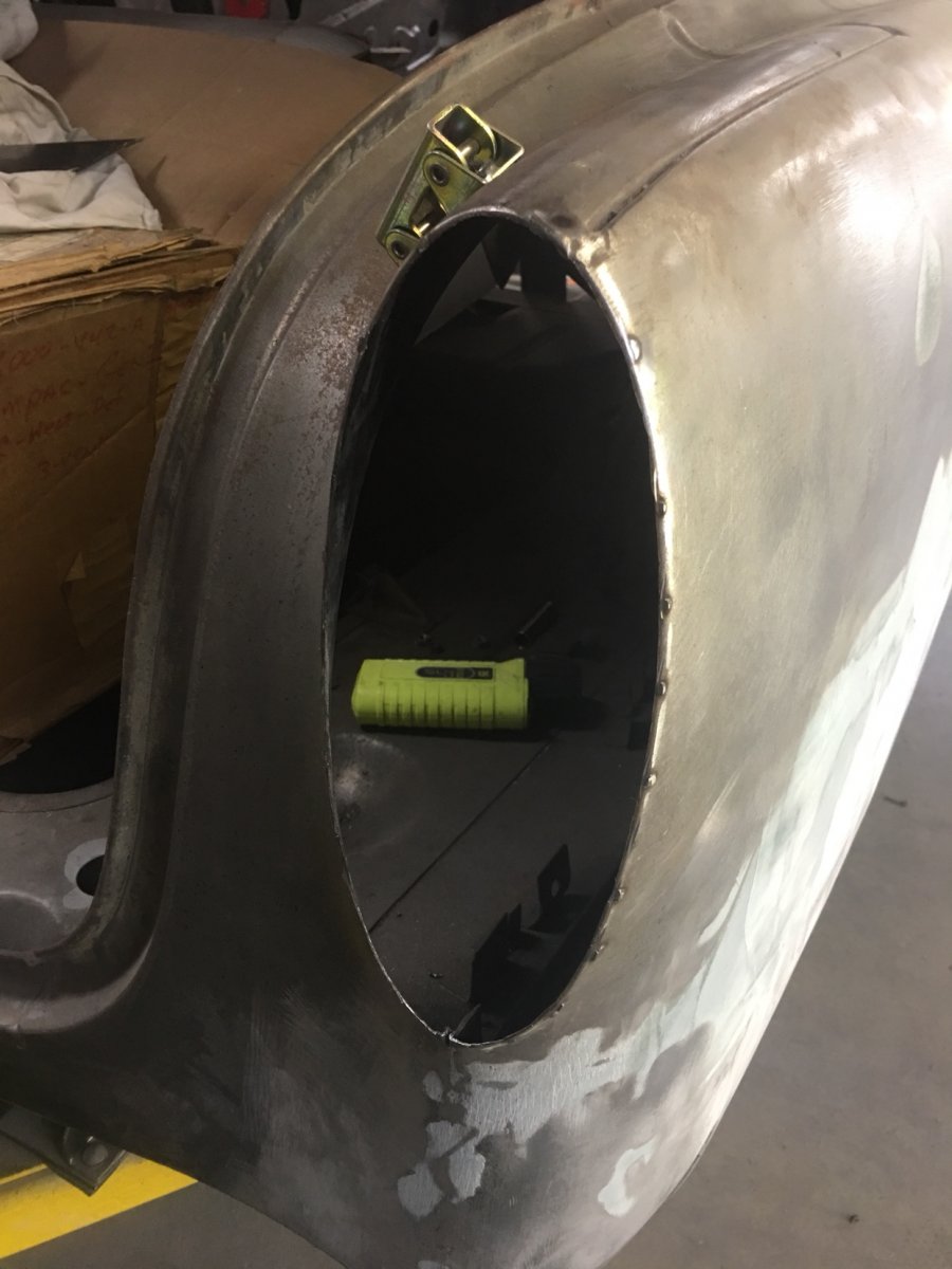

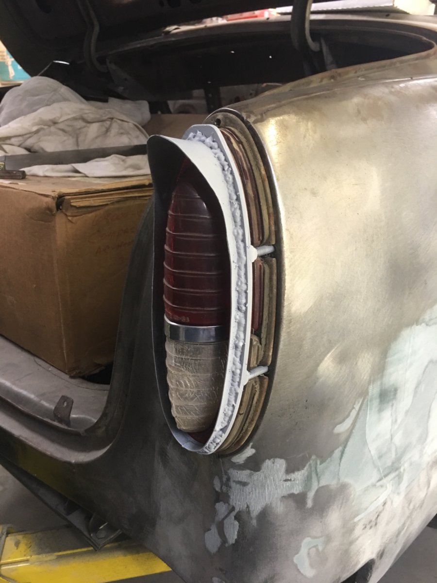

  12. Early Ironman
    Joined: Feb 1, 2016
    Posts: 553
    Early Ironman

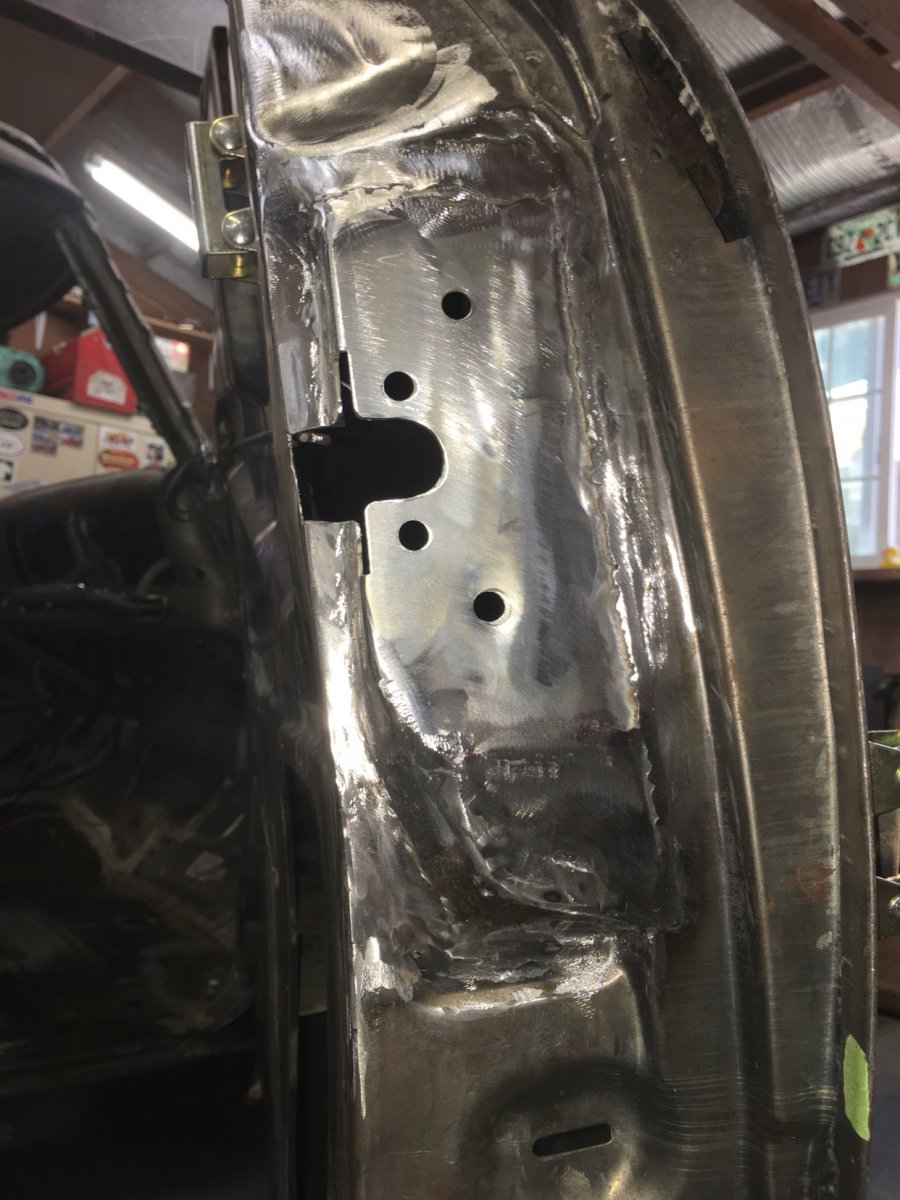

    Not finished with the bear claw door latches yet. But pretty close.
    Decided to not shave the door handles. Because I like the door handles. But there isn’t much real estate to make it work. Got that all sorted out though.

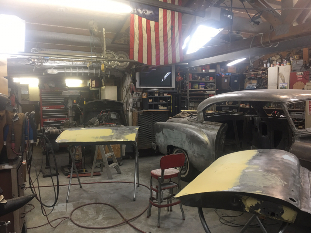

  13. Early Ironman
    Joined: Feb 1, 2016
    Posts: 553
    Early Ironman

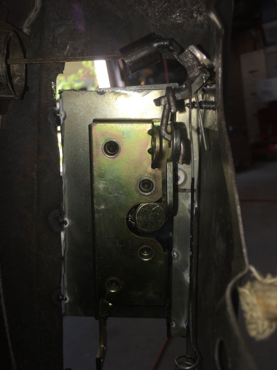

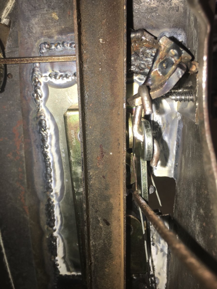

    IMG_5362.JPG IMG_5363.JPG IMG_5364.JPG IMG_5365.JPG IMG_5370.JPG IMG_5367.JPG IMG_5369.JPG IMG_5371.JPG
    Finished fitting the drivers side door latch. Will finish welding it all up tomorrow.

    Looking good. Been wanting to do the bearclaw latches on my 53 HT. Any thoughts on the window track/guide? Is there going to be enough room?
  16. Early Ironman
    Joined: Feb 1, 2016
    Posts: 553
    Early Ironman
    I had the guide in to fit the latches. Can take some more pics with the clearance if you want.
    I am using my original door handles because I like them. But I also don’t trust Chinese door solenoids. Neither of these Auto loc Chinese door latches functioned out of the box. Had to file the catches and bend the tab on the release lever for them to work. Had them too long to be able to return them or I would have.

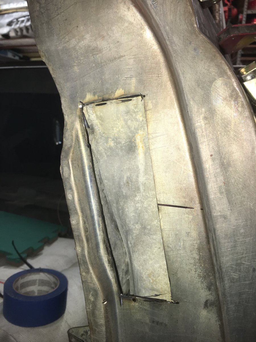

    Knocked out some more metalwork in the fenders yesterday. Thrashing on it to get as much accomplished as I can before heading back offshore.
    Bowtie Coupe and loudbang like this.

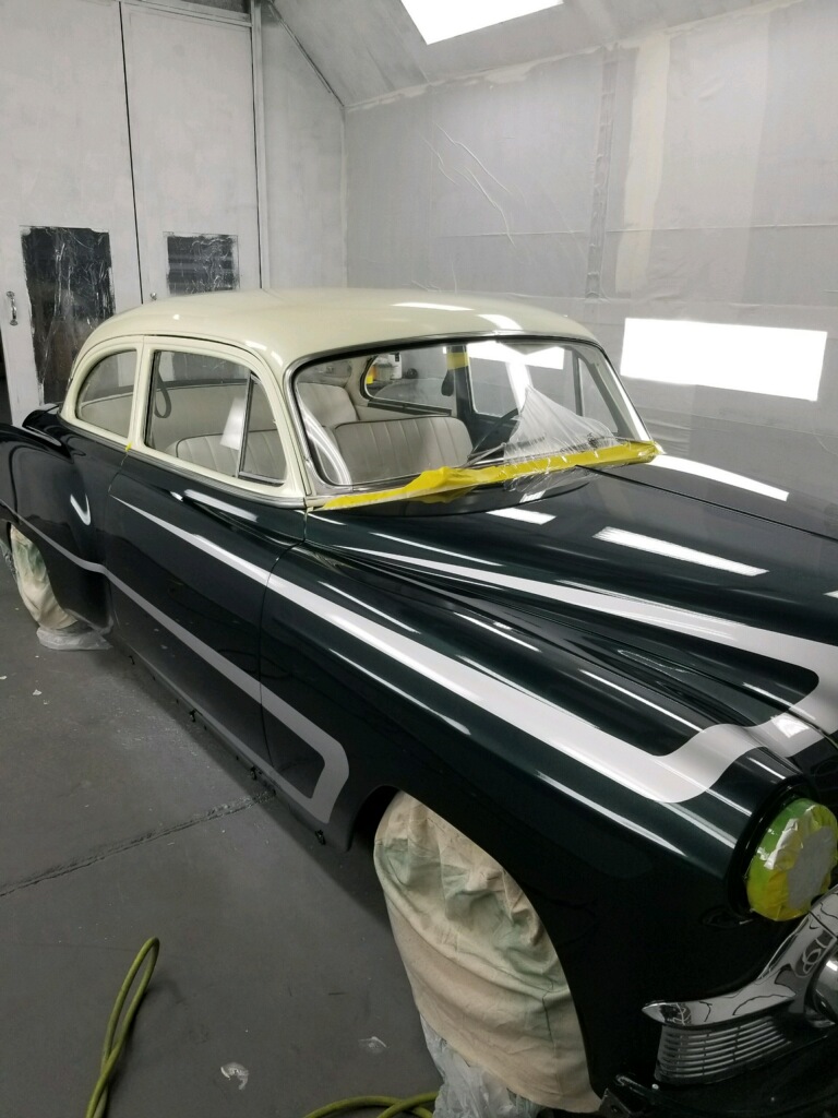

    After shooting the clear.

    Awesome!
    I’m doing similar graphics

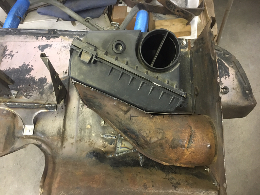

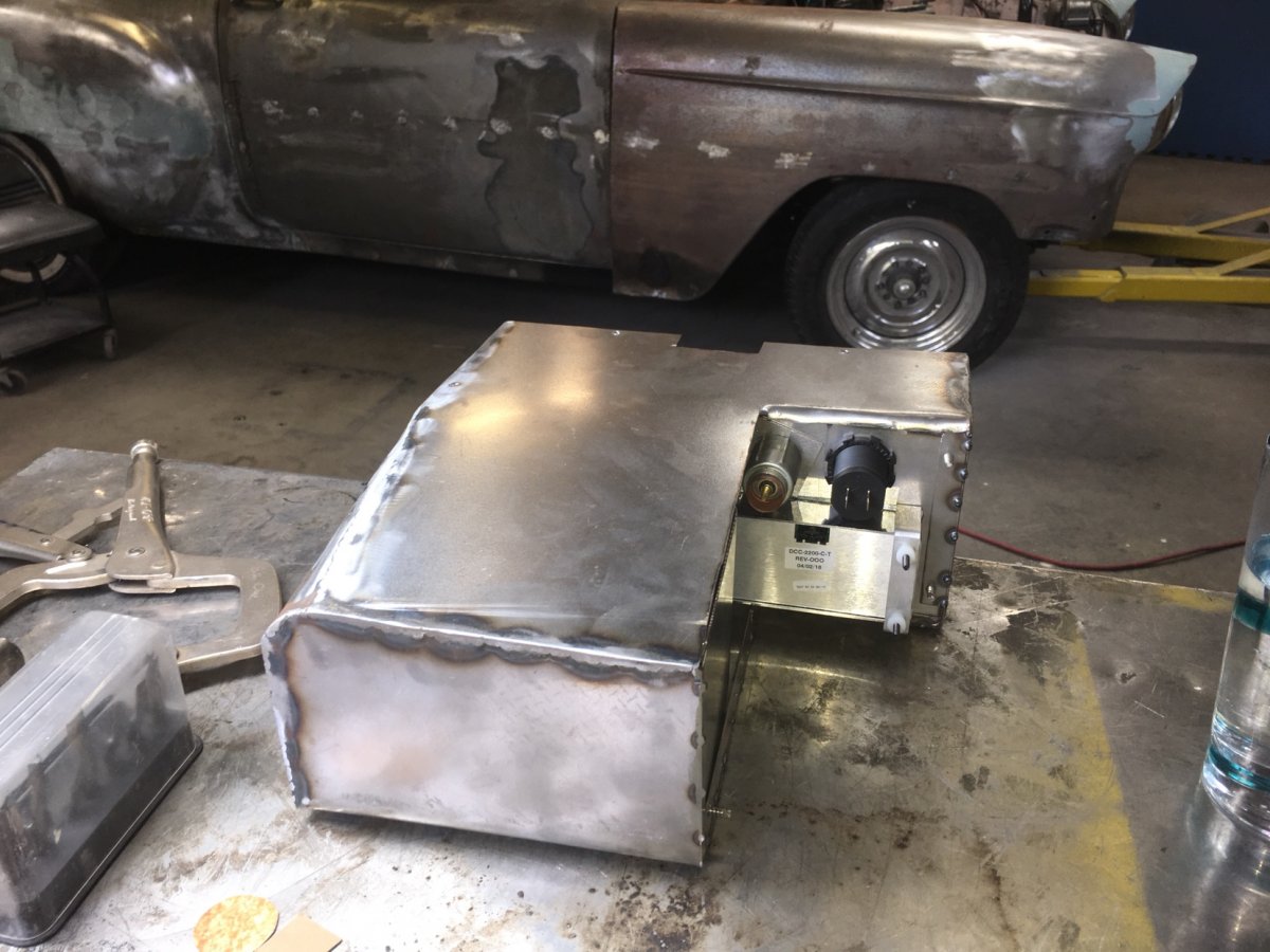

  29. Early Ironman
    Joined: Feb 1, 2016
    Posts: 553
    Early Ironman

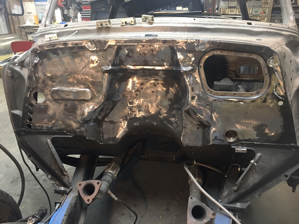

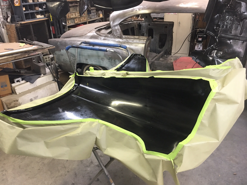

    [​IMG][​IMG][​IMG][​IMG][​IMG][​IMG][​IMG]
    Made a little progress recently.
    Finished the doors, bumper splash guard, cold air intake, washer reservoir bracket, and fender well bedliner. Working on the dash and firewall now. Painting as many small parts as possible to ***emble the front end after the dash and firewall are painted.
