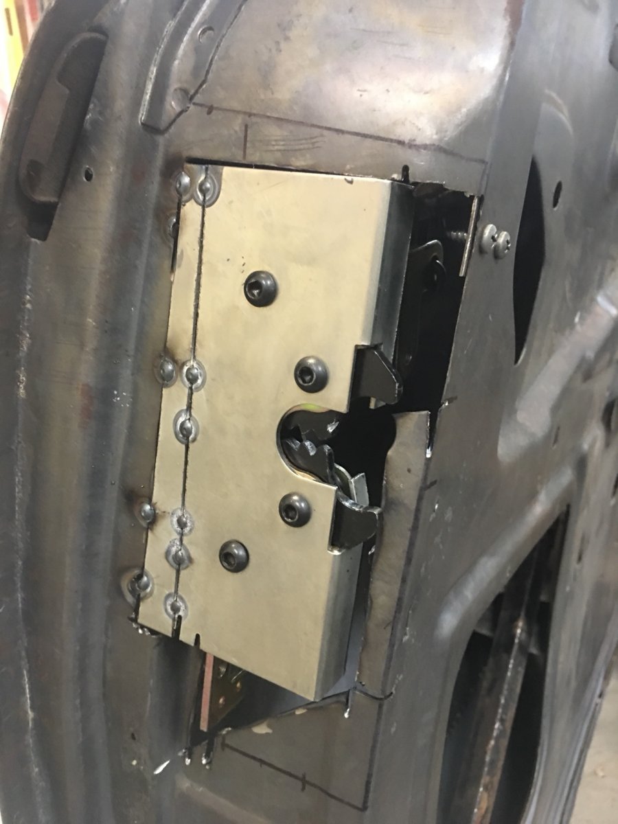

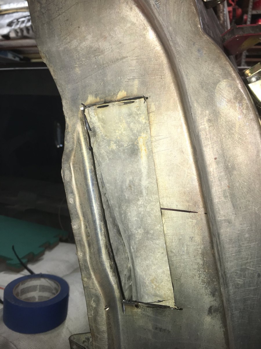

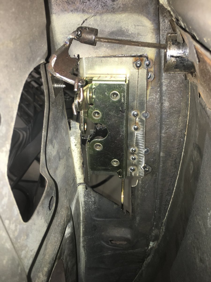

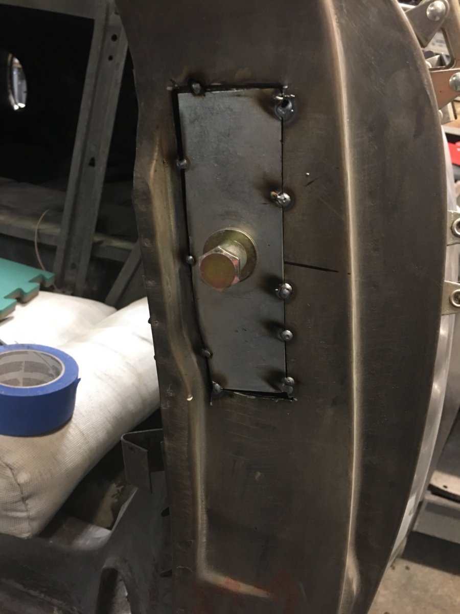

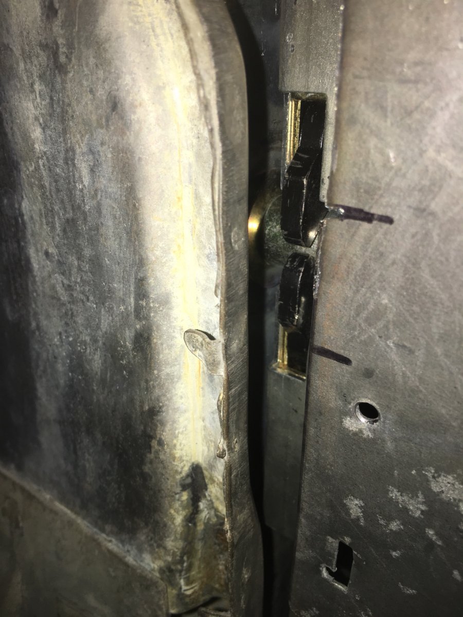

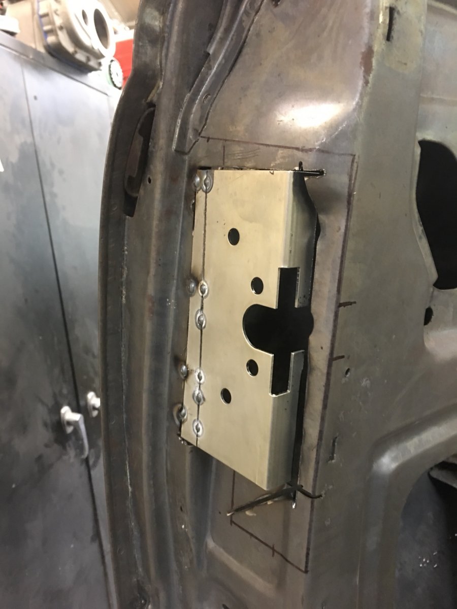

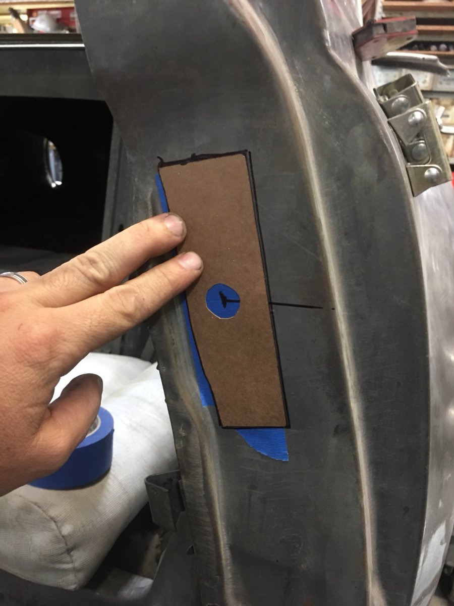

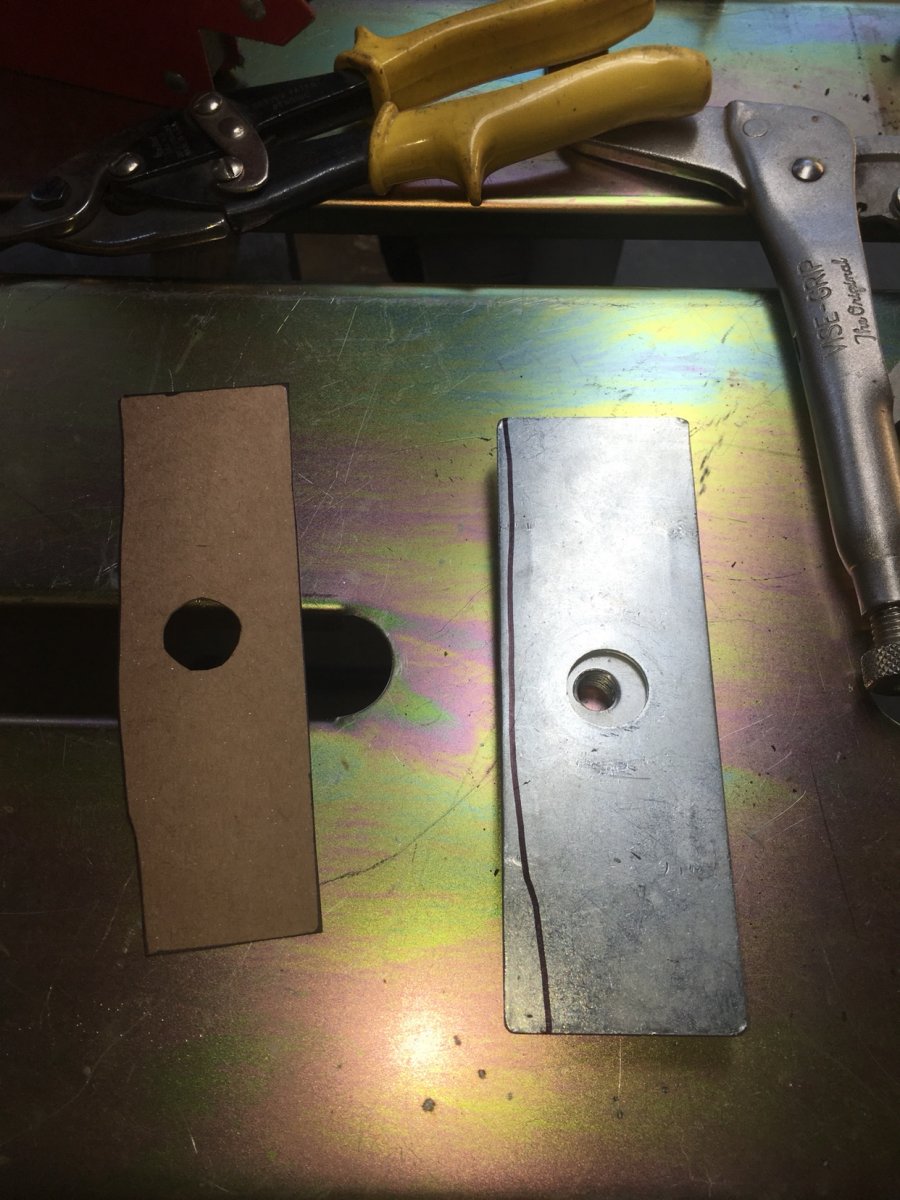

    They are a safer more secure latch than the original.
    Plus, when I had the car acid dipped. The alloy base that the factory latch striker secured to dissolved away. So was pretty much forced to do this instead.
