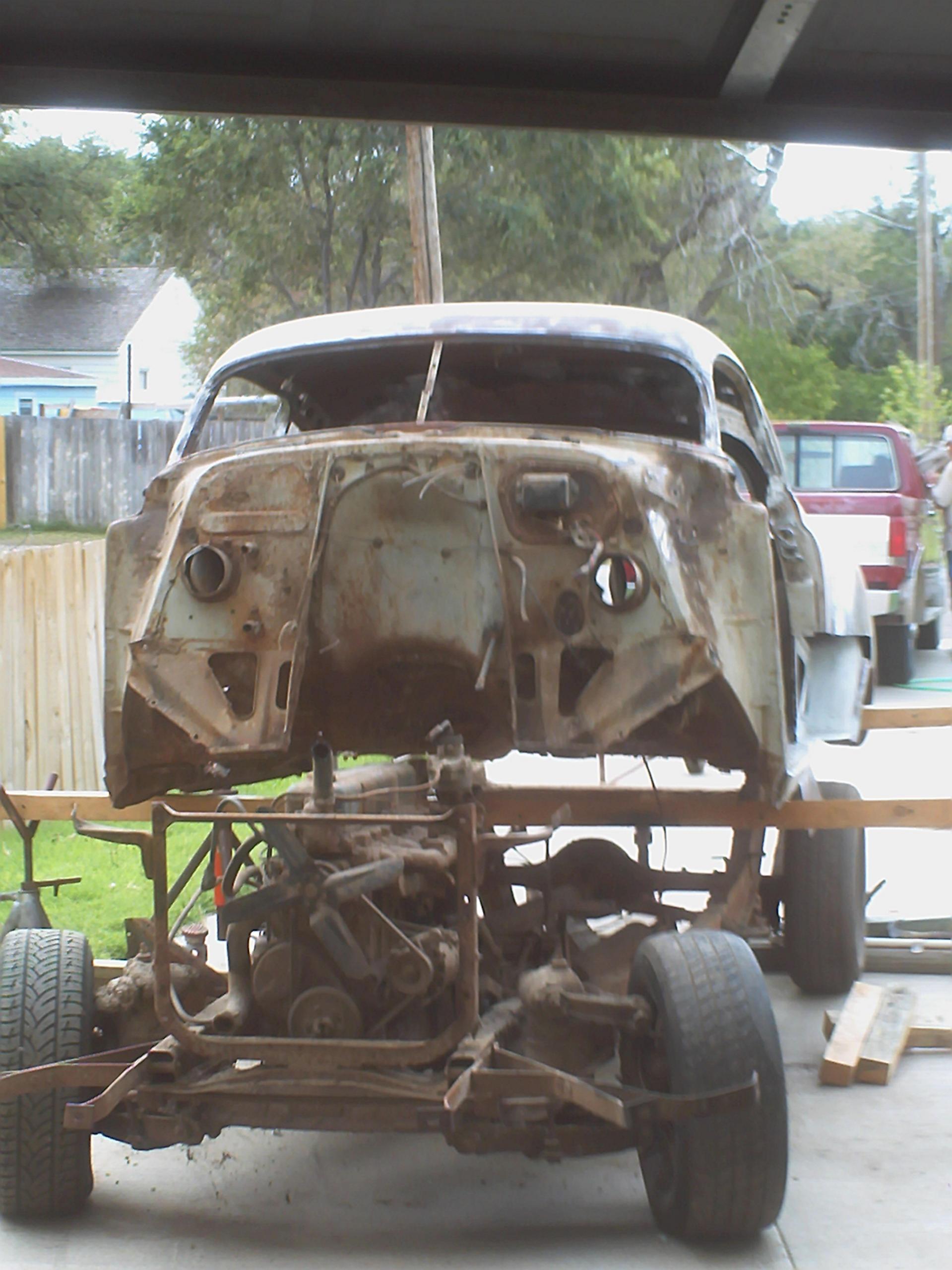

    Ok guys I am taking the body off of my 54. I could use some ideas on what I am getting into on the lift. I was thinking of a couple 4x4's through were the doors was and the back windows, and some friends lifting while we roll the frame out from under it, but then I thought about 4 friends with bad backs:(. Also its in a finished 2 car garage noo trusses above to get to. Was also thinking of an engine hoist....... Let me know what you guys did on yours. I did a search and came up empty handed, so let me know what would be best. (Not really looking for the answer of a car lift, LOL. I'm just a poor white boy with a bad back and big dreams)

    i used engine hoist. lifting at the trunk latch inside of trunk. set up two sawhorses on each side then run 4x4 under body. one in front one in back. lifted body at front using chain wrapped thru front body supports by firewall. deflated rear tires rolled frame out.
  6. I ussd a engine lift also. I put a 4x4 in the triangle shaped openings in the interior sheet metal just behind the b-post. If you look close at this pic you can see the 4x4. I lifted and installed the body by myself. Not that hard. Todd

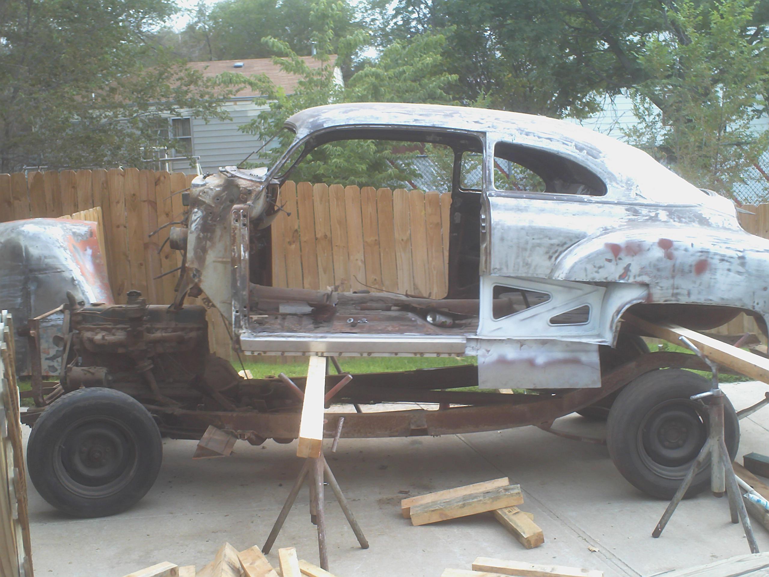

    If you have two floor jacks it's easy. I put a jack on each side just below the front of the front door. There's a ridge that runs along the bottom from front to back on each side. I had a friend help me and each of us took a side with a floor jack. We jacked the front first until we had enough room to slide a 4x4 between the front of the body and the frame. The 4x4 was wider the the width of the wheels and supported on each side with jack stands. Then we went to the back and with the back bumper removed there is a flat space right under the back of the trunk area that is just the size for another 4x4. We put the 4x4 under there and jack it up with the floor jacks and put jack stands under each side. To make it easier to move the frame from under the body, we then put a floor jack under the rear end and jacked it just enough to remove the rear tires. We then lowered the two rear drums onto the small 4 wheel dollies( like the small cheap ones at Harbor Freight). This lowered the frame enough to slide out the front. Hardest part is getting "all" the body bolts off. I think there are 16 to 18 of them if my memory serves me right. Took us less than a hour. Too bad you live in Ohio, I still have the frame I made to roll the body around on. Good Luck. LC

    We used pipe jacks and 4x4s to lift it off the frame then rolled a cart made of 1 inch square tubing under it...thats what its sitting on now
