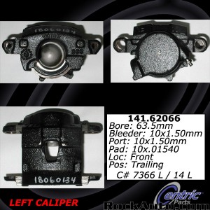

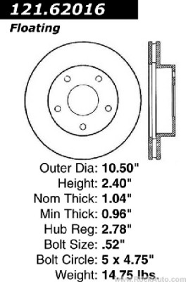

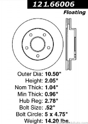

    Caddydaddy, I think I know what you are wanting to accomplish here. I don’t believe there is any hub-in-rotor type rotor that is a direct fit to your spindles and uses the same wheel bearings. However I am not a Chevy guy by any means, so I could be wrong.
    This is what I suggest. First separate your new drums from the hubs, you might have to sacrifice the wheel studs in order save both the hubs and your new drums. I would then look for a floating type rotor with the proper bolt pattern. Since it is a Chevy, I ***ume it is 5x4.75. Take a look at 1988 S-10 4x4 pick-up front or (maybe) 1988 Camaro rear rotors. There are probably others that will work. Take a look at Rockauto.com to get an idea of what might work and then order them locally. Make sure they slip over your hubs and install with new studs if necessary.
    For calipers I would use what has become the hotrodder’s standard, GM metrics from a mid-eighties G-body (Monte Carlo). This is where you will need some fabrication skills, or enlist the help of someone who has those skills, to make caliper brackets. This should not be horribly difficult. You can find examples of home built caliper brackets here on the HAMB.
    As for the rest of your questions, all I can say is I am not sure. Rock auto lists the same drum front and rear, but lists different wheel cylinders and brake shoes. The wheel cylinders appear to have a different inlet, whereas the shoes are listed as 11x1¾ rear, and 11x2 front (Chevy 210 series).
    Your early wheels may require a 1/8-1/4” (3-6mm) spacer for them to clear your calipers, but again, I am not certain.
    Hope this helps.
    (pics below, stolen from Rockauto.com)
