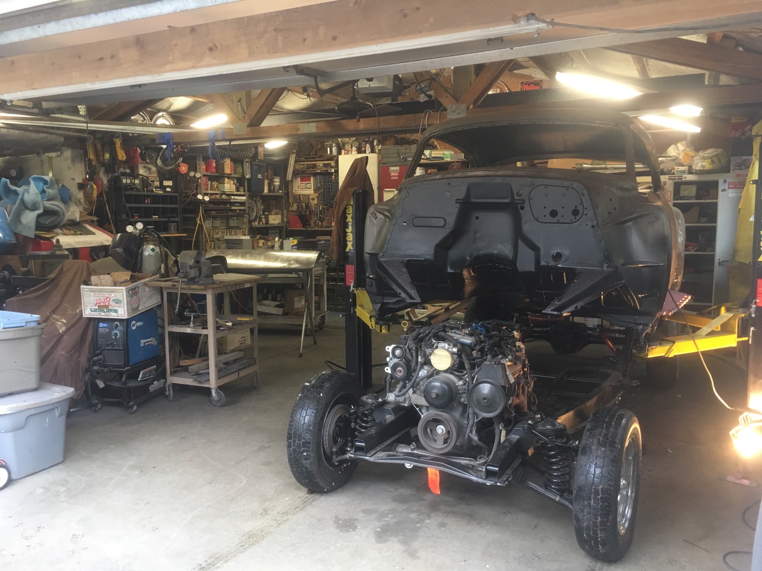

    [​IMG][​IMG][​IMG]
    Slowly getting everything mocked up. Really happy with the amount of room I have behind the engine.
    Just wish these engines were not so damn ugly!

  26. Early Ironman
    Joined: Feb 1, 2016
    Posts: 553
    Early Ironman
    Holy moly!
    Now that is one seriously recessed engine!
    Would love to see some more pics of your car.

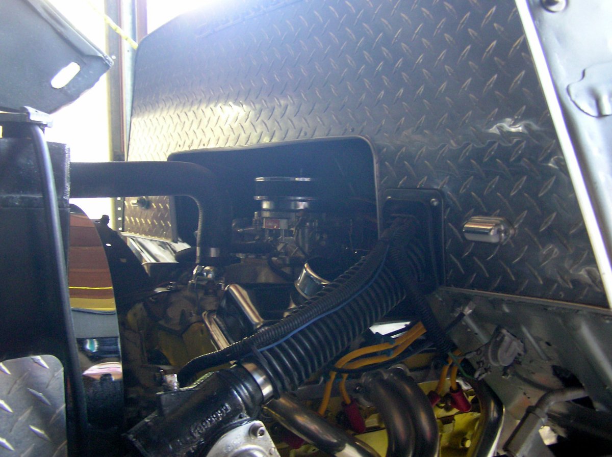

    this is the firewall in our 51 Fleetline. We set the engine back 10 inches and took 9 inches out of the firewall. The recess is made from a Polaris Gas tank that was widened about 6 inches. We used the wrong tail lights so it is not HAMB friendly
    lothiandon1940 and Capt Chap like this.

    That is a clean looking firewall. Good job and great looking project!
    My engine isn't H.A.M.B. Friendly either. But overall, it will look like a 50's custom. So hope they will be kind enough to overlook the untraditional parts of what will appear to be a traditional build.
