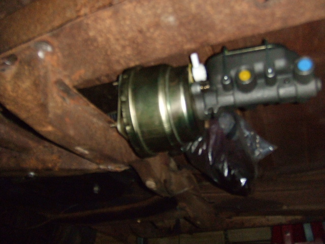

    hey guys, it's been a while since i've posted on here but it's also been a while since i've worked on my car too. This is my first attempt at making a car my own so i'm doing things backasswards i'm sure. Since getting the car a little over a year ago I've put a small block and th-350 in place, with a 8.2 rear end. Changed the master cylinder and added a power booster redid all the brake lines and hoses and have a disk brake conversion kit on the way for the front. The last couple weekend ive decide to try my hand at body work. ive started shaving all the trim and door handles. Which leads me to my questions. There are numerous holes where the trim used to be...what is the best way to get rid of them? most are fairly small and i think should be welded in? the larger ones i figure making little patches to weld in place? Next question is about the back glass. It looks like the trim is wrapped around the glass to me. So how do you get it off? i figure take out the whole window...ok. how do i get the window out? any help is always appreciated.
    I've got pictures for those interested... remember i've never done any of this before though.
