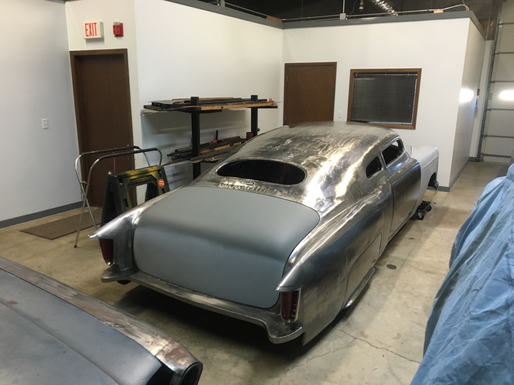

    [​IMG][​IMG]
    A little update on my 54. Getting closer but haven't had much time to work on it. Customer cars have been keeping me busy.

    just stumbled across this thread. That “Photo****it” deal kept me from seeing your original pix. But I like what I see. LEGIT!!! Thx for sharing

    First rate, I'll be sitting in on this one. Love the flow and the head light treatment.

    Beautiful lines great work! What are you using for a rear window frame? Which model Business coupe?

    Thank you! It's a 46 ford rear window.

    That is pretty funny! I told a long time custom car guy I was thinking of using a 46 Ford coupe window and he told me it would never work and it would look like a Plymouth! To make a long story short I am not too far off the mark because that is perfect!
    I purchased a 1954 2 door Chevy like yours a while ago and it was chopped and the first thing I found was there was no lower section on the rear window. The whole car is a wreck and I have been told by more than one car guy to s**** it.. I also have a second frame that I am working on to get the drive line and suspension completed. The chop on your car appears to be more than the 6" that was done to mine. Is that an illusion? Mine will never look as nice as yours but I plan on making it as nice as I can.

    Yeah it's a big chop. It's a 7 1/2 front and 9 inch in back. Thank you! Good luck and if you have any questions feel free to hit me up.

    That is some beautiful work you are accomplishing . There are quite some radical cars out there , but not too many that are radical AND have beautiful proportions like yours. You definitly nailed it.
