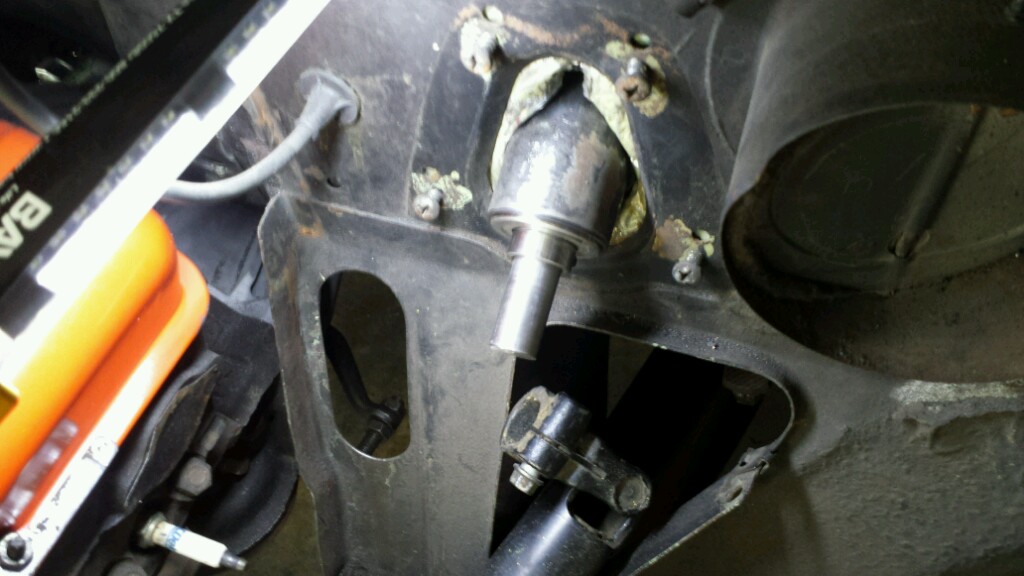

    On my 51 I used this bearing, which is just a bit large for the tube, but I had a muffler shop expand the steering tube just a bit so it was a slight press fit. Photos are from mock up. I think I have about $12 in the whole bearing arrangement. The steering u-joint and collapsable shaft that goes on down to the box is from a Jeep. It was $8.50 at the pick and pull. I had to buy one aftermarket u-joint for the connection to the rack. easy peasy.

    Squirrel, I'm claiming a senior mental lapse... when I measured the tube ID this morning it had changed to 1.5" and Summit has a Ride Tech poly bushing @ 0.750 ID/1.50 OD part #90001085 for $4.00 such a deal!
    thank you, dyno dave

    Hey, thank you for your info & pictures... Did find a Ride Tech poly bushing from Summit for the now correct sizing, 0.750 x 1.50. Thanks again, dyno dave
