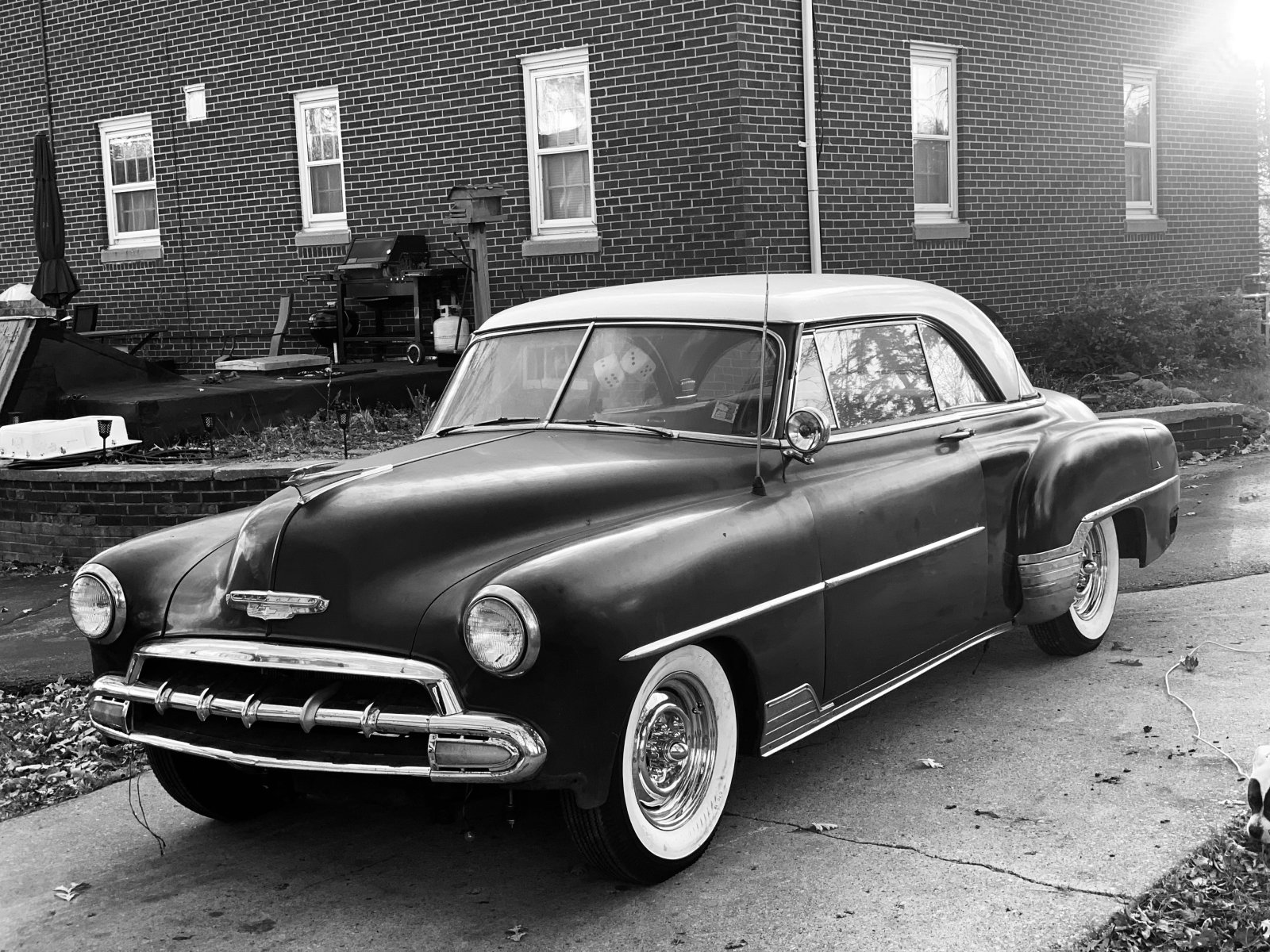

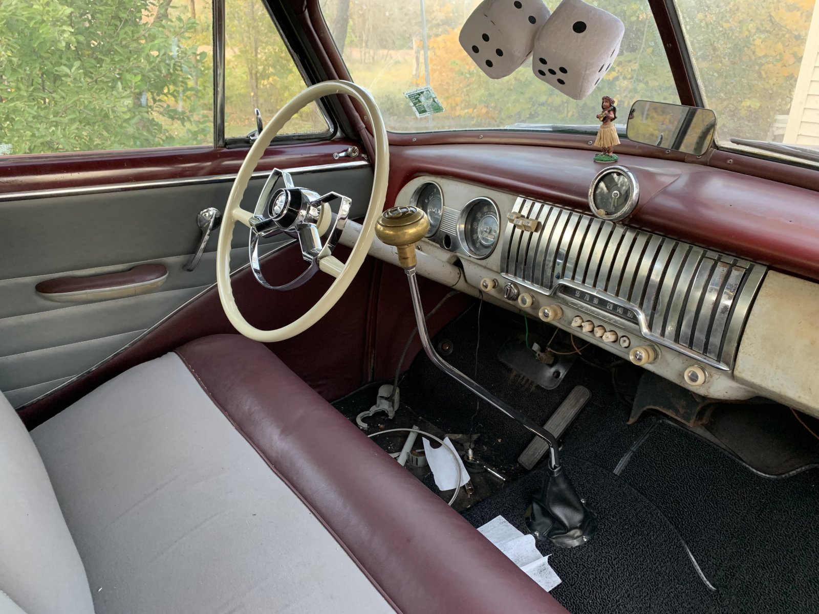

    My 52 current project

  15. Dunno if interested but when I get around to putting the correct front bumper on my 53 I'll have a decent rechromed 49-52 Chevy front bumper to fit that left over

    Thanks I have a new one piece chrome bumper for the front just waiting on my splash pan to be painted
  17. Ah nice. An actually good splash pan for the front is something I still need for my 53. I really dig the look of your car. Really wanna go dual quad on my 53

    I love the way your front end sits. How much did you drop it to get that stance? I'd love my 51 to sit like that in the front and just a touch higher in the back to give it some rake. :)

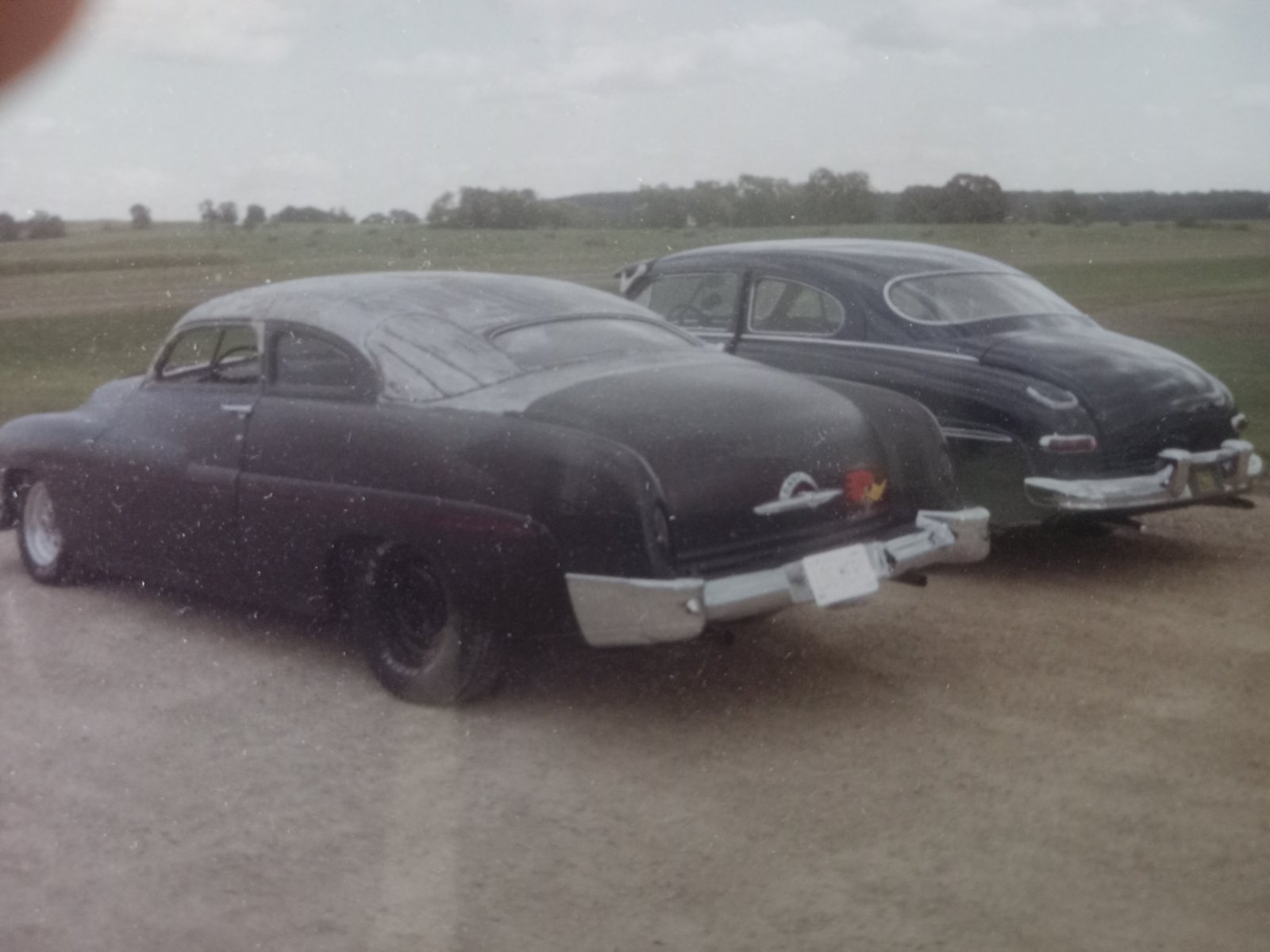

    go on the Photo shop thread and see what they can do. Sadly, I had rear quarters I saved of a 54 hardtop that I parted out 20 years ago for a possible use on something. took them to Jefferson for years and had no takers, finally tossed them last fall. I am just outside of Wisconsin Dells, never fails, you save it for ever and them toss it and then fined a use for it, I actually have 54 chevy Lee custom lenses. frenched into my 51 Merc. 20220817_132245.jpg

    Thanks I think it looks pretty wild also

    I have 3”drop coils with 1/2 coils cut out and 54 Chevy steering arms and uprights the rear are possey springs super sliders

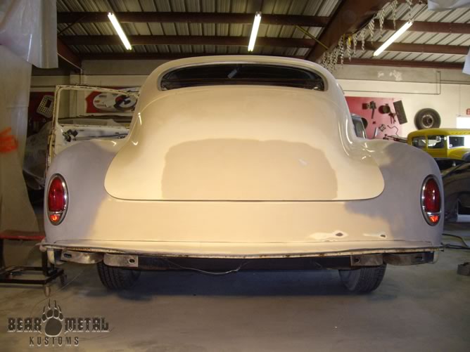

    I’ve posted this else where. We reshaped the rear fenders to match an O/T tail light. A **** load of work but worth it in my humble opinion IMG_2166.jpeg
