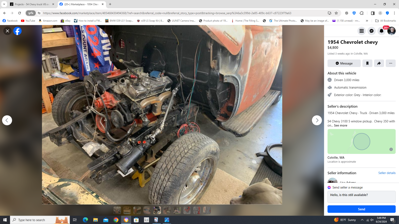

    This is a 54 that a guy 180 miles from me has for sale that has a 350 with a 5 speed installed and has the power steering conversion. Photos are worth a lot of words in this case.
