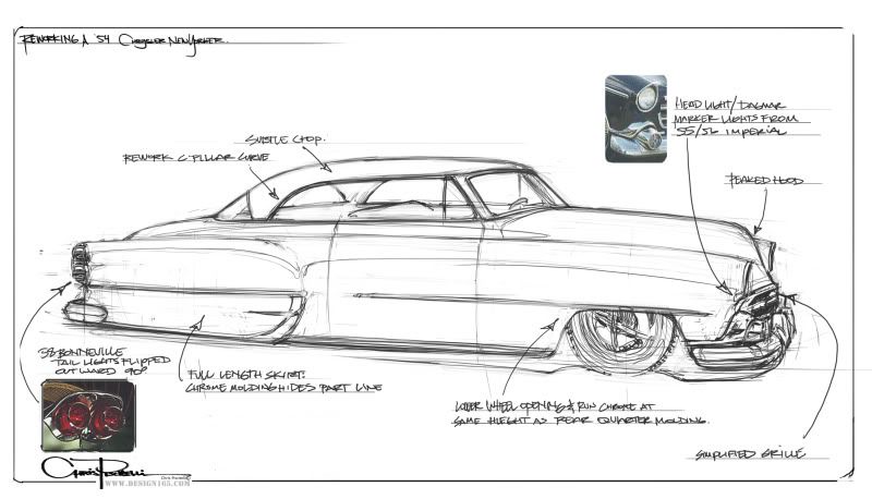

    Sweet car!
    Just incase ya need an adea of what ya could do... ;)
